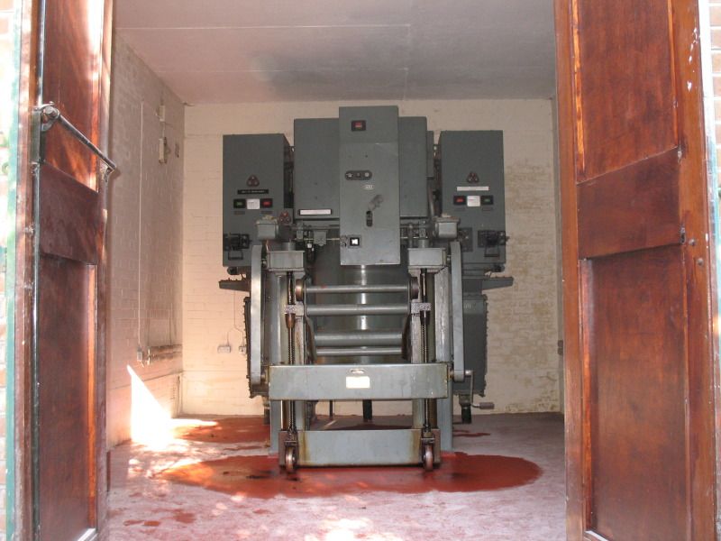

Shame those danger signs spoil the appearance.
In which case couldn't you just change the oil?
With transformers as part of preventative maintenance program, a sample of the oil should be taken and sent away for analysis at set intervals. There are also indicators on the top as a guide to it's state.
Not sure if the same is carried out for oil-filled switchgear ?
Bitumen Compound is still present on a huge part of the network as apart from the last 15 years it was used to insulate/fill all cable joints and boxes....including CT chambers. Busbar chambers have not been insulated in compund for 30 odd years now....Its a messy job to break down and around 20 years ago we were recycling the switchgear so you have to be careful no to toast the bushings, the pic below is on switchgear thats going for scrap so its just a case of heat and patience....
The reason for the repalcement is that the have switching bans on the RING MAIN UNITS, and although its not rust in this case, there is a rust problem on a certain make that is on the network, as you say RUST forms on the underside of the breaker, then drops into the oil, if found like this the rust is treated and the oil replaced....
As for remote contolling the OLD switchgear, all we have is indication on most sites, opening and closing of breakers is still an old fashoined call out system for an engineer.....
Stand outside away from the doors in full protective gear with a rope?
Nope, Nomex overalls stood in front of the gear, HSE is fine with that owing to almost nil incident level!

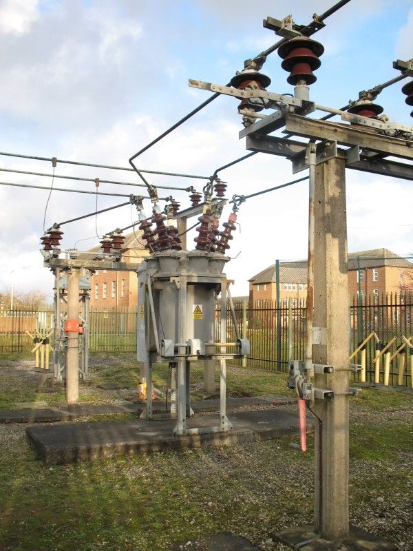

A 33KV Circuit breaker in an open S/S compound.......
And its modern equivalent (actually this one is 20 years old now) but its an SF6 vac 33Kv breaker. We have a cutaway version in our training school which shows the inner workings and the GAP between the two contacts it switches is 5mm compared to an oil filled gap of around 8" or so

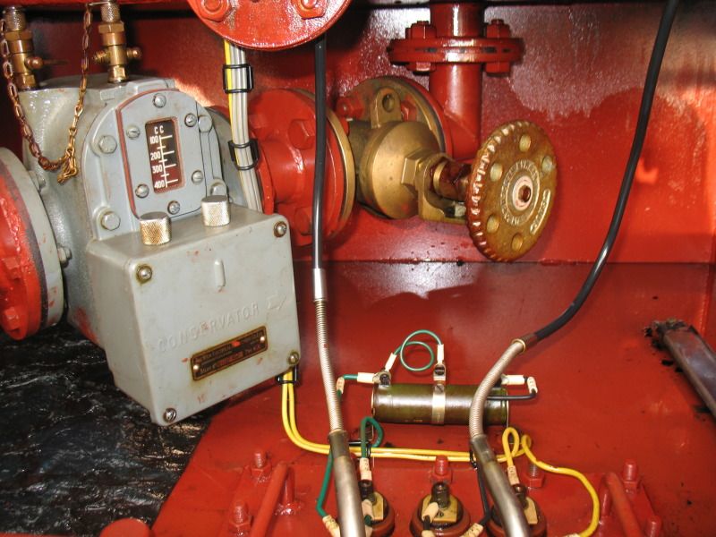

Below is a part of the protection for the 11/33Kv transformer, it senses gases,Low oil level and oil flow, its a Bucholz Valve, and has a two stage system, an alarm stage which flags up as a problem such as a small flow of oil into the transformer from the conservator tank as in a leak, or a full trip for a fault such as an explosion!!!!
