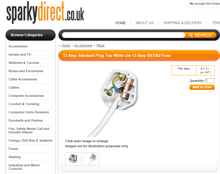

I presume his point was that the product (only the bottom of which was shown in the piccie) was described as a "plug top".
And my point is that just because one can produce photographs where people claim something is a certain thing that does not mean that it is.
