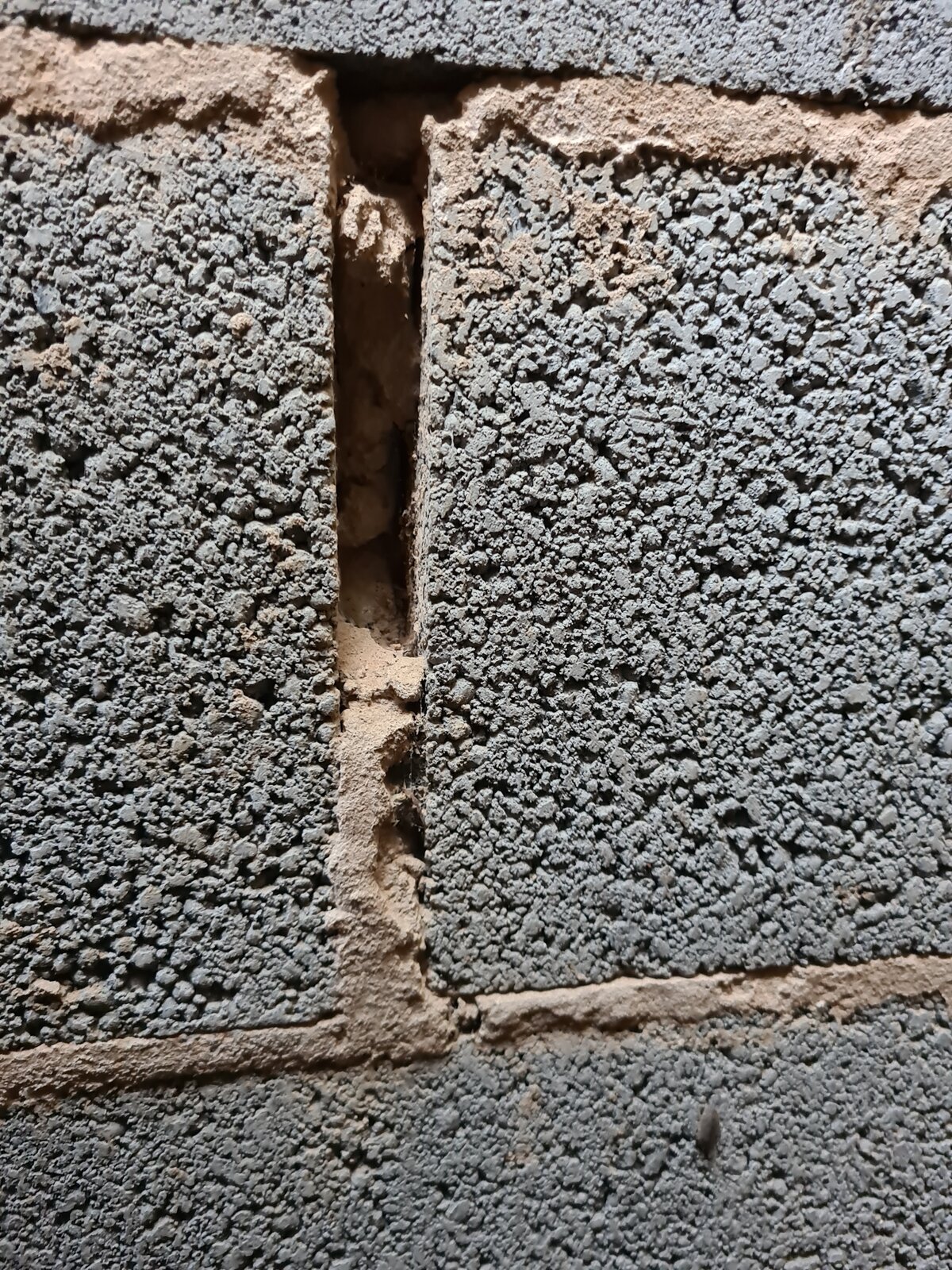

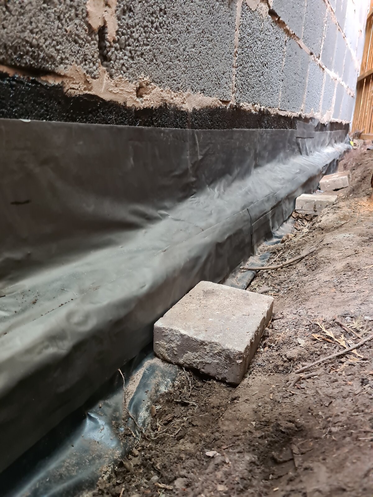

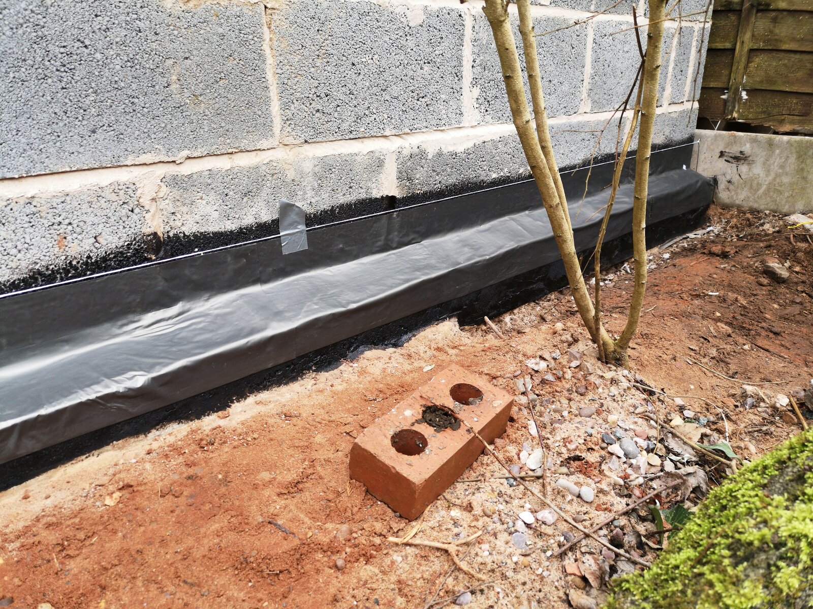

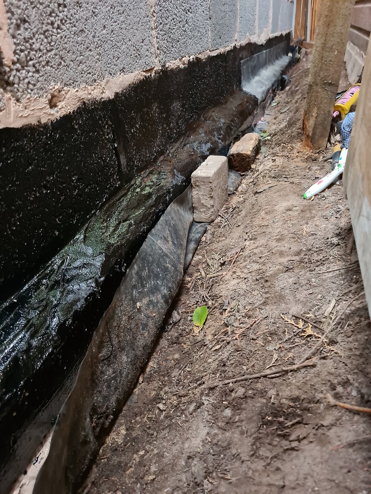

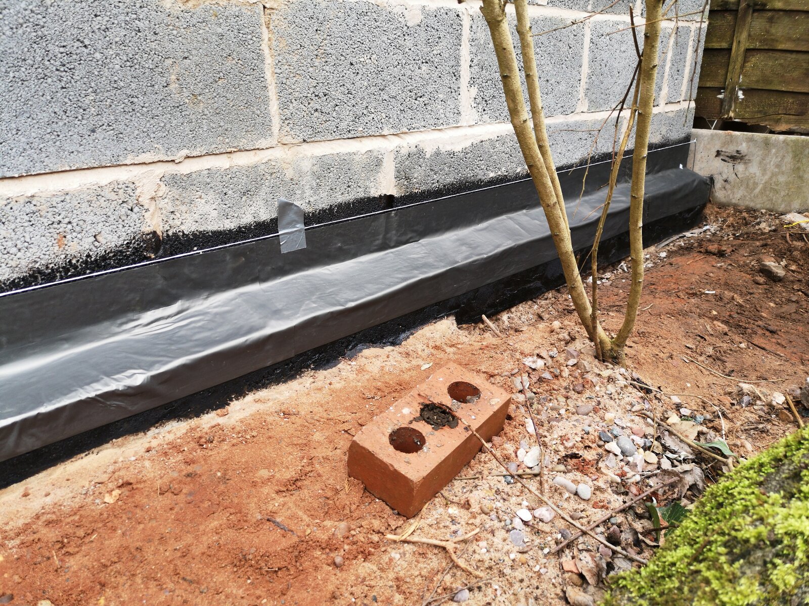

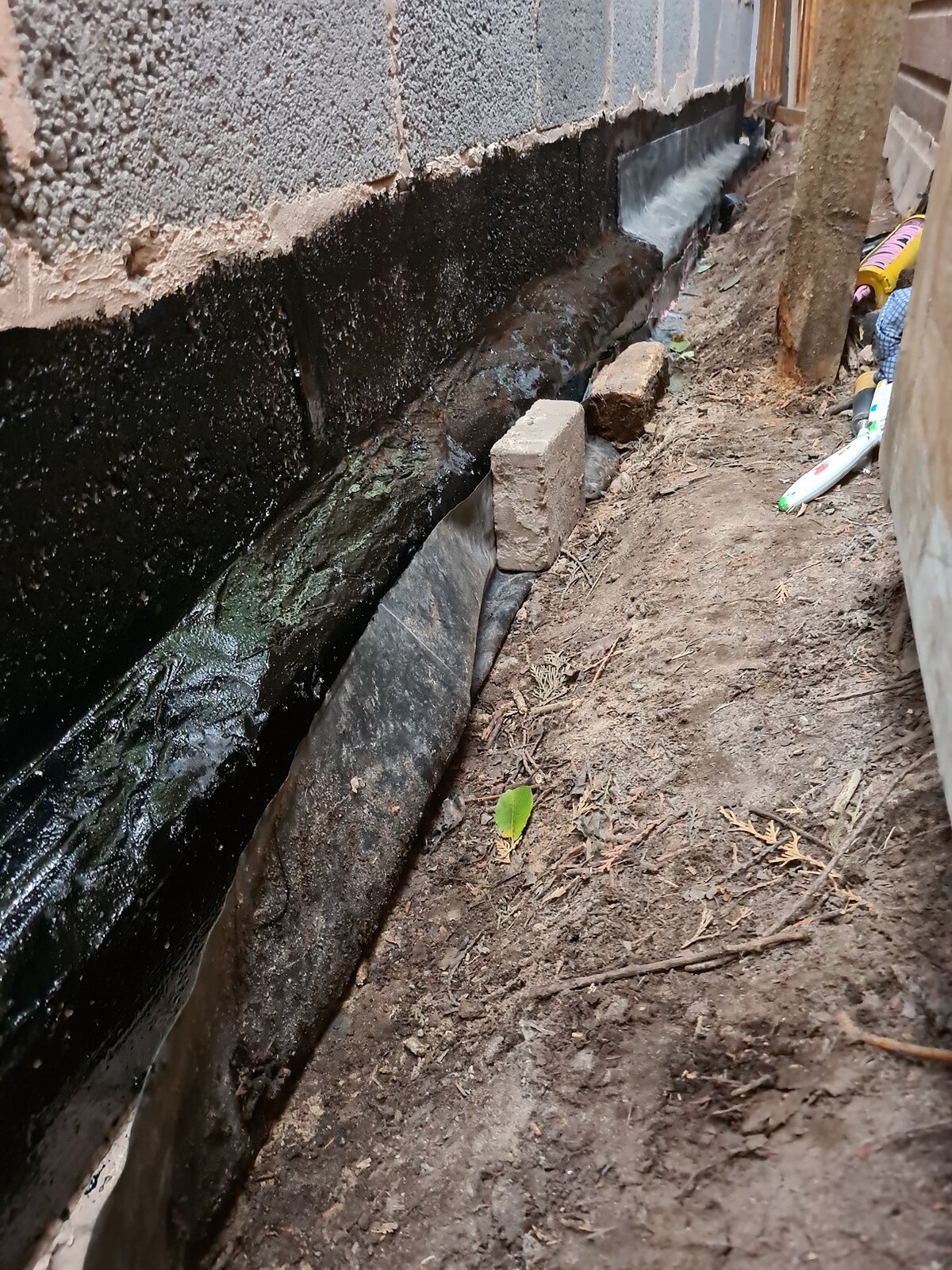

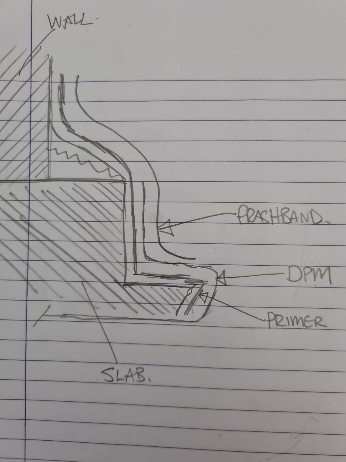

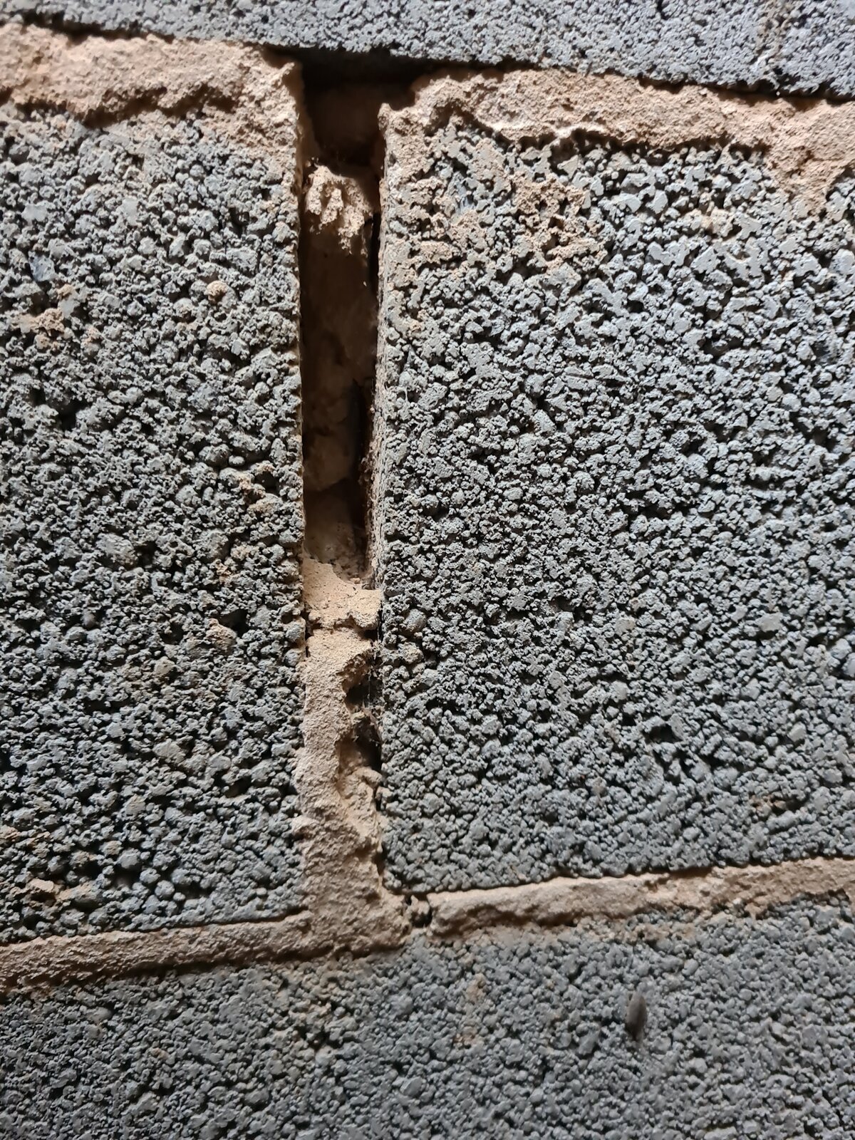

Thanks Mr Chibs. There are a couple of causes of the damp. Firstly, no DPC was used. The builders laid a large concrete slab (with DPM underneath) and then build up on top of the slab with concrete block. Water is also coming is through the mortar on the 2 problem walls. This is because the walls were build so close to the garden fences that those 2 walls were built up from the inside and the external mortar was not pointed correct and had gaps. Also there are overhanging trees (not mine) so a lot of foliage falls down the back and stays wet and damp.
Unfortunately I trusted the builders knew what they were doing. If I knew then what I know now, as they say...

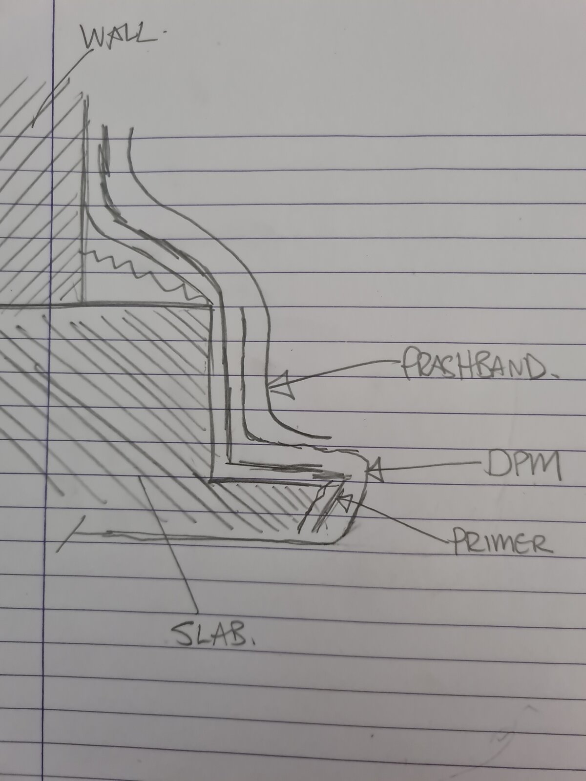

Through having removed the fences and squeezed into small spaces I have fixed the external mortar, and I have applied a water seal to the blockwork. At ground level I have also dug down and found the edging of the DPM. I have put a mortar seal in the corner between top of the slab and the bottom of the wall, applied flashband primer, pulled up the edge of the DPM and then applied flashband, finally putting gravel in the gully at the edge of the slab base. It might not work, but I'm hoping it will make a difference.
In terms of the roof, I think I could squeeze in 100mm as the clearance is 95mm. I will be looking to add inlet vents to feed fresh air in and pull it out with the inline fan on a timer.

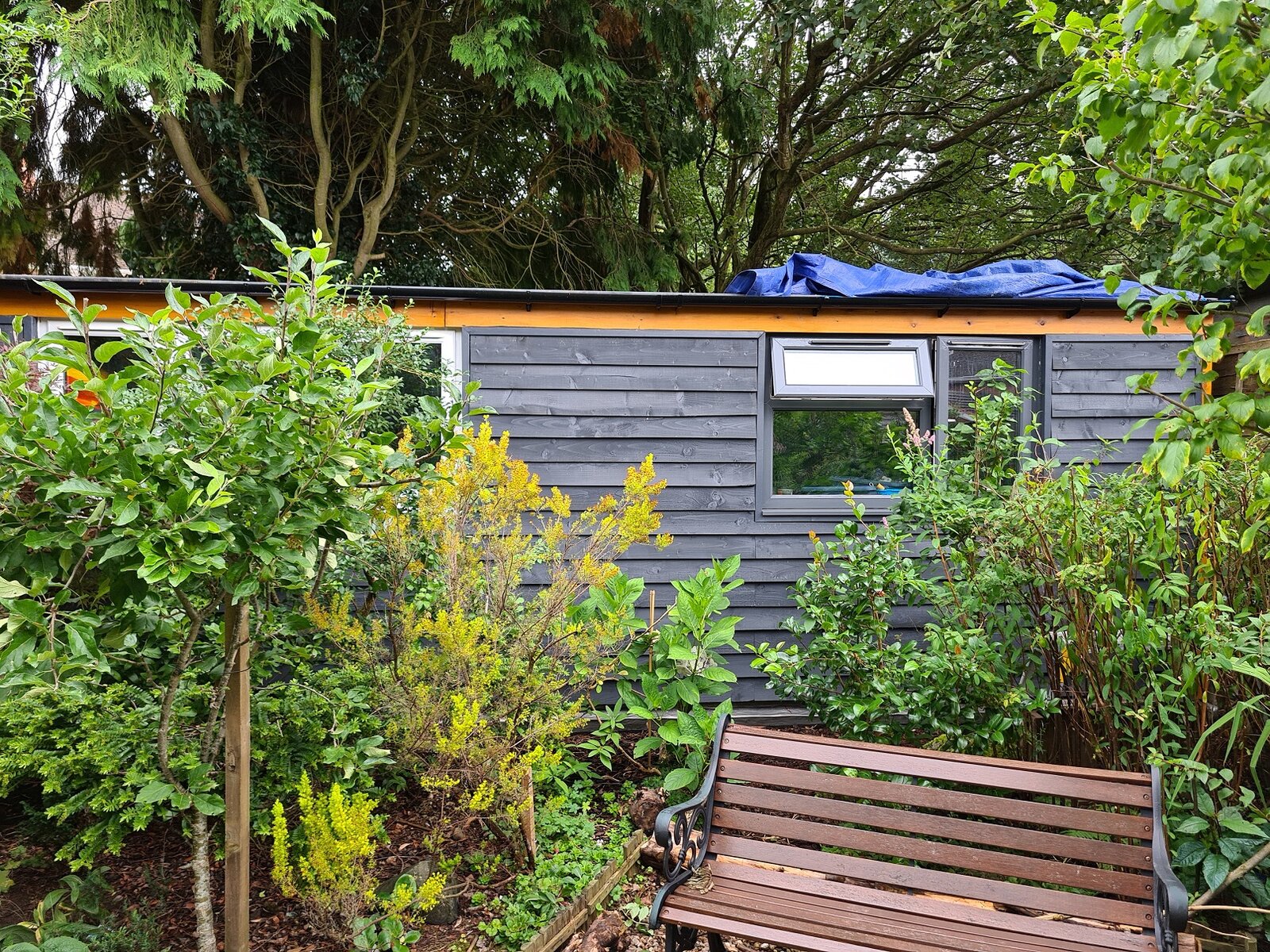

Sorry to hear this.
You'll just have to do what you can, it's funny but in your last pic, the ground looks dry, but you've probably had good weather over the last few weeks.
I quite like John's idea of some form of cladding, you could knock that up pretty cheaply, wrap wall in membrane, add a few battens, nail something like feather edge to battens, this will shed rain and crap from the trees.
Let's hope your fixes might help.

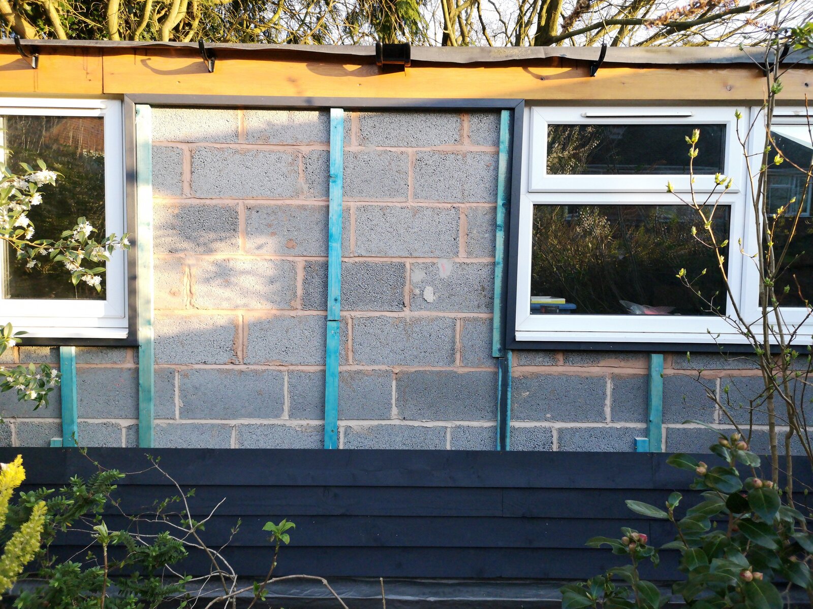

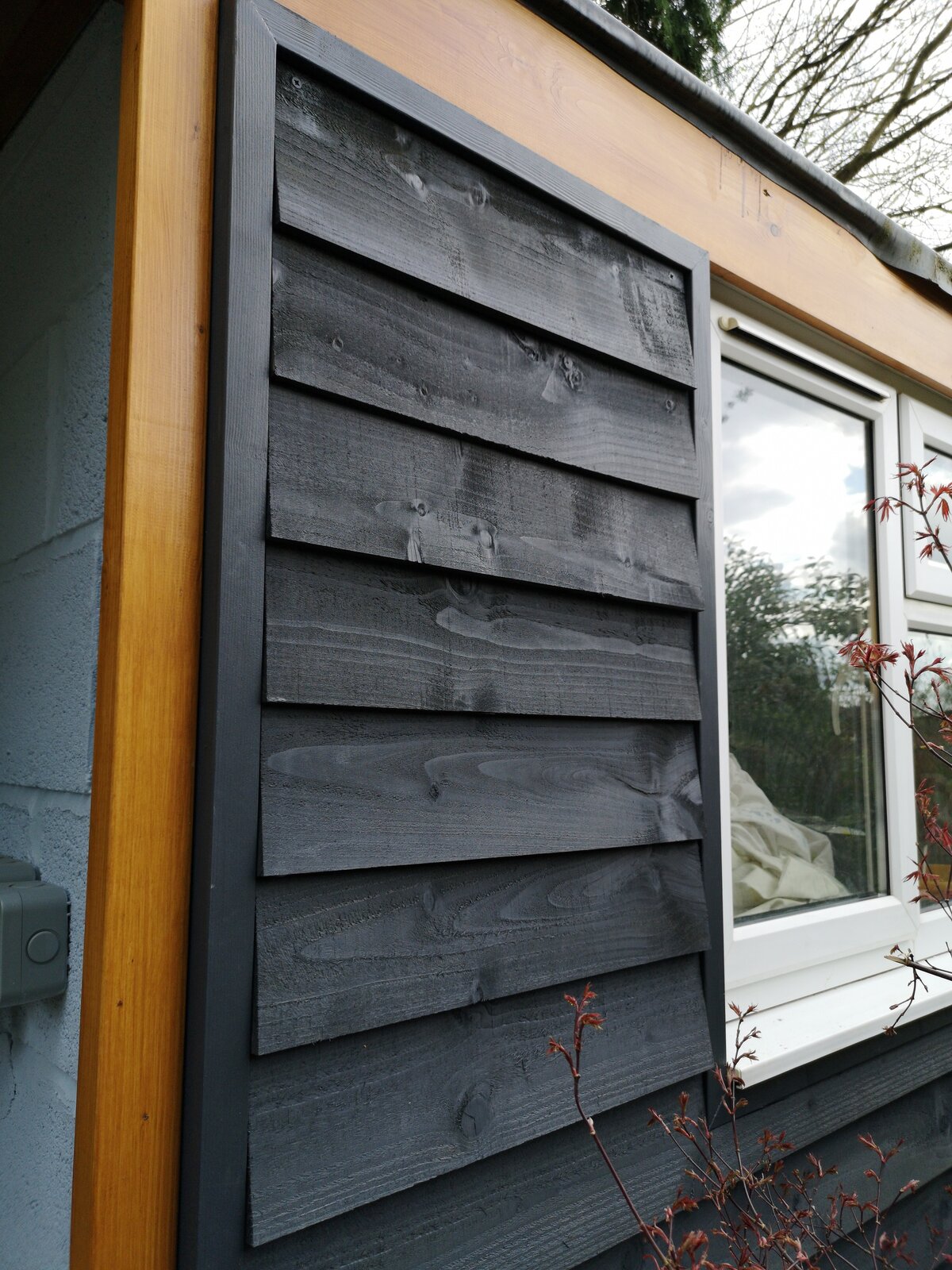

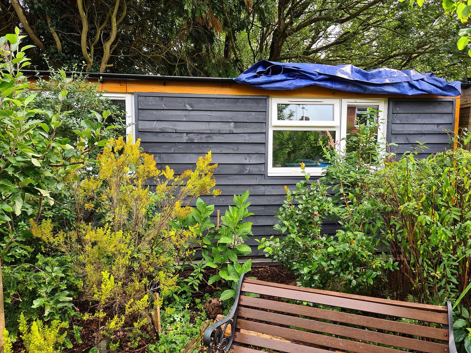

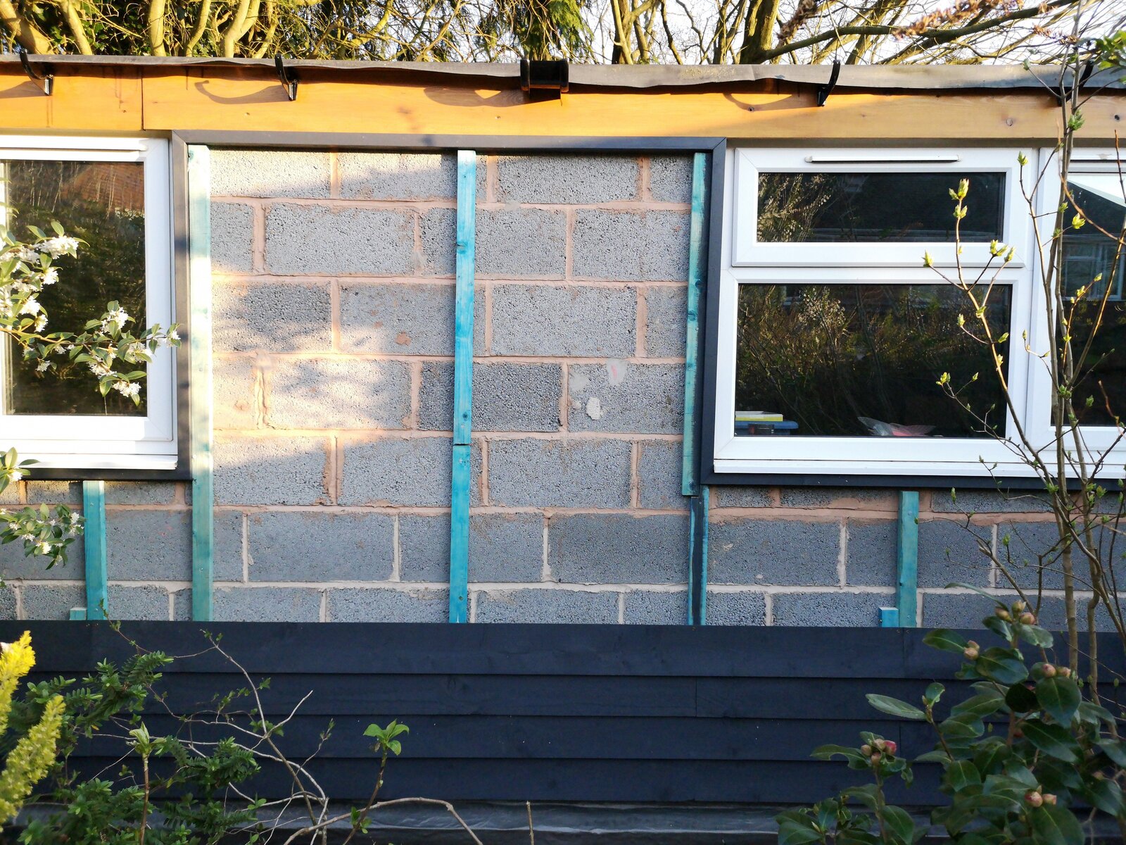

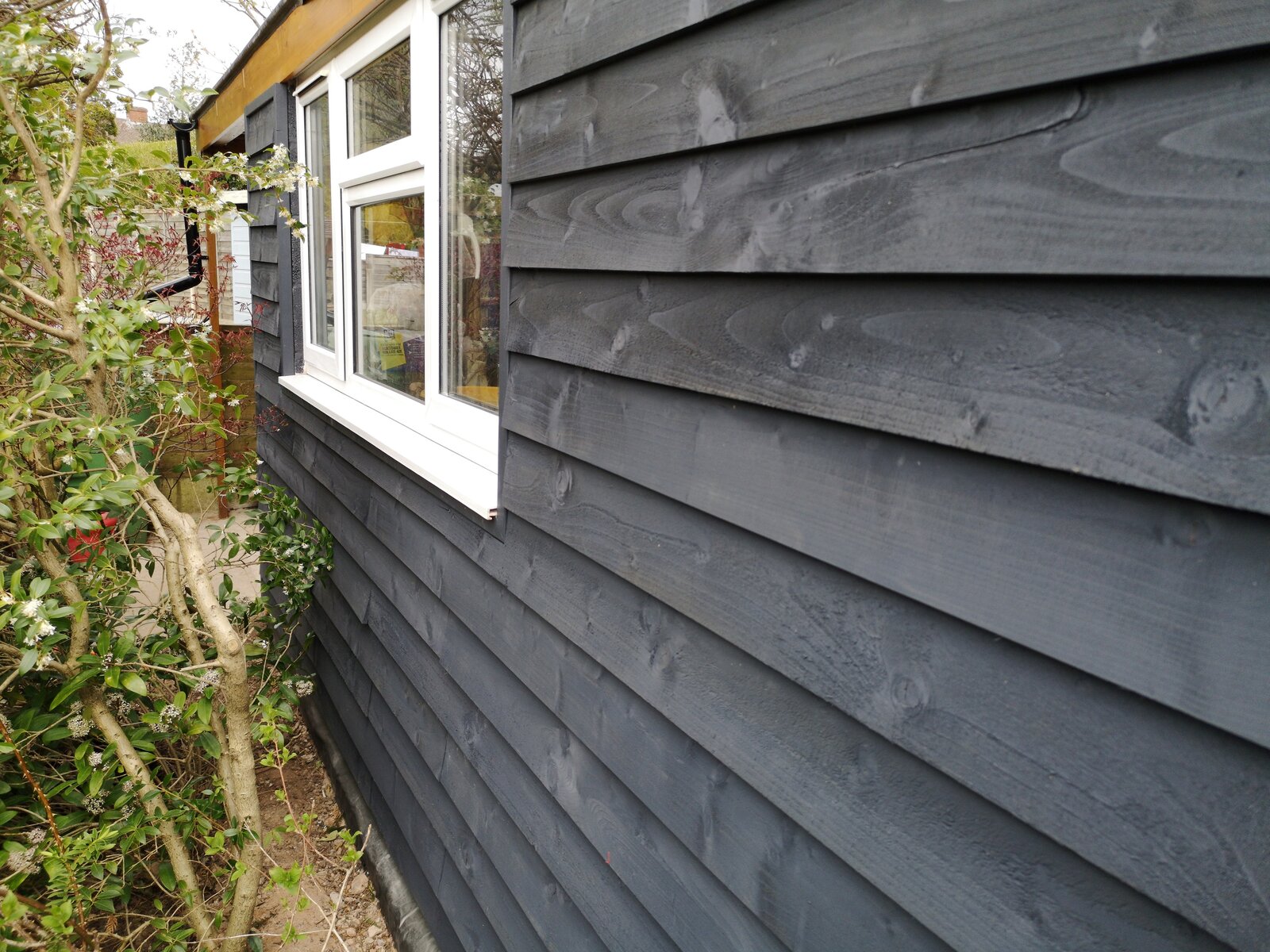

Hi JohnD, DPM and DPC as above. I've clad the front of the workshop for aesthetics and protection, as attached. The 2 problem walls, back and side have narrow gaps and I've gone with water seal, flashband at the base and hopefully better drainage.

Just thought, yes it hurt, you could try out 'dry rods', you drill in the mortar line, low down and pop in the rod... looks like a slimey glue stick, this impregnates the mortar and makes a dpc in the mortar.
if you can prevent rain from falling on the edges of the slap, where it projects beyond the shelter of the shed, that will keep it dry. You might be able to lay a course of bricks or something, with the dpm wrapped or jointed under it.

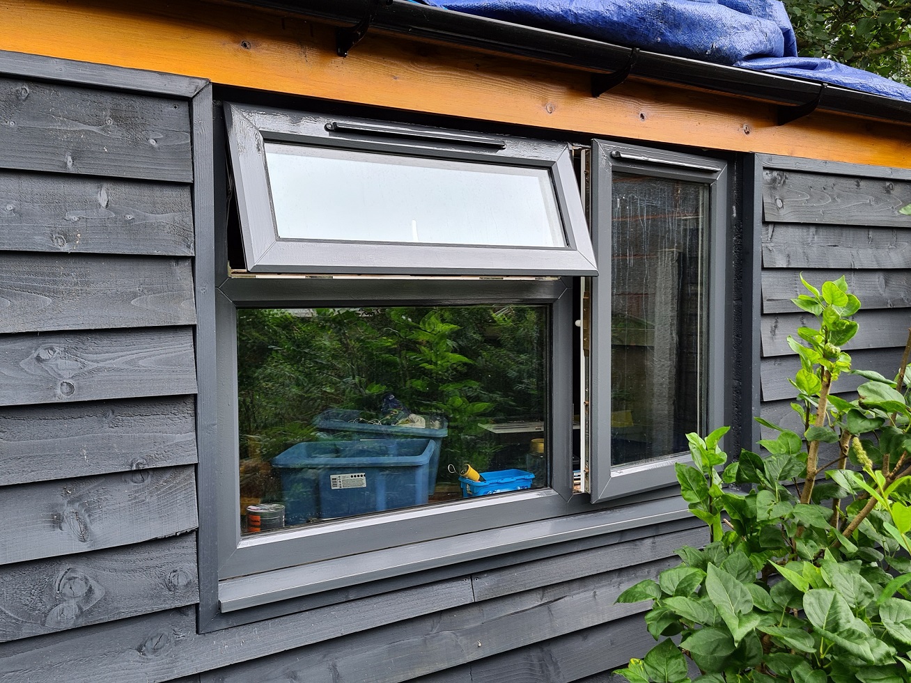

Thanks, really pleased with the cladding, it's Cuprinol Garden Shades urban slate, its a very dark grey. I'm also in the process of painting the PVC windows a similar colour with some rustoleum PVC paint.

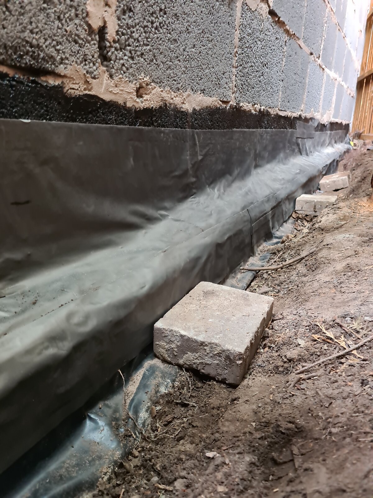

I've done that at the back as best I can, I've folded the DPM up, glued in place and stuck flashband so it overlaps. Fingers crossed this will work

a course or two of bricks would be more permanent. There's a type of brick with a sloping top that might be ideal. Queen brick?
W2055_860265_00
"plinth brick"

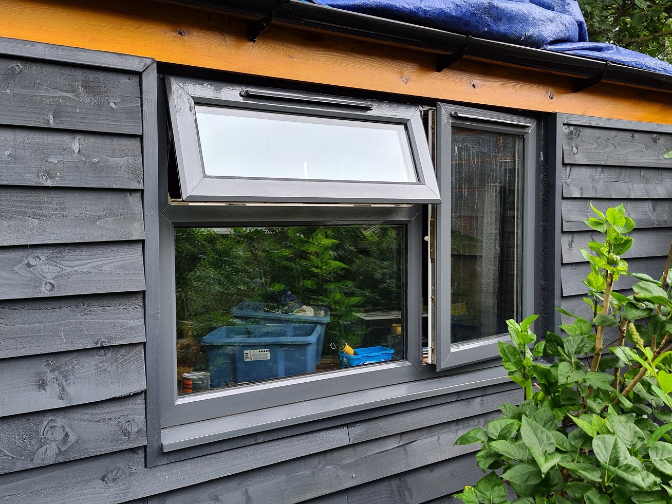

Please post a pic once you’ve painted the windows. My neighbour painted his windows with Some aerosol from eBay, the finish is very good, he went dark wood to white.
Good luck.
Good luck.
One window done. I did consider an aerosol, and to be honest I wish I had gone with it. I used Rust-Oleum All Surface Paint, having read good reviews and see people paint PVC window frames and front doors with it. However I was not impressed, it was like using gloss house paint. If it had been on my house I'd have stopped early on and wiped most of it off.
