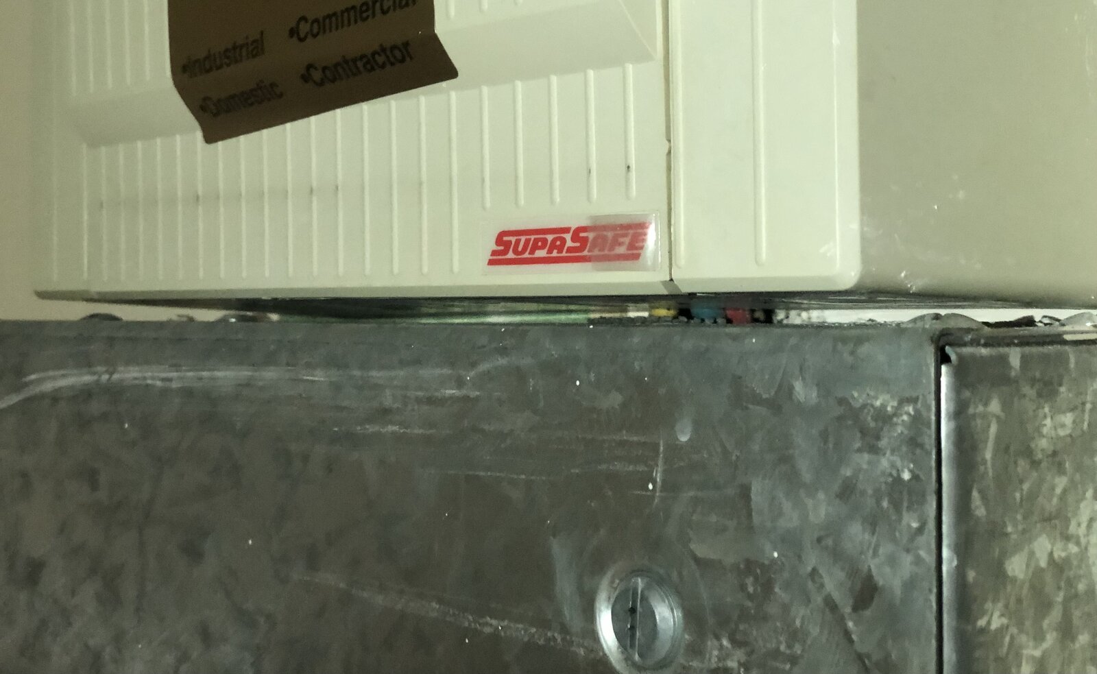

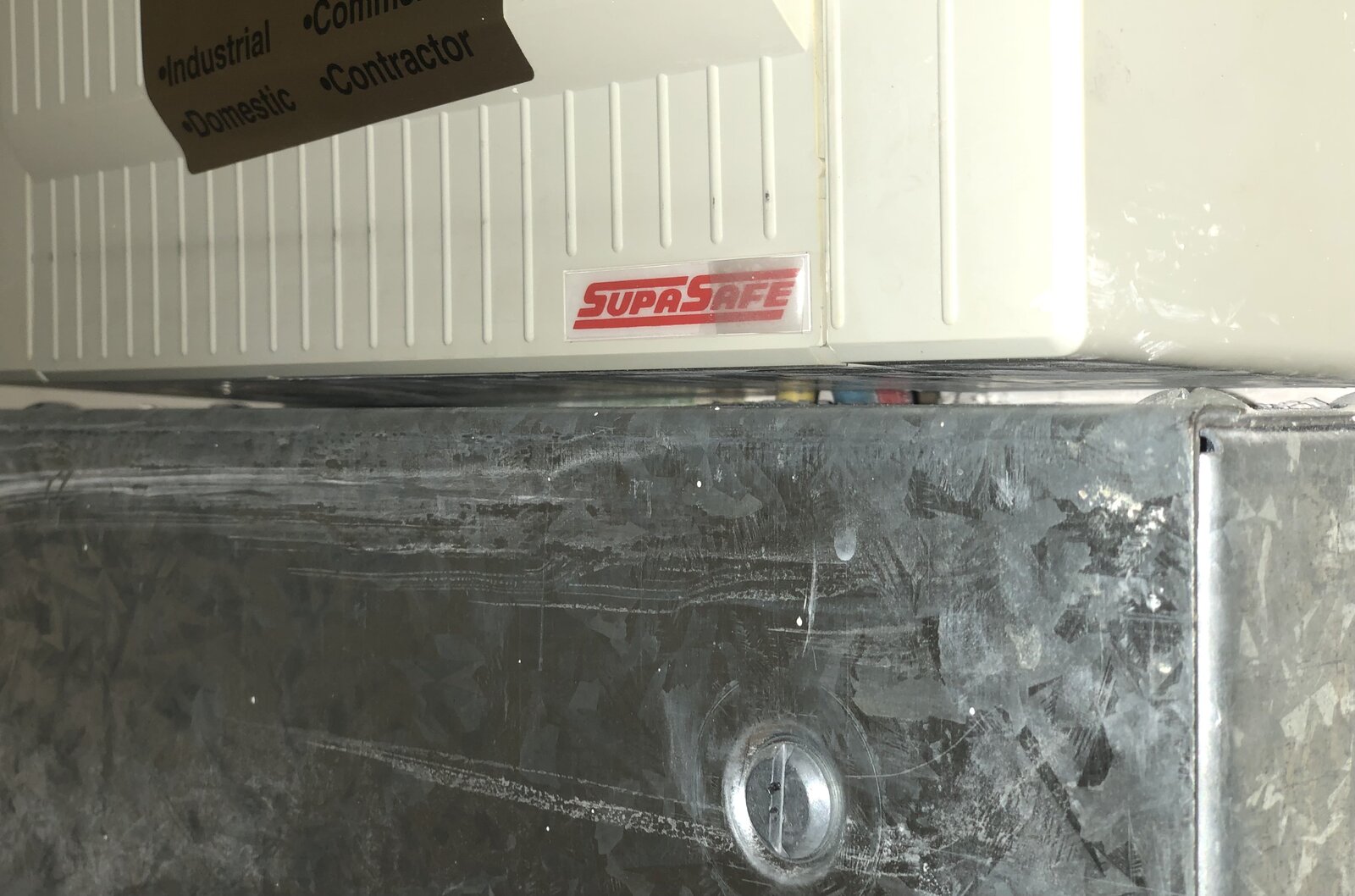

Hi All,
We live in a flat built in the 90s. Just under the consumer unit, we have a rectangle shaped metallic box which is slightly wider than the fusebox.
Do you know what this is and what is inside it? (Apologies, the picture is not the best, as it only shows the metallic box partially, but hopefully you can still see what I mean)
Thanks for your help!
j
That appears to be a piece of trunking and I expect it to only contain wires. I may be the result of extending the wires at a consumer unit unit change and contain lots of joints.
A wider photo may make it more obvious to us.
Steel wire armour (SWA) glands tend to warp the plastic of old consumer units, putting some trunking underneath it allows the use of SWA glands without warping the plastic. It is simply a box, nothing more.
One would hope that trunking hasn't been used to contain electrical connections.
Because it's ****. Also the Wiring Rules in the south of Ireland are sensible enough to explicitly prohibit it. So that should be evidence enough that it's poor practice.
So please explain the difference between a folded sheetsteel box containing connexions and purchased from a shop and a bespoke folded sheetsteel box containing connexions and constructed out of parts purchased from the same shop.
From the initial description I would happily describe it as a bespoke enclosure provided for the purpose of extending the wiring, I have mentioned a wider photo may indicate if this is likely to be the situation.
In other words I'm proposing this may very well be an adaptable box that looks like trunking.

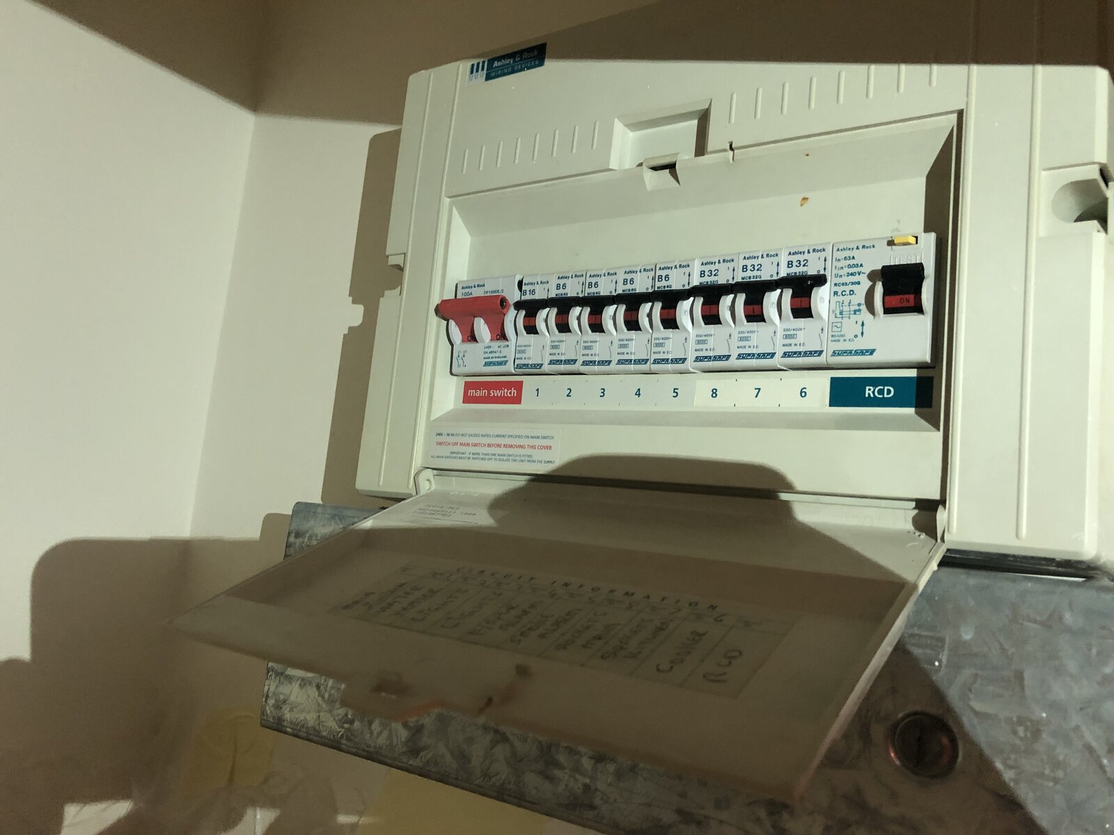

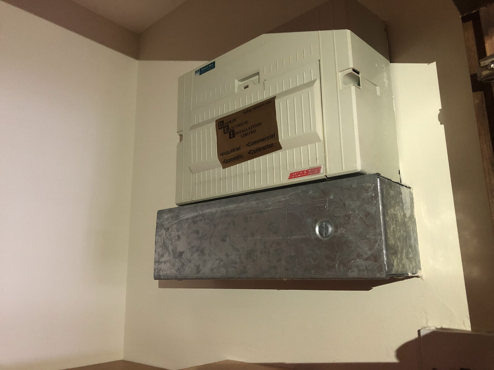

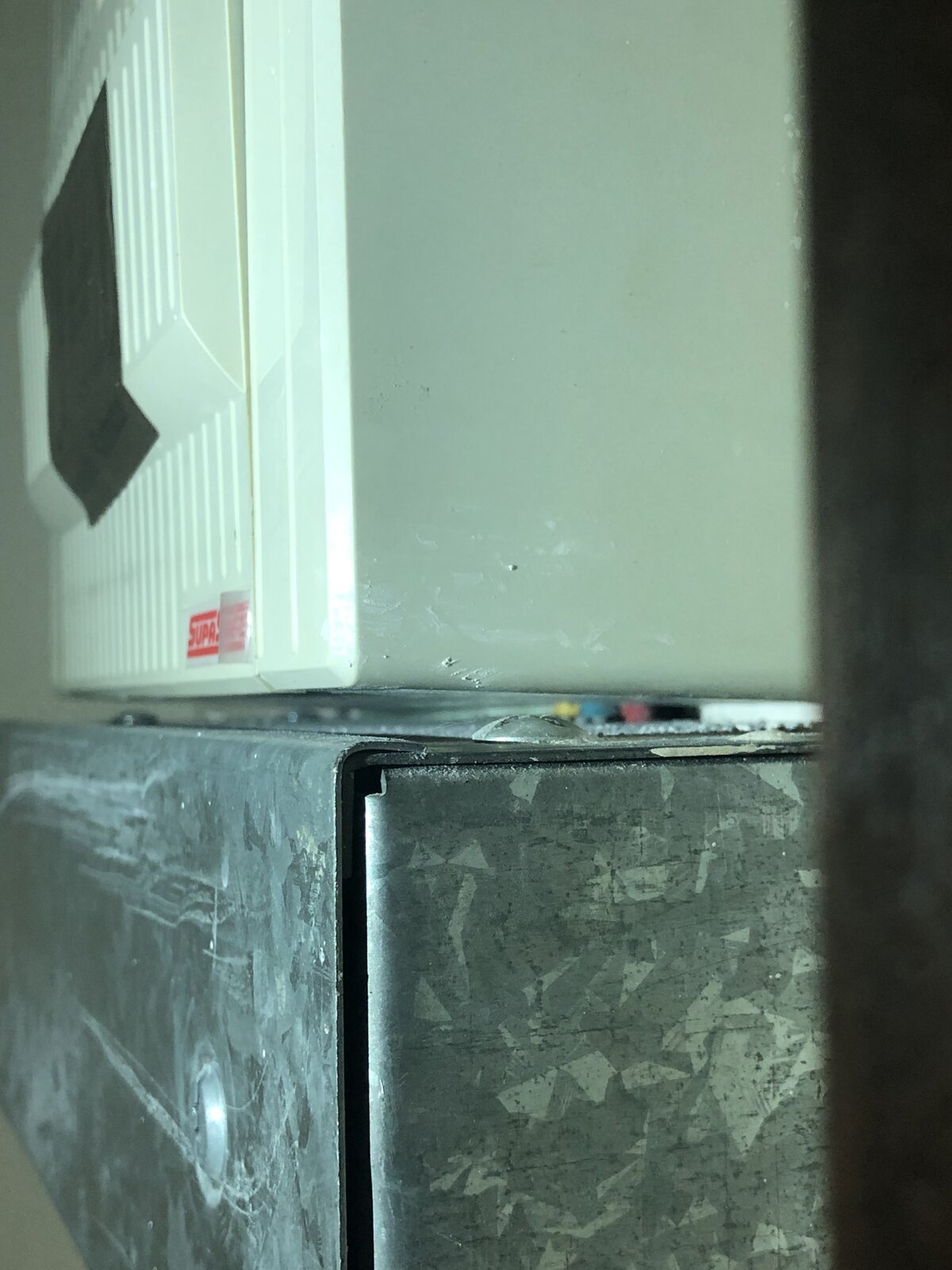

I took a closer look based on your comments and made some more pictures. It seems to me as if the thick cables were going into the consumer unit from a cavity in the wall and not from the trunking box. I might be wrong, but what's the point of the galvanised steel trunking box? Why not input the cables straight into the CU?
That seems to rule out my thoughts of loads of connexions.
Other than taking off the lid - Which I do not recommend due to the risk of damage to wiring - we will never know. However I'll suggest it is (or possibly was) put there for a reason.
I had an installation with a piece of metal trunking passed by ECA and that had jointed cables in it.
There's no difference between that and an adaptable box, providing ingress protection is up to scratch.
Prohibit what? - electrical connections within an earthed metal enclosure?
Do they have metal-cased CUs/DBs in that country and, if so, are they not allowed to have 'electrical connections' within them (and if not, how on earth do they use such things?) ?
