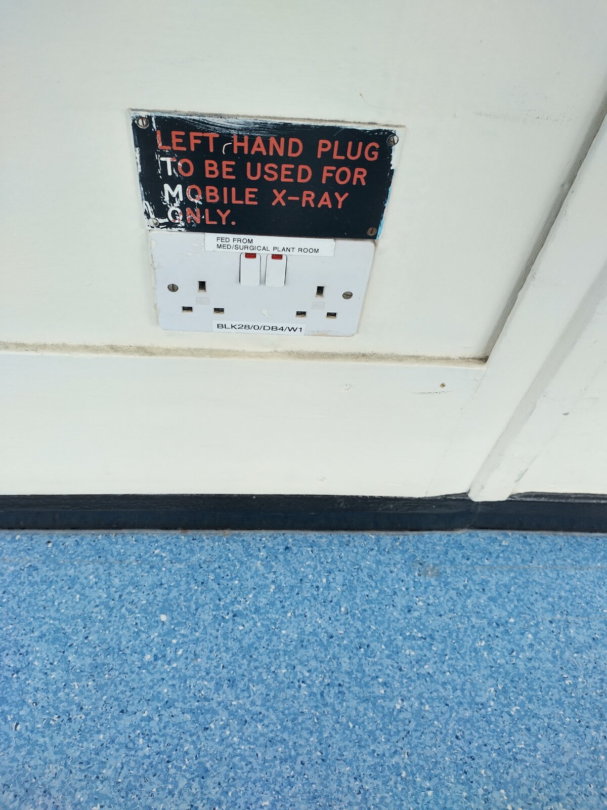

Saw this in my local hospital and wondered...
How...?
Why...?
Is it a special socket with two separate feeds?
Technically, it could be read in 2 different ways.
They may have used the term "plug" wrong - so intended left socket
They may literally have meant there is some form of plug or adapter they where referring to.
Could one side be a 'clean' earth?
I don't know if portable x-ray machines would require one though :unsure:

The sign predates the socket by a long way. The socket looks like a standard 2647 socket which is exactly the same as an MK 2747 but has neons built into the switches.
I wonder if the sockets (back in the day) were two singles and the left hand one was fed from a different circuit? But since then, the old X-ray socket has been removed and a double fitted?
My thoughts too, also the painter needs a talking to
Could it be that they were just trying to ensure that a socket stays free so that when the mobile xray guys come round they could do their thing.

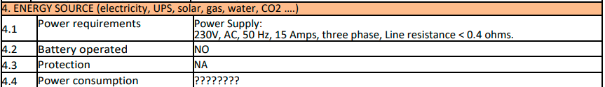

This is from a relatively recent (2019) document relating to mobile medical x-ray equipment from the government of India, hence perhaps reflecting 'how it was' in the UK a few deades ago. The power consumoption figure and the 'protection' are both a little interesting :-) ...

It certainly seems there was a period when unfused 13A plugs were used on mobile x-ray machines.
