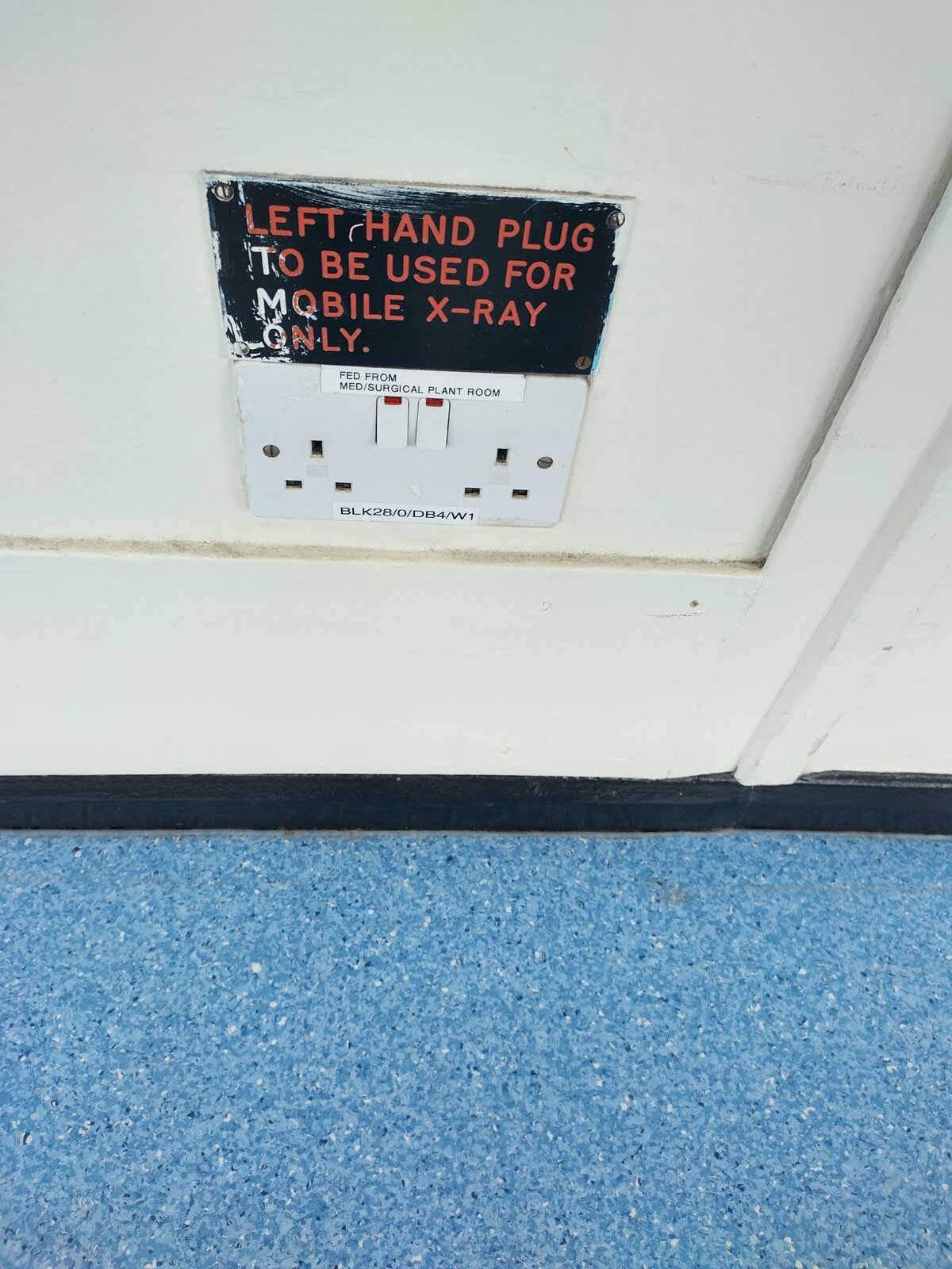

Saw this in my local hospital and wondered...
How...?
Why...?
Is it a special socket with two separate feeds?
Its just ring fencing the socket so it is permanently available for x rays. It would be awkward to have to unplug a life support machine because there weren't any other sockets available for x rays

Yes, the red 'unfused' plugs certainly were used in hospitals,and maybe still are. As I wrote yesterday,the argument for them that i often heard never seemed very convincing to me- since the blowing of a plug fuse almost always means that something has gone fundamentally wrong with the connected load (which has therefore probably already stopped working.
That would indeed be 'awkward', but I think that every hospital ward I've ever seen has had a vast number of socket outlets - at least one double socket by every bed, for a start, but countless others as well - so I don't think it would ever be difficult to find a 'free' one pretty close :-)
I seem to remember that X ray equipment used D- type MCBs.
And that a lot of hospital sockets are on 10 mA RCDs.
That would make sense. As I wrote above ...
..... I think it also could have a very high 'start-up' current, hence presumably needing a very forgiving OPD!.
.... although most of my recollections are so old that it may well have been fuses back then,even in hospitals. As I've said, I recall the very big plugs (and matching sockets all over the place, and the cable drums on the sides of the machines which had lots of hefty cable (probably more than half an inch in diameter), which I thought was 3-phase, butmay have been just high-current single-phase. However, as I've also said, the kit around today is much less power=hungry.
I have no idea about the modern gear, but it wouldn't surprise me if X-ray equipment were too 'leaky' (particularly in relation to its filtering) for a 10 mA RCD to be usable.
