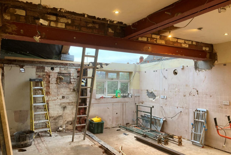

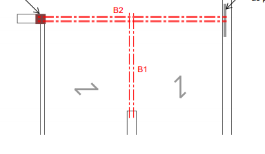

SE originally provided calculations for 2 steel beams. B1 supporting an interior wall, B2 support the rear side of the house. B1 is bolted to the centre of B2 so the steels forms a T shape (pic attached).
The SE forgot to add the point load of B1 on B2. I have now installed the steels and have just noticed this. I approached SE and asked them for clarification. They have resent the calculations, however I have noticed that for B2 the deflection limit has dropped from 374 to 281.
I figure they had to do this otherwise the calcs will fail.
Can anyone let me know if a deflection limit of 281 is ok?
Both beams are carrying plaster, tiling etc.
Any advice would be appreciated.

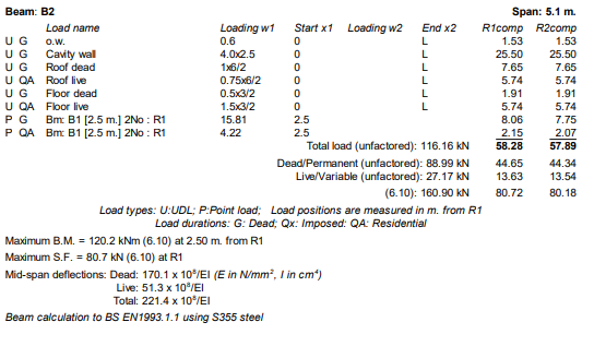

The figures relate to the total load. Figures for beam B2 below.
Deflection
LL deflection = 51.3 x 1e8/(2 x 210,000 x 2,900) = 4.2 mm (L/1211) OK
TL deflection = 221.4 x 1e8/(2 x 210,000 x 2,900) = 18.2 mm (L/281)
If the total deflection is 18mm on a span of 5.1m(?) it might cause cracking above, depending on the material and workmanship.
Are the beams 203 x 133 x 30 by chance? Is the SE assuming the beams will work together and both carry the load 50:50?

Correct again, the SE has assumed the beams will work together, please see attached load calculation.
The SE has assumed that the beams will work together. Not sure if this has any bearing but the beam span is 5.1, which include 250mm each side to sit on the column & padstone. This leaves an open span of 4.6 m.
Look forward to hearing your thoughts on this.
The only thing I would say is that the SE has the beam carrying roof load across the whole span. If this is a rear knock-through type situation that's not going to be the case. British Standards specifies a load triangle of 45° or 60° depending on the circumstances. Even at 60° the roof load will be less than half the full width.
That said, off the top of my head, you might still struggle to get down to a 203x133x30 beam on the inner leaf. Have you ordered these beams yet?

@op I doubt an 18mm deflection would cause a problem for the roof, as the timber and tiles will accomodate a degree of movement, but it might cause some cracking in the masonry above. In practice the deflection probably won't be that much as the live load values are quite high - and what's the chance of maximum roof live load occurring at the same time as maximum floor load? And as jeds mentioned, you can take the arching effect of masonry into account, which can reduce the dead load considerably. Id be inclined not to bother with an additional pier.
Small point: had the builder raised the main beam level with the incoming beam, you would have reduced the wall load by 2 courses height.
@jeds, i think you're correct about the beam under the inner skin; the SE seems to be assuming this will only be taking 50% of the point load by sharing it with the outer beam, whereas in practice it will be taking almost all of it. The usual mindless nonsense of connecting beams with lengths of tube and some threaded bar from Screwfix, and expecting them to work as one, is pie in the sky.
Too late now but on that job i would have considered a single 203 x 203 x 46 or 52, with a 250 wide plate tack-welded on top to pick up the cavity wall. The incoming beam could have been notched at the top and sat on the bottom flange (frowned on, i know, but it works!).
