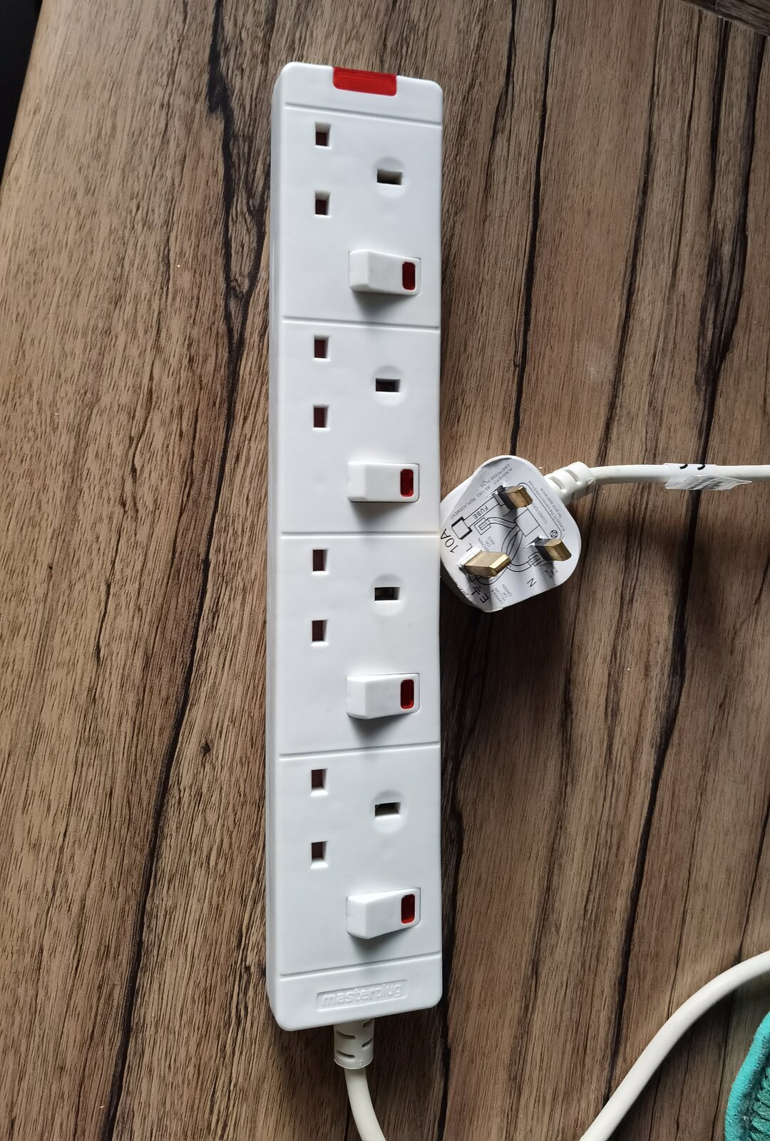

Found an old masterplug 4 gang extension and was wondering if it had surge protection?
Why do you want surge protection?
What sort of surges do you worry might happen? i.e. what would be the cause of them? How big would they be?
I thought it was what you needed these days?
Surge protection is recommended for most electrical installations.
Plugging in a random adaptor which claims to have surge protection of some kind will achieve very little.

I wasn't sure that why I posted it, it's an old masterplug.
I usually buy pro elec It's just going to have the router, eufy doorbell hub and dehumidifier plugged into it
It looks in good condition and should be fine for that.
