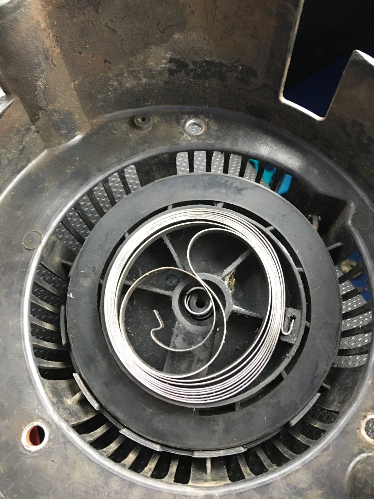

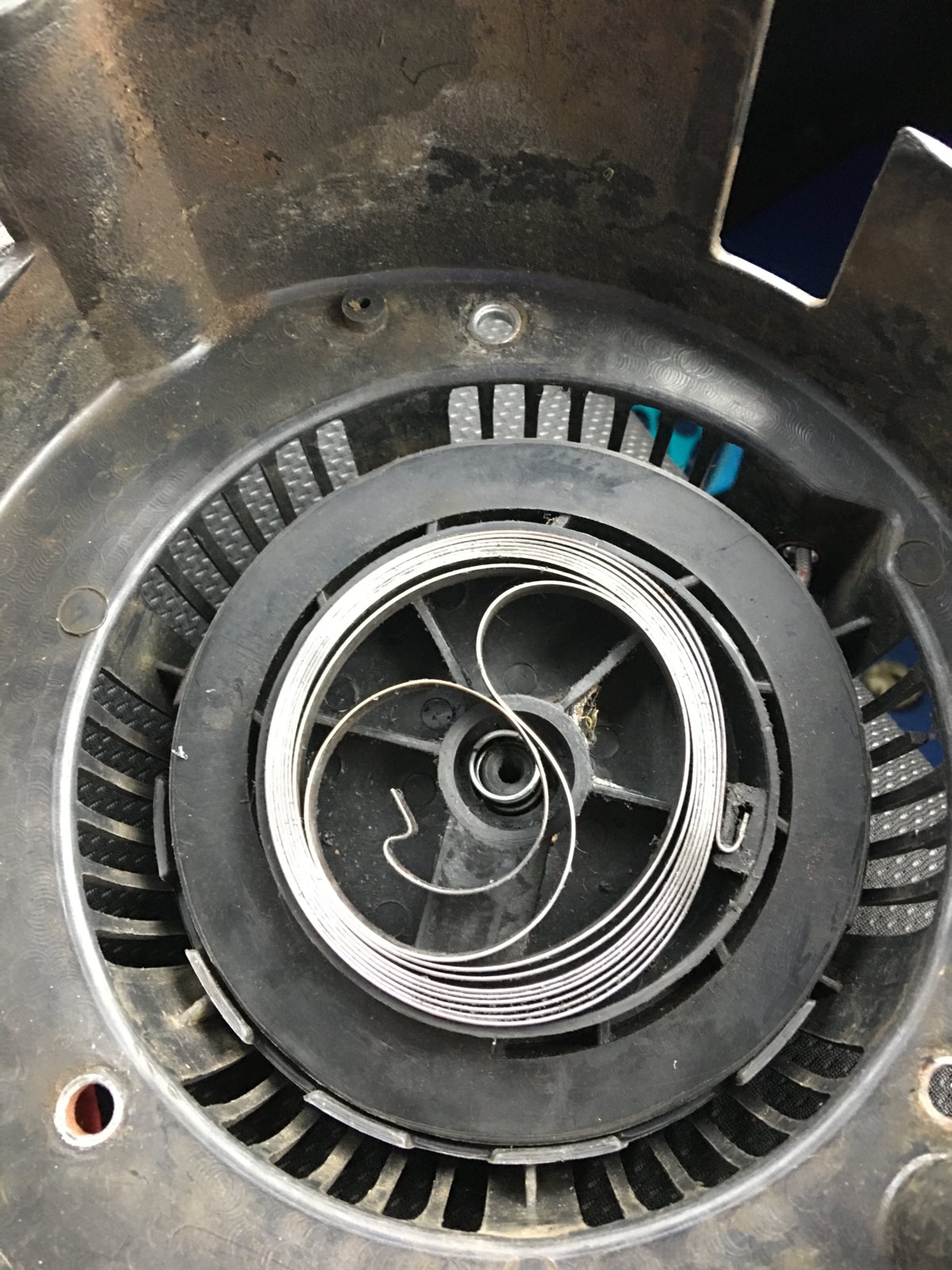

Hi,
Just pulled rope straight out of recoil.
New item ordered but can the item I have be sorted until the new one arrives.
I mean looking at the spring shape etc.
At least the spring is complete!
The inner end of the spring is distorted and wont engage in the recoil centre part anymore - it requires bending back into shape, but there is a chance of breakage.
You can reduce the chance of this happening again by using a longer recoil rope.
John :)
Chance I need to take. a few questions.
I did so it once but didn’t see how to stop it unwinding Whilst I put black cover back in mower.
Plan B as I need this tomorrow, how else can I start it if this dont work.
Notice how the spring is held in the outside, where it bends back on itself.....the same needs to be done with the inner part, and if the spring is wound up tight it should remain there.
Starting the thing without the recoil is nigh on impossible, I’m afraid.
John :)
