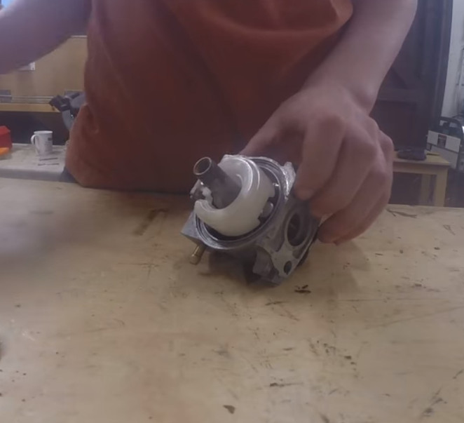

Sure, but pics would help a lot......from the top of the carb, the main air intake (air filter side) and inside the float bowl, if you can.
John :)

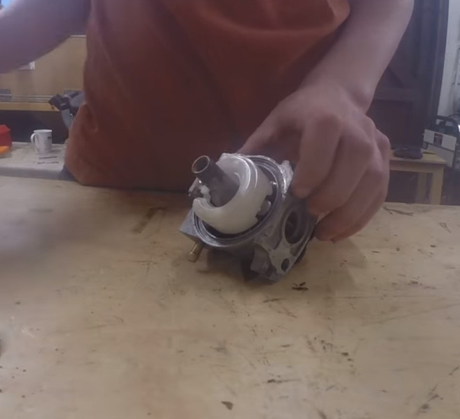

Ok got this off internet.
Carb looks the same.
Is pilot jet down that cylindrical tubee ?
What you see there is the white float, hinged by its pin and operating the needle valve to allow or stop the petrol flow from the tank.
The central tube contains the main jet, with a screw slot. Undoing that lets the jet out, but above that is the emulsion tube that emulsifies the fuel for smooth running.
The pilot jet, and drillings, aren’t shown there. I’ll need a shot from the top of the carb for that.

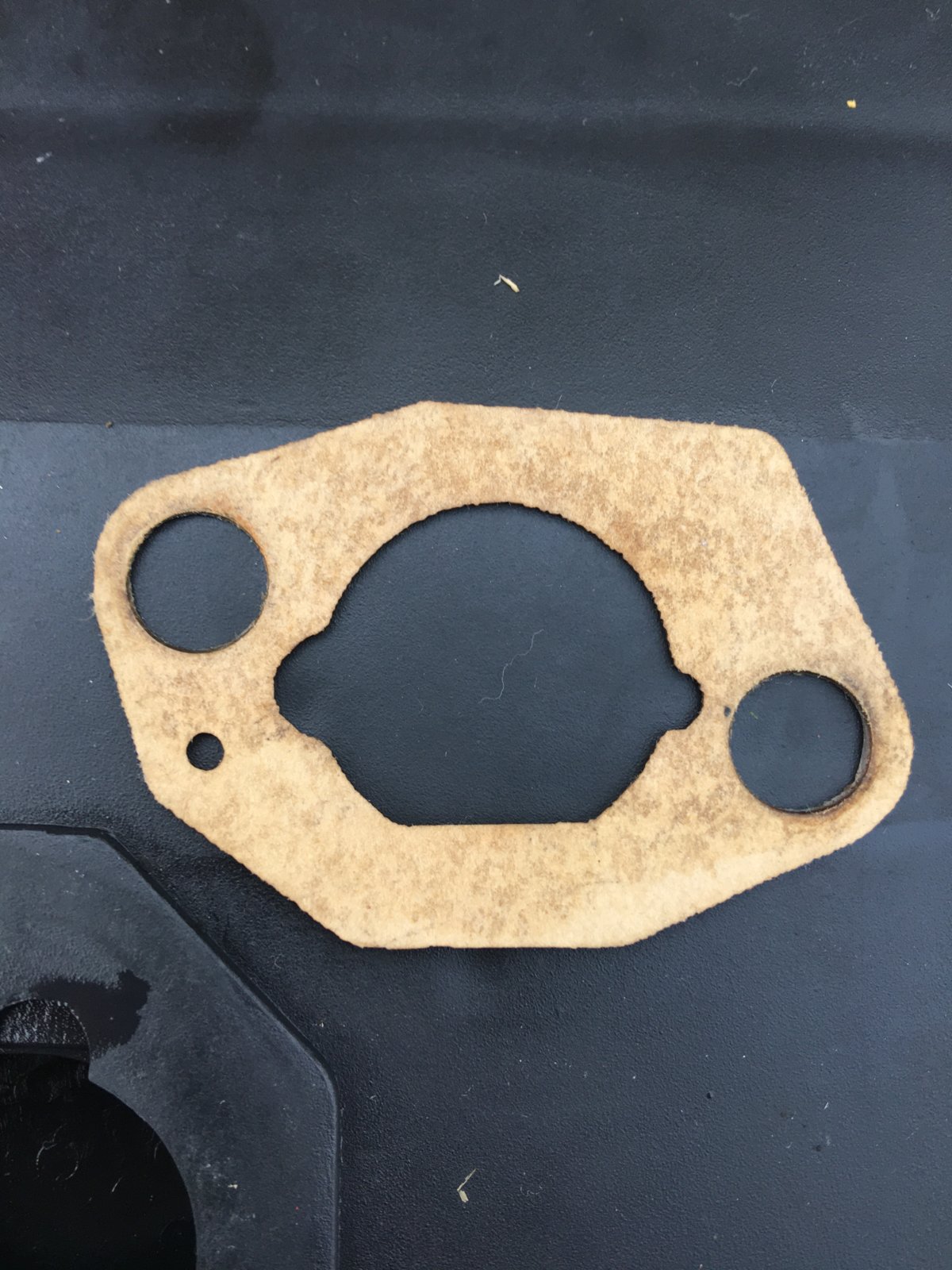

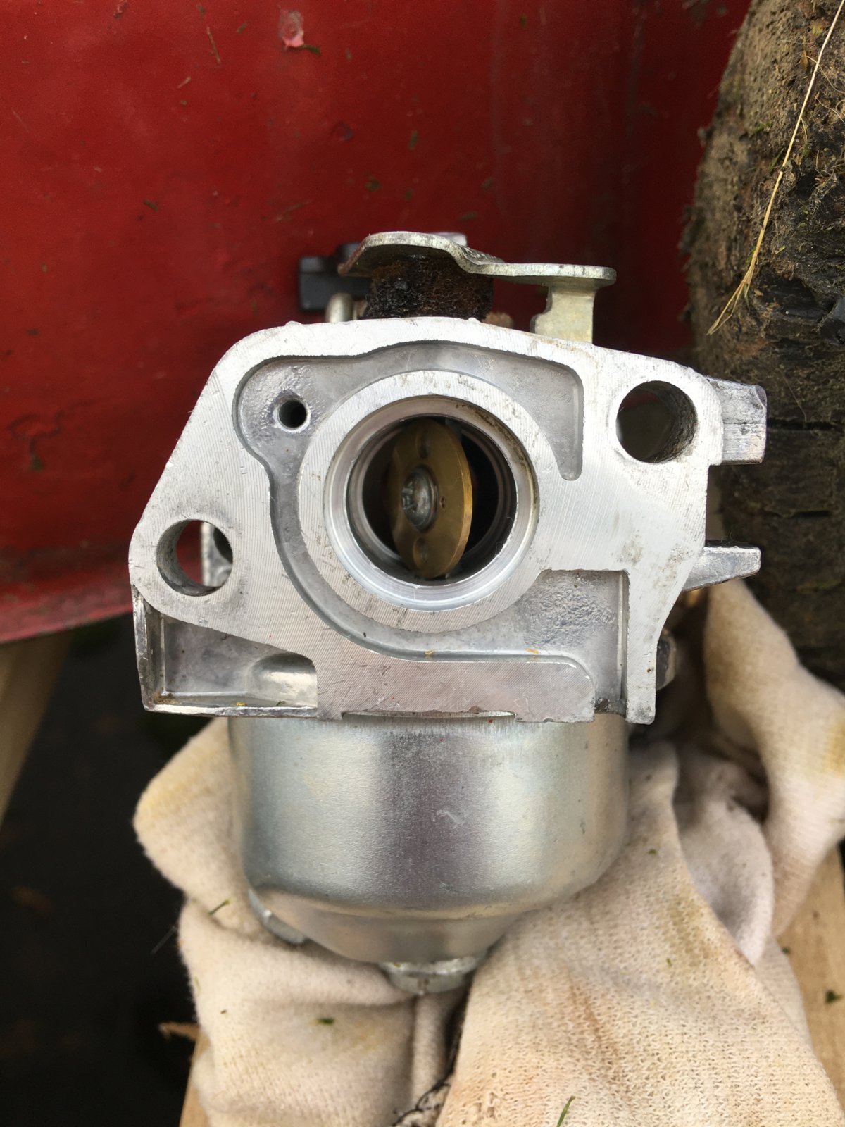

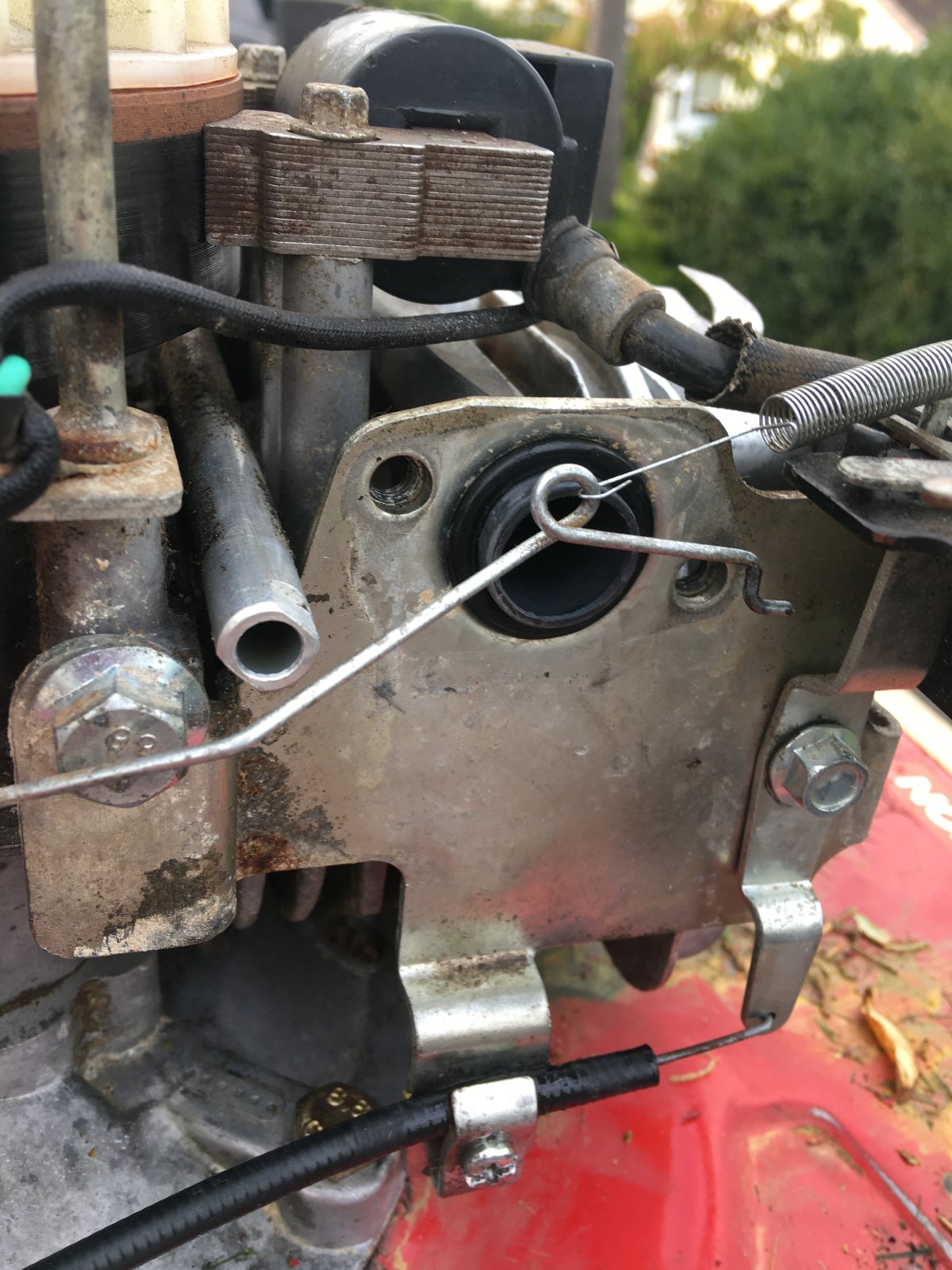

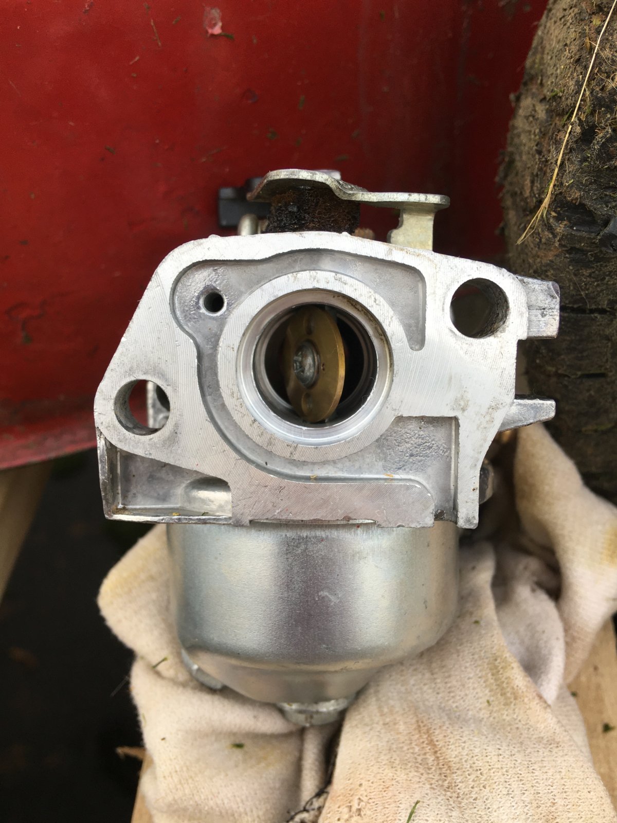

I have a fuel leak.
What is supposed to stop the petrol running out the carb.
some times when not in use I unscrew the cap. When I’m using it the engine burns the fuel so the leak is very minimal. When stopped then you can smell and see it dripping.
It drips from the back of carb when it mounts to engine.
See photos attached.
3 questions for you.
Does the paper gasket fit between black air filter box / carb OR carb to engine ?
I ask because it was between air filter / carb. just making sure it’s in the correct place.
I think the petrol is leaking from the small whole in carb where it mounts to engine. In photo supplied the hole is say top left of carb around 11 o clock mark.
I understand the black o ring seals against carb but the fuel coming out of this hole runs behind or down the side of it. The seal actually seals in the recess of the carb NOT this hole.
So why does it do it ?
I removed the white float in the carb and the needle jet moves fine so it’s not as if it’s stuck open etc.
