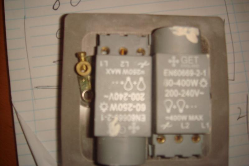

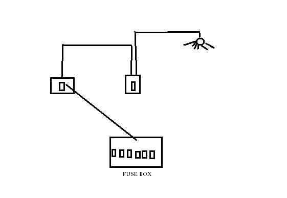

Swith in my living room please help
use a piece of terminal block..
connect the 2 blues together.
connect the 2 browns together.
connect the 2 earths to the metal backbox..
turn the breaker back on..
what happens..???
the lights are working !
In that case, connect the two earths (green/yellow) to the earth terminal of the metal switch. Connect the two blue wires to a terminal block (gently push this into the back box so it isn't fouled by the fixing screws or switch). Connect one brown to "C" and one to "L1".
Do the lights work correctly?
