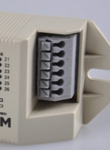

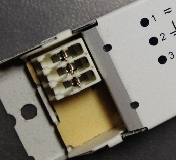

Hi thanks for your reply. Actually looks different to that. Its full title is: Osram Quicktronic QTP2 2x18w T8 Electronic Ballast. Pics of the exact unit now attached.Osram QTP8 - 1.jpg Osram QTP8 - 2.jpg Osram QTP8 - 3.jpg

The top slots are for when they are built in a unit and punched in with a machine tool, on the front face you will see round holes, these are for the general public to use, just strip 8mm of insulation and push in, tridonic do a tool but that is for releasing wires from the round holes

I have never seen a tool to fit it would be similar to a bt or krone type tool, you dont strip the core, you would lay solid core cable on the top and punch down, im sure you know the type.
The stripping length on the unit refers to solid core used in the holes, which in the picture are not used, many fittings are now shipped out with the wires punched in and even lampholders in modules are using the punch down terminal.

There is a push-in looking hole in the top. I didn't realise there was another on the front face.
Oh , maybe im wrong then, that pic does look a bit strange to the common ones i have seen, unless its the light reflecting back.
Usually its a U shape slot
It may be best if the OP posts a pic of his end on
Thisis similar, showing the 2 bottom round holes for basic use

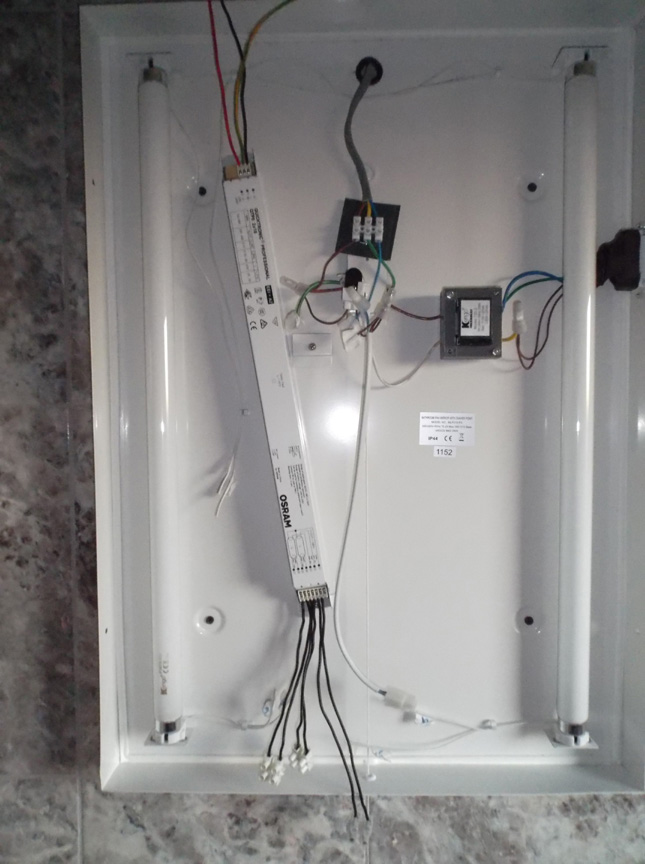

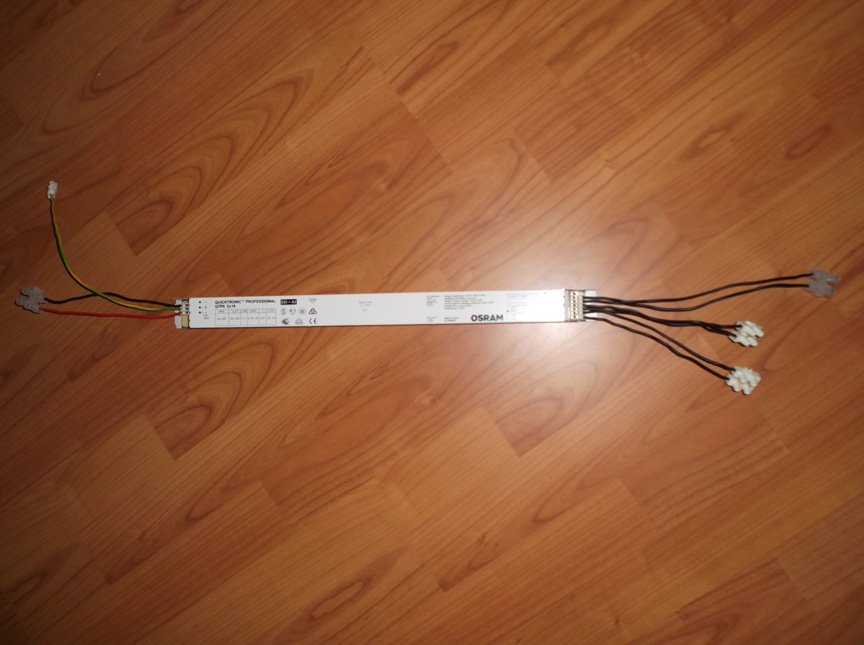

So, all wired up fitted, does it work? NO! There is power going through all wires as it should be, lamps checked all apparently fine. Now I think a transformer is dead. This is for a shaver socket on the mirror. Ever since the mirror was fitted I could hear a buzz from it, now, today no buzz and doesn't look like power going from transformer to socket. But I don't think that would be required for the lights to work.

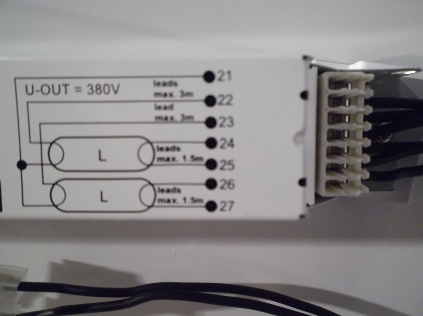

I've attached some pics. I wonder what idiot thought this was a superior way to go for fluorescent lights instead of a small starter, it's a horrendous hassle in comparison. Did anyone tell the "inventor" BALLAST IS USED IN BALLOONS AND SUBMARINES!
The only wire not connected on the ballast is the last wire, as it doesn't look as though it's needed. wire 21 in the below pic.

Thanks for the reply. Would connecting a wire from 21 to 22 (in the external block terminal) be correct going by the diagram on the case in this pic?

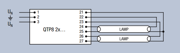

No.
Not sure what your confusion is.
You have eight tube terminals and seven on the ballast. 21 is connected to both tubes.
Is this clearer?
