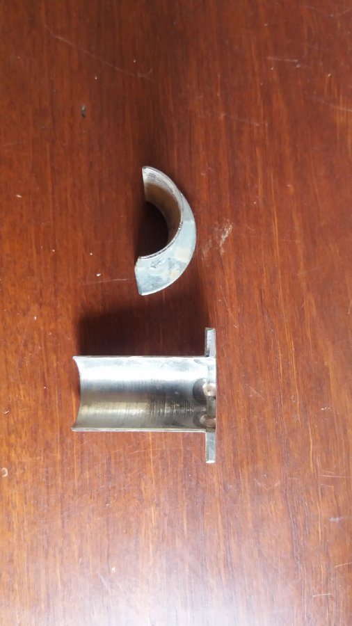

I just came across this thread while trying to figure out how to undo these fittings myself. You do need a tool for doing it with, I made one up myself to remove the fitting from some 20mm pipe. I used a piece of 22mm SS tube, which I drilled a 20mm hole through. Then I tacked an M20 washer to one end and cut the tube and washer in half. This allowed me to tap the tube up the pipe and into the fitting to loosen its grip on the pipe.
