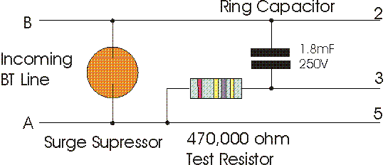

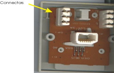

in this next picutre we see what is inside a master
in the case of a non nte5 master there will only be terminals labeled with numbers the A and B refer to the seperate terminals that are on the rear section of the NTE5
the surge suppressor is of no interest in the normal functioning of the line
the capacitor provides the ringing signal on pin 3 which is linked to all extentions
if it is impractical to get a third wire to an extention (perhaps due to damaged cable) then a second master can be used to get a ringing signal for the extention but this is considered bad practice unless unaviodable (see below for why)
the resistor is for test perposes and this is why putting in multiple masters can confuse the line testing equipment. if there are multiple masters (though you could clip it out of the second master socket)
btw pins 1 4 and 6 serve no perpose in a normal install 4 is usually connected for neatness though as 4 core cable is often used. in some cases you may even see wiring with all 6 connected
plugwash said:
http://www.wppltd.demon.co.uk/WPP/Wiring/UK_telephone/a_Phone_wiring_cct_diagram.gif

plugwash: thanks for the useful images, so master sockets are physically different. (If you are not supposed to connect to the back of non-NTE5 master, why are there connectors?)
