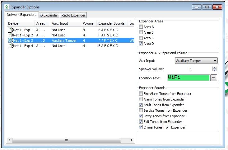

Ok, two final issues that I have. The first being the Wireless Expander, still cant seem to get that going. Have checked the cabling, its powered as it gets its feed from the network port same as the keypads + - T R. Its also registered under expander RK3, other two keypads are 1 and 2. Not sure what else to do on this one.

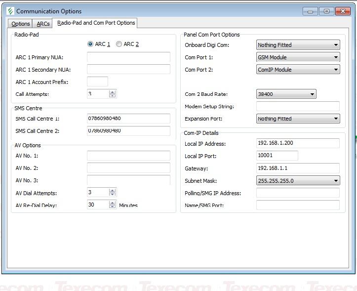

The final fault I have is the GSM module. Ive registered this on COM1 but I get the error message saying Error Com1.

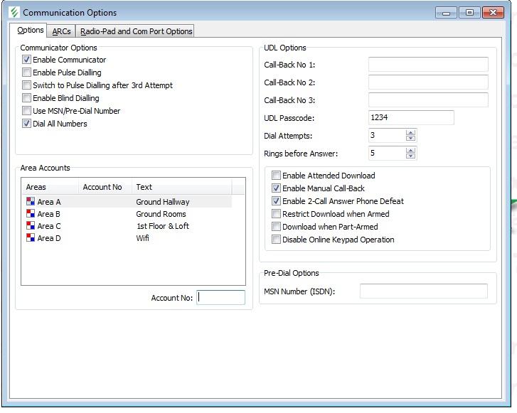

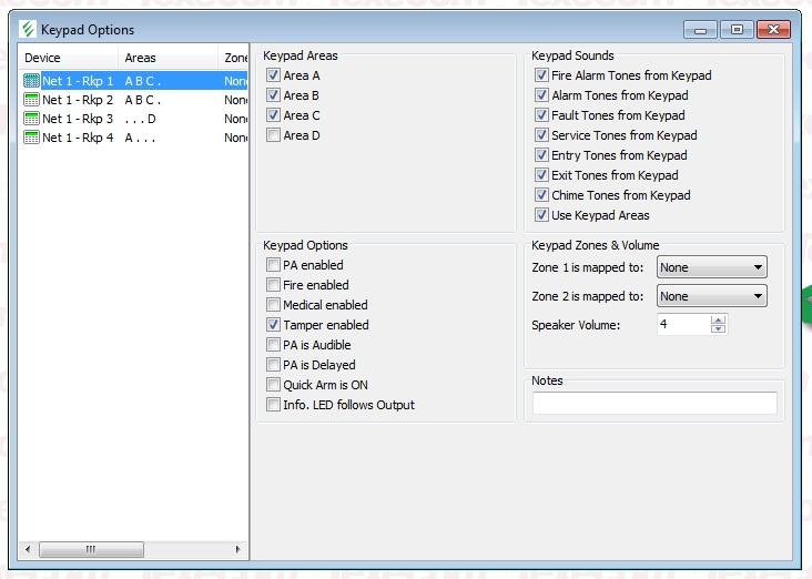

Also, Ive attached some screenshots of the Wintex programming, can you please give me some guidance if the programming is correct i.e. Zone 1 which is the Ground hallway what features should I select and should this be the same for all ground floor PIRs. (Ok looks like I forgot to take a pic of the Zone areas but heres a screenshot of other settings)
KeyPad Options
Expander Options

Comms options
Comms Options ARC
Comms Options Radio Pad

Try making the expander number 1 on the data line.
Looks like keypads and expanders are seen differently.

Think the rest looks okay.

Ok over the weekend I had another attempt and changed the dip on the expander to 1.
It now recognises the Expander on 1 and RKP 1 and 2 all on seperate networks. Still no joy in connceting the devices up.

1: GSM com fault 2
- I went through the paper work last night and double checked everything. All it says is go into UDL/ DIGI options and make sure Com 2 is set to GSM module. Also under options make sure its been enabled and protocol being used is SMS and primary number is my mobile. Theres two molex connections on the GSM module, one with 2 wires and one with 4 wires. Ive connected the four wire one to com2. Still no joy
2: ATS fault.
Not sure what that is.
ATS is fail to comms with ARC alarm recieving centre so its still set up to try and dial them. Remove all signalling apart from your mobile number.
Try the 2 wire?

After contacting Texecom Technical yesterday who were very rude and not willing to help at all, never answered any of my emails so thought let me call their technical support. Not much help so had to be very persistant and the end result is I may have a faulty GSM module. As my signal is continously on -113 Im not getting any comms going with the GSM module hence the error message Com2 Fualt and ATS error message.
I know need to contact the place I purchased the item from and see if I can get this returnered/ swapped out considering its been 6 months already when I purchased it.
