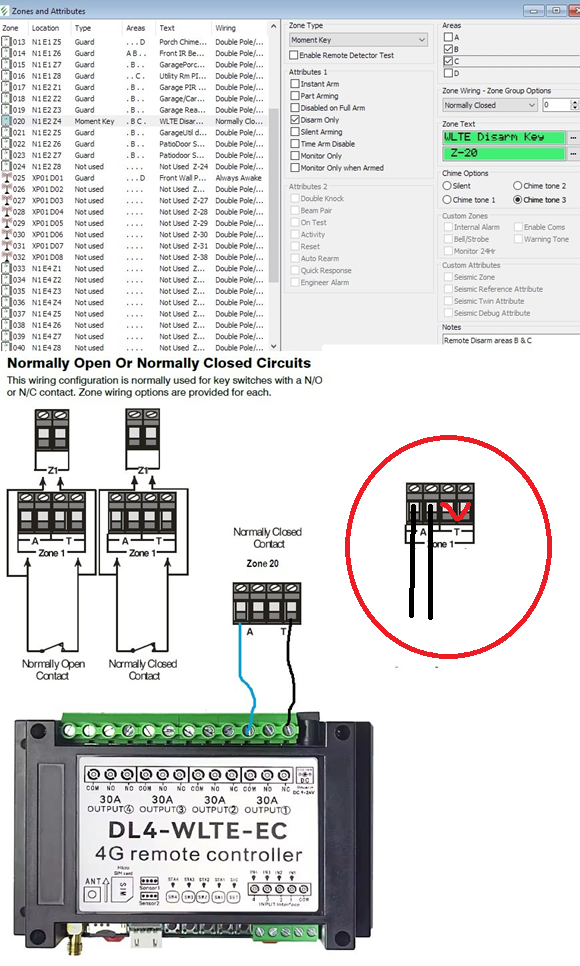

I have a remote controlled sliding gate on the road side of my driveway. It is a busy narrow road and on a bend so a dangerous spot to wait and reverse onto my drive.
Almost two years ago I fitted a 4 channel 4G remote relay box, a DL4 -WLTE-EC so I can voice activate it from my car when I am two minutes away and the Gate is open when I arrive allowing me to quickly reverse in.
Once on the drive I remotely turn off the alarm before opening the garage door remotely. During the day this is very convenient.
That convenience is reduced after a certain time as my drive alarm beams are automatically made live so I have to be careful how far onto the drive I reverse.
For some time I have been pondering disarming the alarm a few seconds after operating my gate and then soon after opening my garage door. The WLTE seemed ideal for this.
In my mind it was easy. All I had to do was program a zone to be a Keyswitch. Pulsing the WLTE relays is adjustable for time as well as momentary or latching.
I mistakenly thought a keyswitch would work just like a magnetic door sensor and just use the two zone contacts.
Today I realised that is not the case because no matter what I did I could not get it to work. My simpleton idea was that a four wire device was just a pair of contacts and a tamper loop. After delving deeper in the manual for the keyswitch the drawings didn't make sense with my understanding of the detection devices. Without the wiring diagram for the panel connections it was hard to understand how one could just connect one contact to one side of the tamper. That is what the drawings seem to be suggesting. Of course I could still be misunderstanding hence this cry for HELP! (Please)
I have attached a drawing that shows a screen of Wintex. I have four areas. A is the drive beams, B is the perimeter, C is internal and D is only used as chime. Although A is timed it is only live if B is live as well. At night when occupied, areas A and B are live. C is only additionally live if the house is unoccupied.
So my questions.
1. Do I have to connect Zone 20 contact to the tamper as in my attached drawing? If not then what am I doing wrong?
2. How long in seconds does it take the alarm to disarm after the keyswitch has operated? The messages from the smartcom seem to come a long time after the switching. I can of course test it when it eventually works

Can you see the zone go active? When looking at zine status.
You don’t normally program zones with multiple areas on the Premier panels, that said it should be okay for disarming zones on a key switch if I recall correctly.
Momentary switching has to see off on off.
The event log will show the time the panel registered the event, the app notification has to be recorded by panel sent out by smart com to server, interpreted and sent back out, your phone then has to pick it up, anyone of these with a poor connection can increase the delay.
You need to see how long it takes from activation to phone receiving some events.
A long time means absolutely nothing to me, a watched kettle never boils, or feels like it, but you find the water temp of water put in may affect it a little as it has harder to work.
May want to check arming modes when rearming. Also you have it down as disarm only so how you rearming it?
As you can program the time, using latch and have if off for x seconds/ minutes and then revert back, it should rearm.
There’s possibly other ways to try, but not sure things are programmed right to start with.

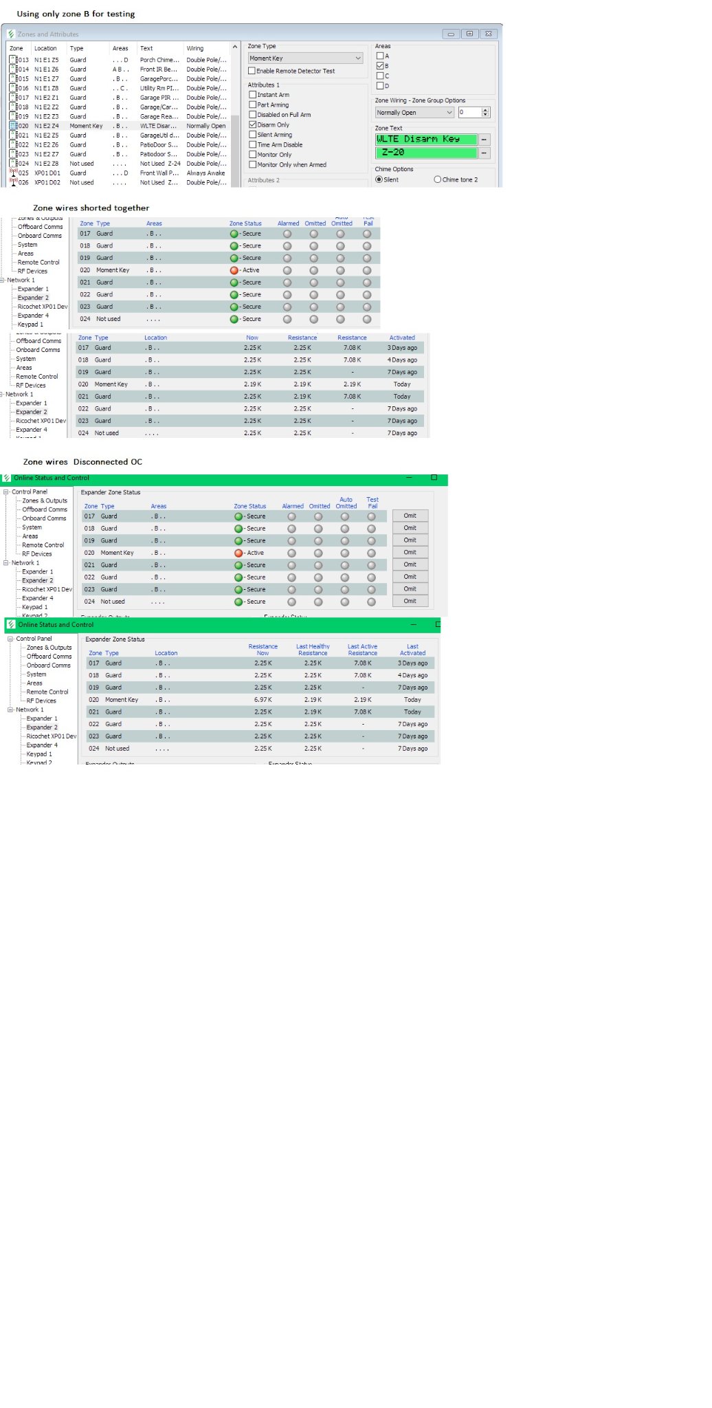

I can see the resistance change in Wintex but the zone status doesn't change. The resistances are not similar to other zones. From your reply I get the impression that my original theory of how the zone 20 switching should work was probably correct. So with that in mind I did more research and discovered that I probably need resistors as in EOL wiring even though I am using double pole. Your opinion here would be appreciated.

What values are you getting for state change.
closed should be 0 and open greater than 65K (using wintex or keypad to view), other values indicate wiring issues possibly.
33k isnt uncommon when the wiring isn't right.
In your case sounds like your using the areas correctly, ie as AND, but far from the norm and if that is working as you expect then fair enough, it isn't the norm and probably a first time I have seen an example of it being applied that way.
can’t see why you need resistors. Closed circuit 0 ?
Open circuit ?
From the relay measured with a meter?
Zone set to NO, showing active, cable Open circuit, 7.08K. Tamper linked in expander.
Zone Set to NO, showing active, cable Closed circuit, 2.19k. Tamper linked in expander. other zones showing 2.25k or 2.19k.

Difficult to use a meter as there is a 1.4vdc across the zone contacts.
After several attempts with different settings in Wintex it seems that being active or secure is random. Which makes me think of electronic floating signals that change with the wind. Maybe that is why the resistors are needed to pull up or down.
I don't have the WLTE connected at the moment as that needs more programming so I just have a cable running from the expander to this room where I am testing from. The cable has a momentary push switch connected NO.
i don’t think this is wired correctly.
Firstly normally open, normally closed, eol settings are measured across two terminals, on a keypad zone and external expander first Alarm terminal last tamper terminal. Double pole is not possible on the internal expander that can be used on the 24, as it’s a zone and common only.
Your wiring is double pole, ie first two alarm pairs and tamper pairs linked out.
The resistance is interesting as what your saying is your getting 2k2 end of line and 4k7 for an activation totaling 7k, so that setting would normally be double pole /eol wiring type.
So check wiring is correct first.
But do think we have the full picture of what your currently doing so ****ing in the wind a bit.

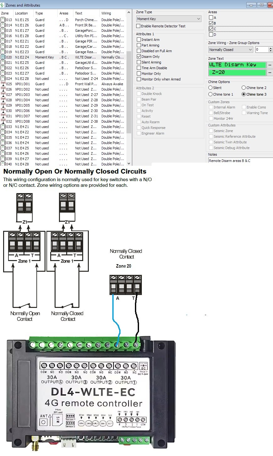

In my first post I asked if using the tamper wiring in my example drawing was correct. I asked this because I was unfamiliar with that configuration of wiring a zone to a tamper. As you did not answer that directly or refer back to my drawing I assumed that you agreed with my suspicion that I was mistaken and therefor reverted to standard double pole wiring as used on all my other devices.
For clarity note that only zone 20 has the tamper currently linked out at the expander and this is the area I am concerned about.
Your recent comment quote "on a keypad zone and external expander first Alarm terminal last tamper terminal." was my initial question as per the original attached drawing so I believe now that you have confirmed my first drawing zone 20 wiring. It is late now so I don't want to wake the neighbours if I get it wrong but will try the "external expander first Alarm terminal last tamper terminal" on zone 20 sometime tomorrow (or later today as it may be by the time I complete this post.

the drawing is fine, but the drawing isnt what your saying, your drawing, circled in red what your telling me, tamper linked out!
Unfortunately I can only go on what you supply, when your written description does not match your drawing.
This is why I don't think it is wired correctly. Maybe it be easier to take physical photos of what you have?
I have interpreted what you have said and drawn a diagram based on that and put it aside your original drawing.
Alas I only have your word for what you have, as for the examples, again without specifics and images I have to assume the information you give me is 100% accurate, but when your drawing and description doesn't match then i have to question do you have a metal 48 or a 48-W or a 24 (yes you be surprised how many believe they have something different to what they actually have, just because a label says so, usually people think they have better than what they have, usually ebay purchase), the hard wired expander should be an 8XP and not an 8X or an 8XE.
I personally have miss wired zones, got one leg in the wrong terminal shows up as strange value, usually on pir end because of how its being viewed and thought it was in the correct place, zone behaviour and resistance values tell me otherwise.
The resistance value is important, as it tells me more information, wires have minimal resistance a few ohms, your quoting values that suggest resistors are fitted (of 2k2 end of line and 4K7 alarm) yet using normally closed and normally open wiring types which don't use resistors. and get 0 closed and >65k open showing on the alarm panel.
Nothing wrong with your drawings hence why didn't comment on them (but you have examples of two terminals per zones and 4 terminals per zone (image from manual I guess). But your telling me you have something completely different to what is in the diagram.
not overly convinced my interpretation of your description is what you have, as not convinced you would get those resistance you are quoting without it being connected to a device with resistors fitted.
so I guess you have addresses 1,2 and 3 and as its hard wired zone 20, that will be address 2, and wired into zone 4 on expander address 2. I don't know that for certain but that's what your telling me.

Your interpretations are generally correct. The only thing that wasn't definite is why I reverted to the incorrect wiring. My misunderstanding due to the non confirmation of my initial drawing. My apologies for that.
So the good news.
It is now wired correctly on the expander and using my temporary disarm button it electronically disarms in probably less that 1 second. So I can afford a few seconds wait time when I get my WLTE wired in again. The disarm is also shown in the log.
I am all set to continue now. Again many thanks for your help and patience.
