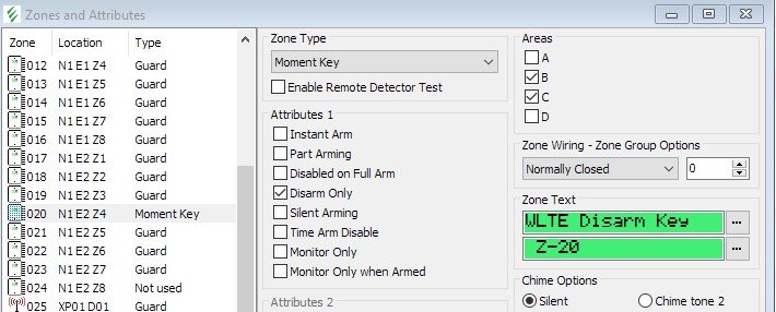

The following is referring to Wintex 8.2 on my Premier Elite 48, Zone 20 (N1 E2 Z4) on a wired Premier 8XP expander.
My Alarm is based on Areas (groups of Zones) rather than individual zones and uses 4 wire double pole wiring to every device. I pair for Zone and the other pair for tamper
A spare zone is used to detect the Status of the switching event which could be a latched or momentary.
Momentary detects the change of status rather than the end condition. So, Off to On and Off again or On to Off and On again.
Which method you choose needs to be reflected in the particular zone used attributes section under "Zone Wiring - Zone Group Options"
In my case I used "Normally Closed" so my relay or switch would need to break the connection and remake it. If timing is an issue I suspect electronically the event would be instantaneous but 1 second (or 2) is probably more reasonable or it will not show in Wintex.
When I arrive home I need to disarm areas B&C (2&3). These two areas are selected in Zone 20 Attributes along with "Disarm Only". I don't need it to rearm as I will do that from the panel or a Smartkey or Smartcom when I need to.

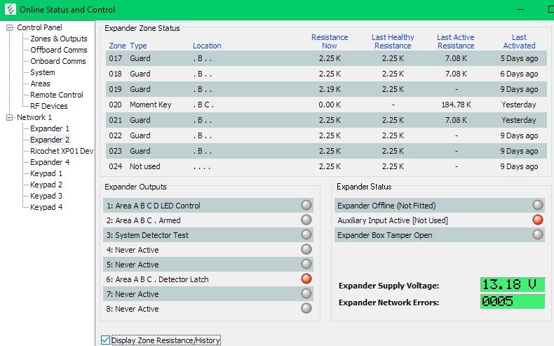

Using Wintex Diagnostics looking at Network 1, expander 2, my zone 20 is actually zone 4 on the expander.

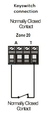

When I looked up the wiring for a keyswitch in the manual It was confusing. it seemed to want the tamper loop open circuit and partly connected to an open circuit zone contacts. My understanding of zone wiring was a pair of contacts and a Tamper always closed loop. Without a circuit diagram and no knowledge of internal components I could not work out how that could be correct so I wired up the zone contacts as for a normal door contact. No amount of programming changes made any difference it would not work. The resistances shown in Wintex were confusing as sometimes Zone 20 would show as active with 2.2k and other times active with 7K. Neither one would disarm an area. I checked the zone contacts with a multimeter to double check the Wintex resistances but that was not possible as there was 1.4v across the zone contacts.
With the kind assistance of "Secure I AM" it was confirmed that the Keyswitch.jpg picture was the correct way to go.
Normally closed resistance is now 0.00K as expected and active resistance is 814K.
There are no additional resistors used on any of my devices.
The disarm now works perfectly and reliably

The wiring was incorrect for the wiring type chosen, ie wired double pole but using normally closed.
