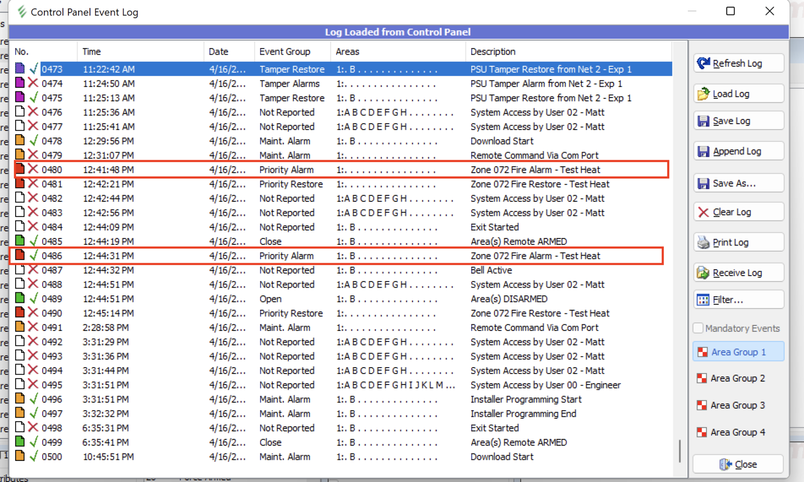

Texecom Exodus - keypad sounds - bell doesn't
Just had a look at the logs which show something interesting. When disarmed the heat sensor activates and shows no area - when armed it does show the correct area and you can see the bell is triggered. See attached. Does this prompt any ideas? This actually seems to be the case for everything that triggers when not armed like the tamper when I open up the psu200xp.

that my explain what is going on, I just had a lok at the one in the office for the tests conducted on 10th January and the area is showing in the log when it activated unarmed.
you can power cycle the panel and default he reporting codes. I could look at the profile in full and see if can see if there is any differences if you email to me. In my case it was in rea A on the 168 and was zone 14 but it was a wireless smoke.
Okay. Power cycle I can do. Sorry to sound stupid but how do I default the reporting codes?
you can do it in wintex and send cross reporting codes or you can do it in engineer utilities and default NVM data, scroll through to default reporting codes then yes
I am shocked - I did a power cycle of the panel, pulled the fuse and the battery and now it works as it should. Just activated the zone when unarmed and the external sounder worked!
