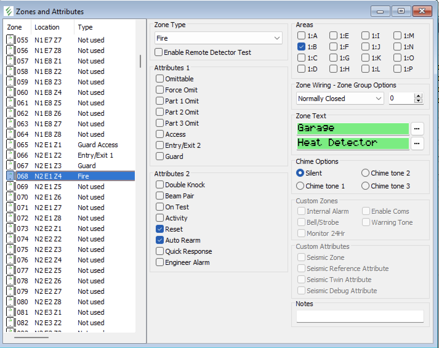

Hi - another day another question - thanks so much for the help and all the info on the forum for helping to get this far.
I have added an Exodus rate of rise heat detector in my garage to a PSU200XP expander panel. The Odyssey X3 is also wired to the expander as is the keypad.
When I simulate an alarm from the Exodus heat detector (disconnect one terminal as set up as normally closed) the keypad sounds which is good, but the external bell does not. I had expected it to give of a distinct alert. I also notice that there is no alert on the Texecom Connect app.

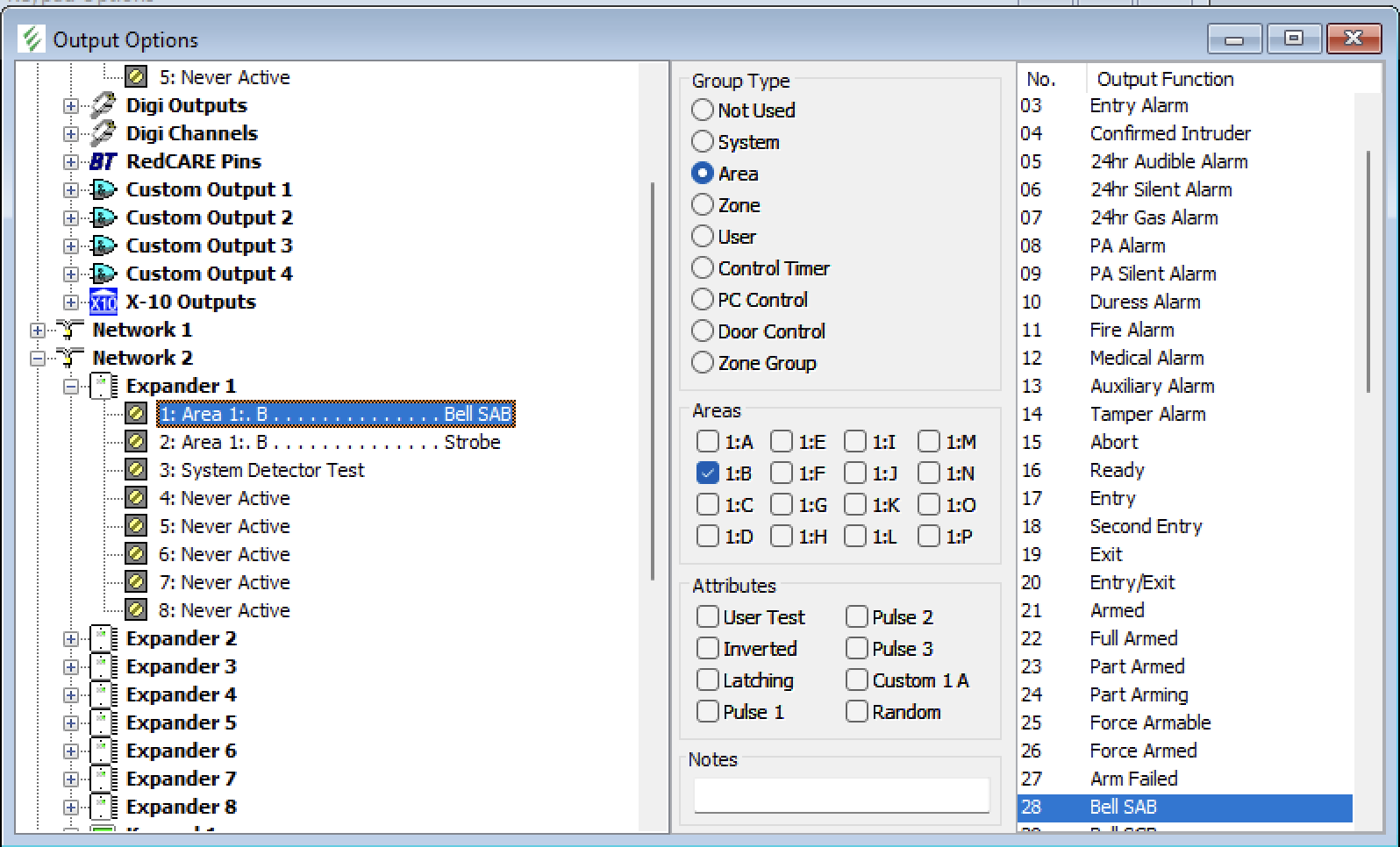

The zone is set as fire, the bell is wired to an output and set as Bell SAB, all are set to the same area.
I have checked and the external bell works fine and alerts are received when there is an intruder alarm, just not fire.
Screen grabs of outputs and zones from Wintex attached for ref.
Any advice for what I might be missing appreciated.

Area ….unarmed fire comms ….and check speaker tones …for fire ….the normal setting is bell pulses on / off when fire active
Thanks very much - I have found the unarmed fire comms setting and have enabled.That should sort out the alerts on the Texecom Connect app which iw ill try to test soon, thanks - any ideas about why the bell connected to the expander output isn't sounding on fire? I'm not sure where to go as per your comment "check speaker tones …for fire ….the normal setting is bell pulses on / off when fire active". If you can point me in the right direction though I would expect this to already be set up for external sounder??
it should follow the programming, there was/is a fire delay option couldnt tell you without looking.
it does sound different from the normal tone when it activates.
I have looked and the delay is set to 0. It's not activating any tone from external sounder, though yes, I was expecting a distinct one. I have left it for ages to see if it was a delay but after many minutes of the keypad alarm going off the external sounder stayed silent.
I would put the zone to not used and then back on again as fire via the keypad, this is a 640 panel if its till not working.

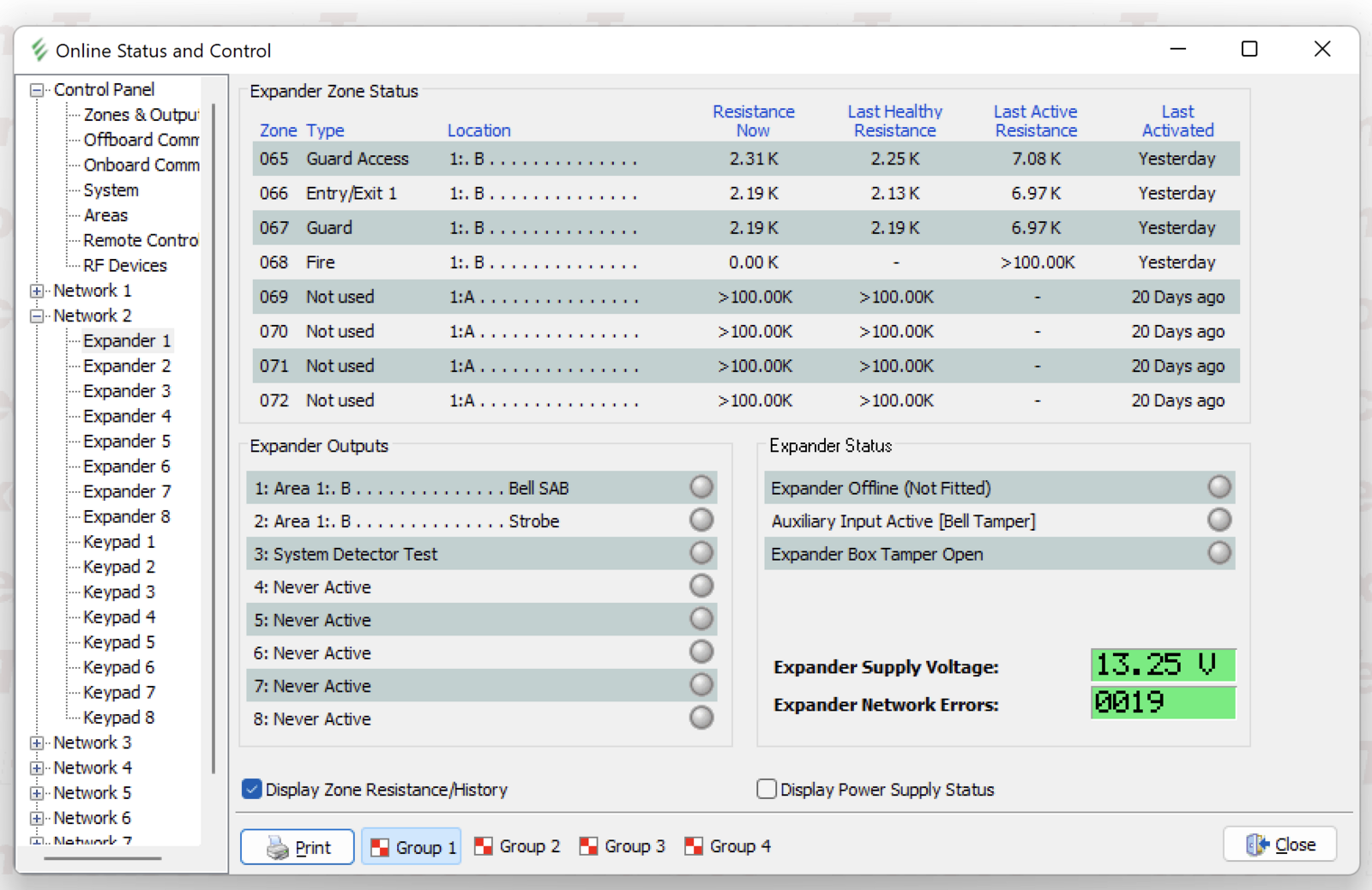

what is resistance showing for the zone?

Resistance 0K, last activated >100K. Just connected as straight NC until can get it working then may add resistors.

he looked at turning the attributes off in the fire zone although this shouldn't be needed and it was a relay firing the zone and on a keypad and we could see the zone switching state in view zone status
