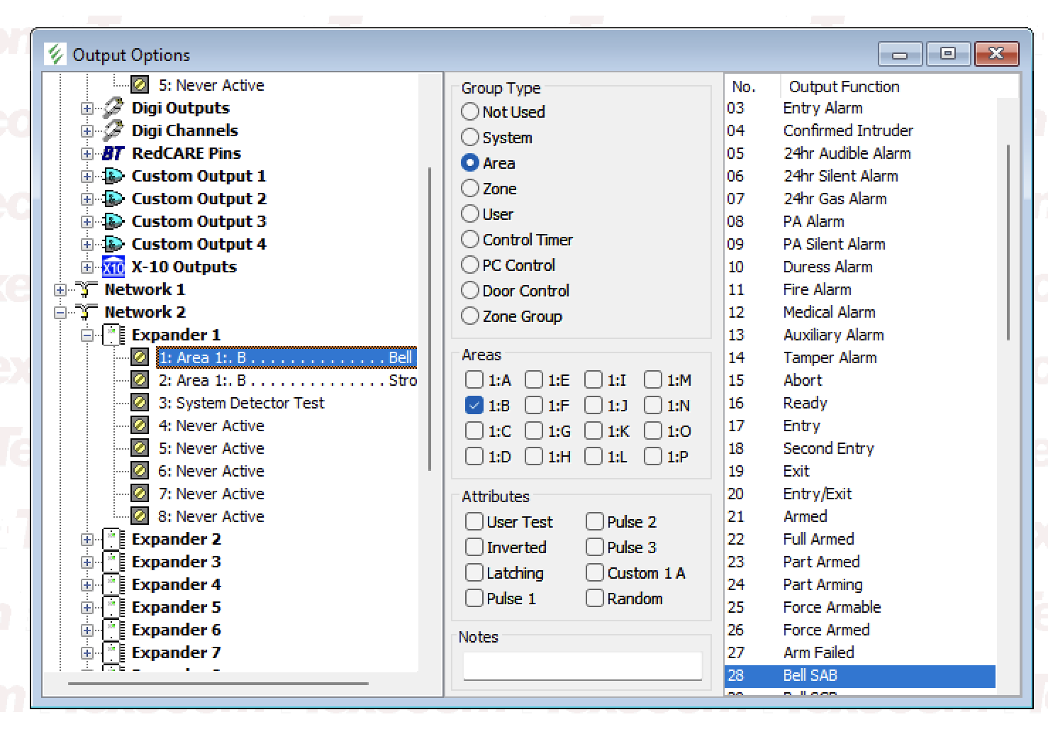

Just done some more testing. If the intruder alarm is not set and smokes activate, the keypads sound, the external bell does not. If the intruder alarm is armed and the smokes sound - the keypads sound and the external bell DOES.
So do we only expect the external sounder to go off when smoke is detected if the system is armed??

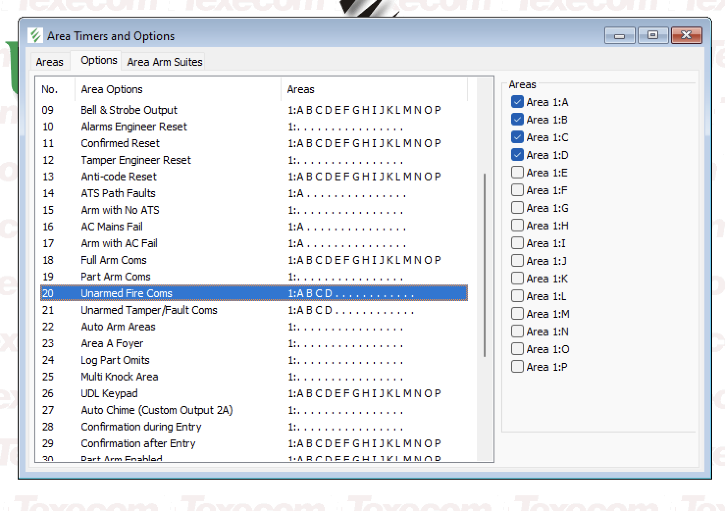

what firmware, what area have you go things et for unarmed fire coms, and the smokes etc etc etc

Am I correct setting the expander output to the bell as: Area, Bell SAB. Or should I be using ‘Area, Alarm’.
Elite 640 V6.02.02 LS1
All set to area 1B.

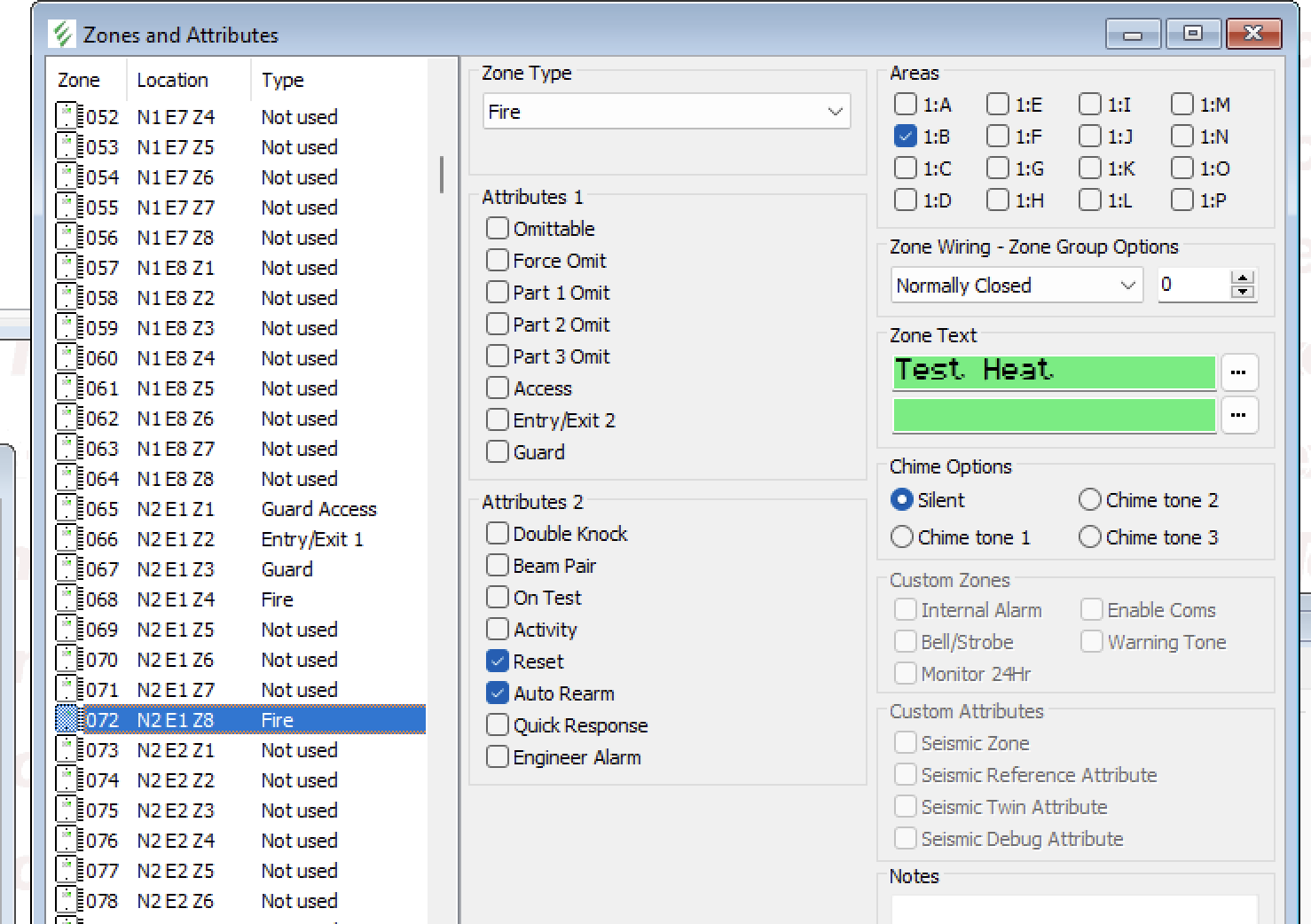

Screen shots attached if they help.
Comms issue solved after "unarmed fire coms" selected for area - so only remaining issue is that external bell does not sound when unarmed and smoke triggers, but they keypad does sound so system knows about it.

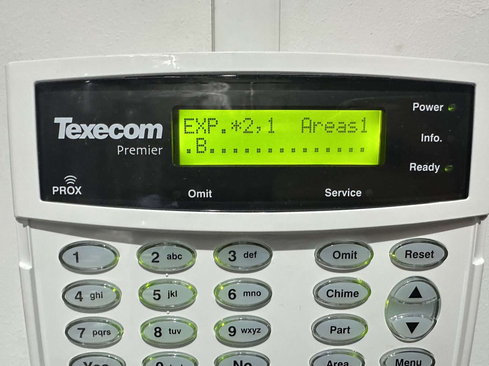

out of interest, if you use the keypad and go to expander setup (5), what area is the expander setup for?
Good question, that theory should be it follows the panels SAB programming if down as SAB.
you could attempt to do as a custom output, bell sab or fire alarm
do you think this is the issue? would it explain bell when armed but no bell when not armed? I did set the area for the output.
B - see attached
