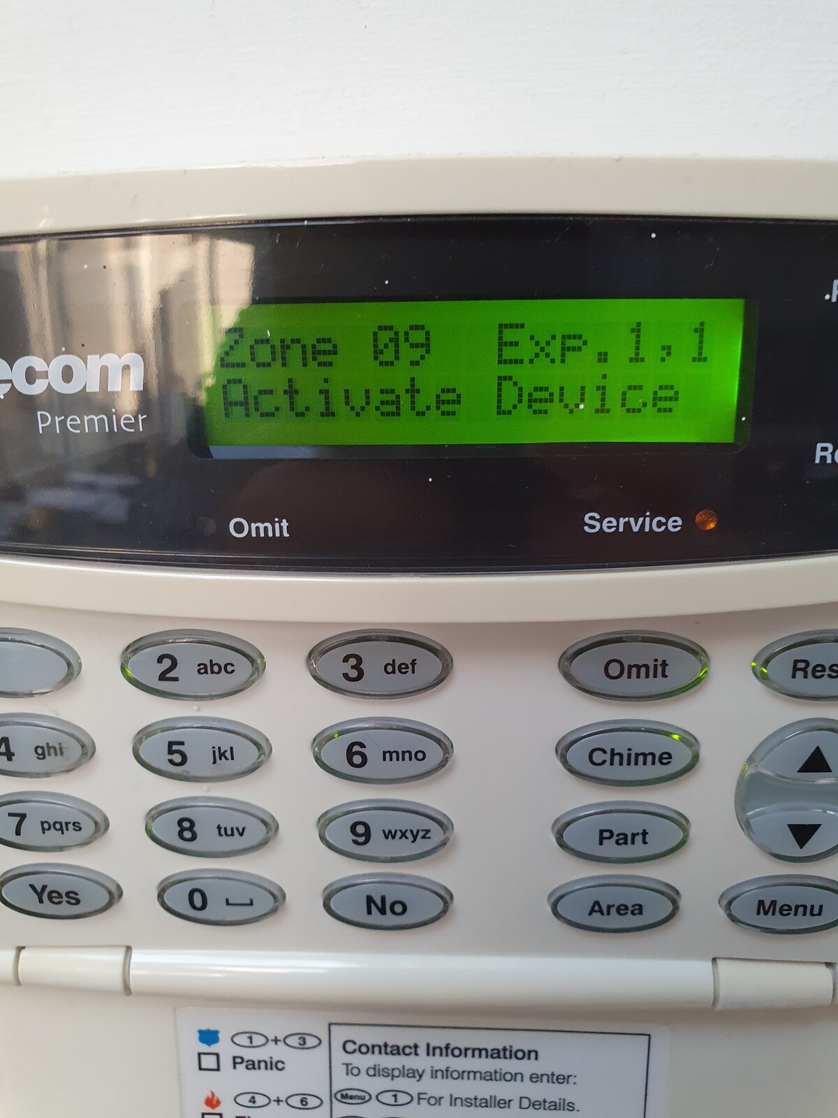

Hi
Hopefully a simple question for someone in the know.
I want to set up one of the zones as a Keyswitch, which reading the manual would appear simple enough!
I go to the 'Zone setup press yes,
then presented with Zone 1, i can toggle between each zone no problem. However the text under the zone number should read as the zone type, and by pressing, 'No' i should be able to toggle through the zone types. However the text under the zone number reads 'Activate Device' and I cannot get further than this.
I have searched but can find any reference 'Activate Device' in relation to Texecom alarms
Any help would be appreciated
Menu 4 on the keypad for panel and version number.
at default zone 1 would be entry exit you press no and you get activate device?
whats attached to it?
Hi, Thanks for the reply
Premier 24 V8.00
I was trying to set up Zone 9 as a keyswitch to attach a Konnected Interface Kit.
Zone 1 was set to Entry Exit as you note, however the zone type for all zones now read 'Active Device'?
Post picture ...I’ve never seen that ...was thinking before you had some wireless expansion on it ...
cant find a manual for Konnected.
however activate device fairly sure that sounds like a wireless option.
so my question would be what is connected to the system in the first instance.
I could be wrong but it could have wireless expander connected on the network or on the comport possibly radio plus.

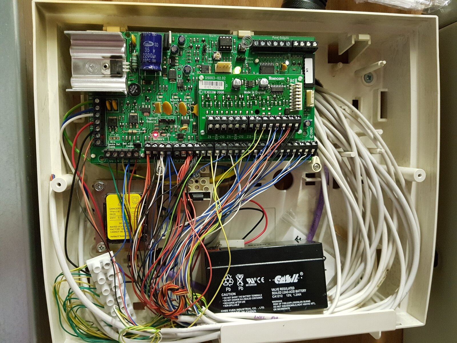

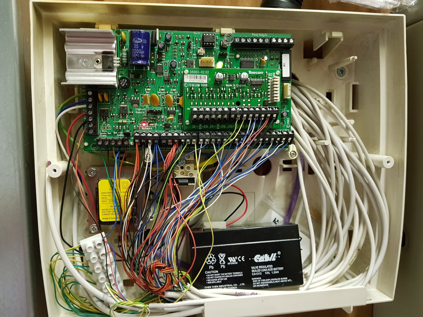

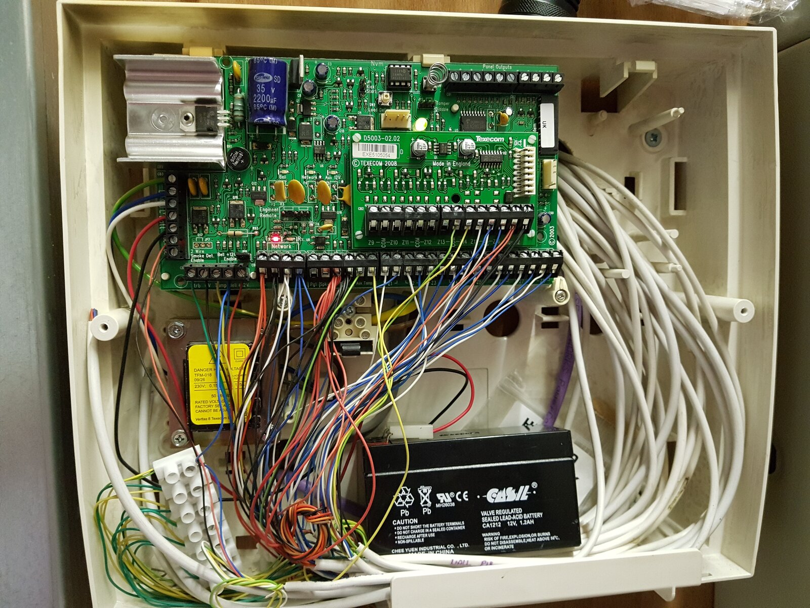

The panel has an 8 zone expander (8XE I think), and a number of wired pir/door sensors. Its been installed for 10 years and all was OK until I tried to change the zone type.
Photo attached before I added the Konnected unit
8XE is an internal hard wired expander that piggy backs onto the main 24 pcb.
age wise sounds about right as 2007 was version 8 firmware for the premier 24 and that supported radioplus back then
Can tell more by pictures of panel pcb and doing confirmed devices.
activate device does sound very much like wireless
Photo as requested
Thank you
So i would look at udl digi options, comport setup
nothing connected just to check programming
