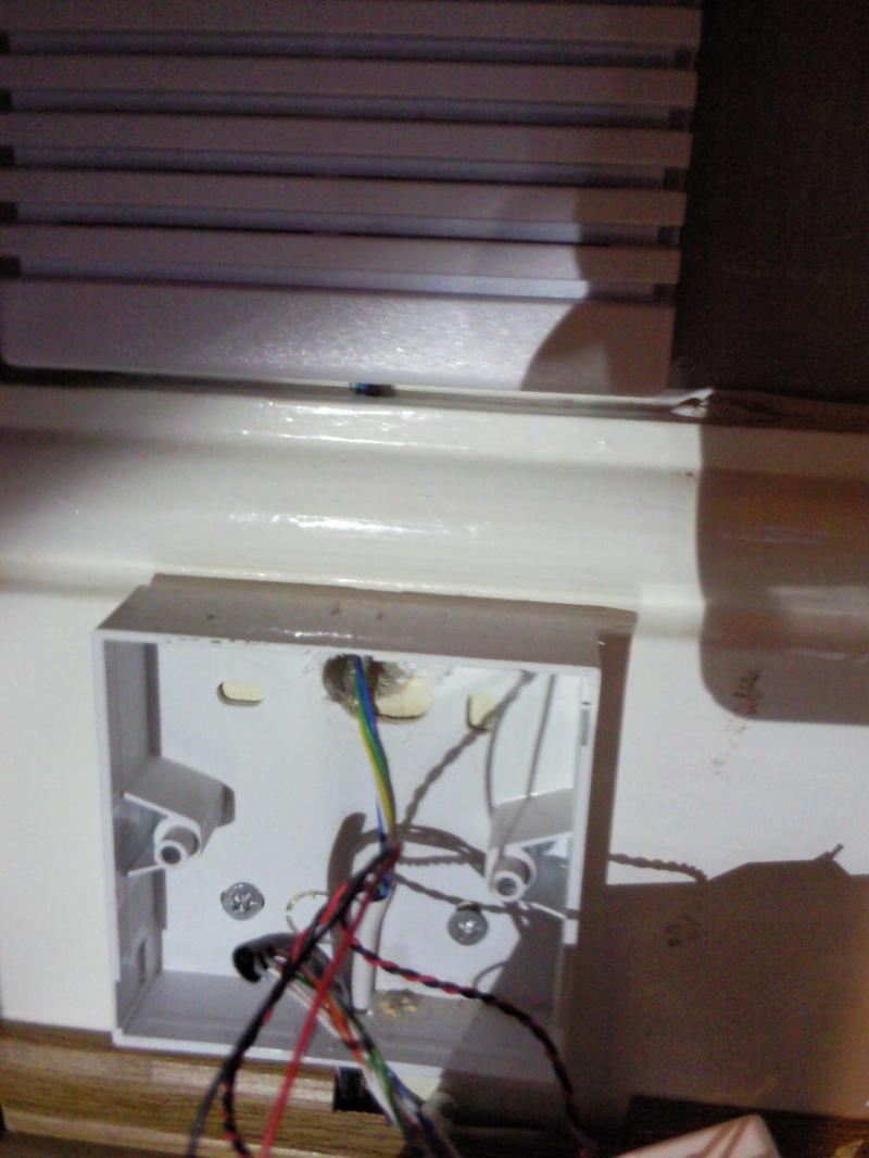

The picture below shows the NTL phone box. Above this is the internal speaker for the alarm. The installer has ran one white cable... 7 core?? i think? and all the cables go to the internal speaker apart from a red and a black which he has left in the phone box.

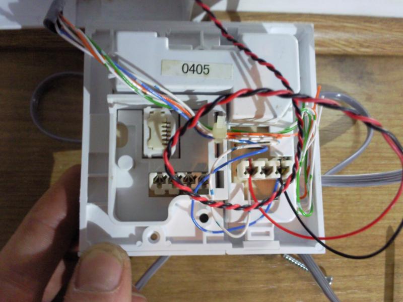

he NTL phone box, only has two wires connected to it. the wires are a white and blue stripe and a blue with white stripe. The white and blue are terminated in A and seem to be +v, and the blue with white terminated in B and is -v.

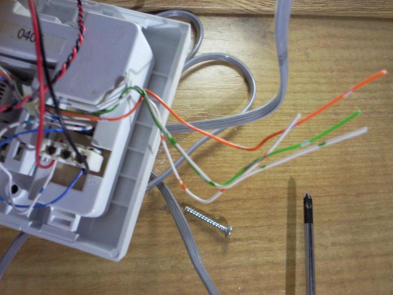

The are 4 wires from NTL which are not terminated at all, the Orange pair and the green pair. ( I have a a feeling that my red and black are supposed to connect to one of these loose non terminated pairs?
The picture below shows the whole thing.
Please note there is a terminal numbered 2 - 5, presumably for the 2 pairs that are not connected? Also in the picture i have connected my red and black up to the blue pair, a & b........ which did nothing!
so you have done what i said, connected them to 2 & 5. now what about the other end, what is the red and black connected to?

I have connected it up to the 2 & 5, and nothing happens.
Not too sure what the rd & black are connected to at th other end, i presume they are connected up to the correct ports.
