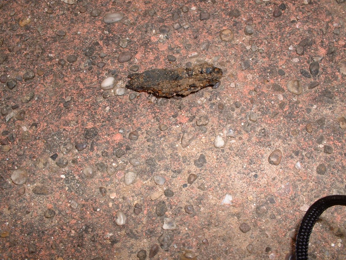

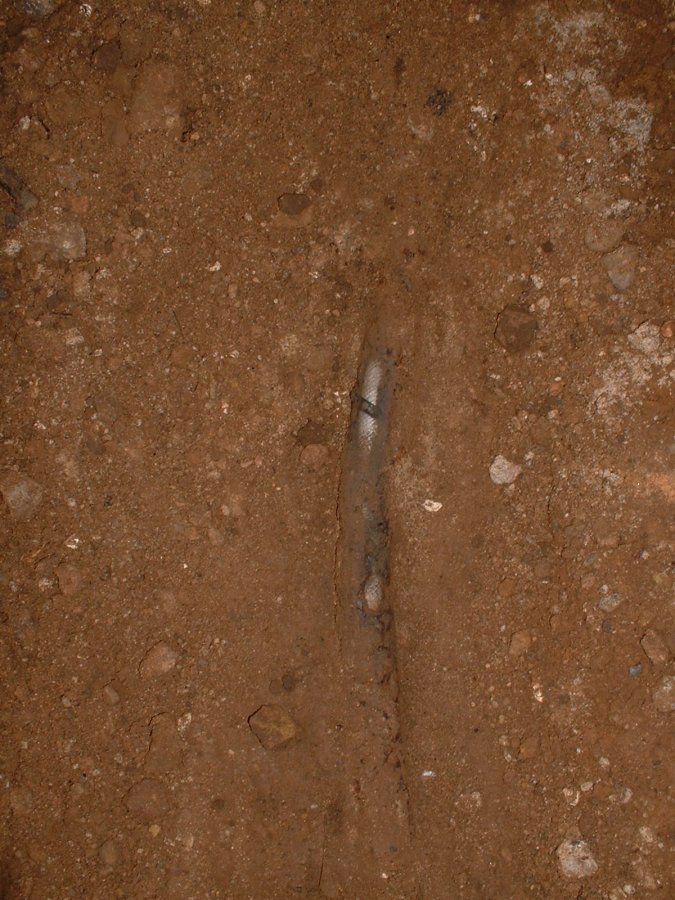

Okay, this morning I've done a recce, to see what we've got.
As you see I've managed to dislodge some pieces of the outer covering of the cable in two places. Picture 02 shows a general view of the cable, and picture 02 shows a piece of that outer covering.
Please note that there looks to be a cut in the cable, but that is not a cut, it was like that originally. It looks like an indented strip, but whatever it is, it's been like that since the cable was put in.
There is no other physical damage to the cable. The issue is, is the cable vulnerable to moisture ingress due to that chipping seen in the pictures of the outer layer. Looks like maybe I should phone up my service provider, but I'm scared silly of how much it might cost me. Rich
My feeling is that there is some damage, but it's possibly fairly trivial, but having said that the cable could do with some self amalgamating tape wrapped around the damaged point. I'm hoping that is the (limited) extent to which the DNO might address the issue.
You're sure that's your supply cable?
If it's your supply cable you simply have no choice.

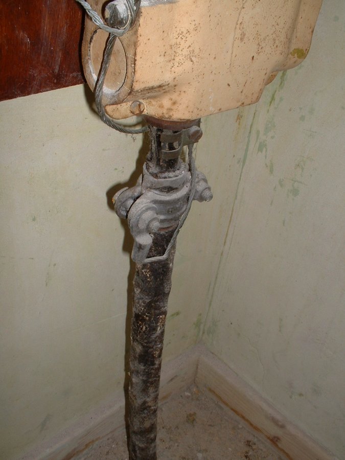

That cable will be my mains supply cable. Here is a shot of the cable that enters my termination box in the home. It's the same diameter as the cable outside. It's about 1 1/8" diameter
What I'm concerned about is the DNO only doing what is required and not doing work that is unnecessary that costs me an arm and a leg.
It looks like the cable construction is:- an impregnated (cloth?) outer, then a non ferrous tube (looks like with a seam), then wire armoring, then I think another tube, with the conductors inside that.
The first outer metal tube/sheath is not lead. It's harder than lead.
I'd like to know if it is significant that I've two small parts of the cable that are missing that outer layer. Anyone know? Other than that there is no further damage. Thanks.
P.S. If you were in my shoes, what would you expect the DNO to do?

... What I'm concerned about is the DNO only doing what is required and not doing work that is unnecessary that costs me an arm and a leg. .... I'd like to know if it is significant that I've two small parts of the cable that are missing that outer layer. Anyone know? Other than that there is no further damage. ... P.S. If you were in my shoes, what would you expect the DNO to do?
As I understand it, the supply cable is very much their property, and for them to 'maintain', at there cost - so, if they deem that the condition is such that the cable needs replacing, I think they would do it without charge to you.
I suppose it might be different if they claimed that you had damaged it (e.g. by putting a jack hammer through it!) but, from what you have described and shown, I think that the only damage, if any, is probably that due to the passage of time.
How deep is this cable buried?
Kind Regards, John
Yet more prevarication
DIYalot - it is up to you how much comfort you take from what people here think is, or is not, likely to be the attitude of the DNO.
What is not up to you is whether you contact them or not.
Please stop posting over and over again about your same worries. You have to tell the DNO about the damage. End of.
Cable is buried about 50cm. That outer covering, possibly cloth impregnated with pitch, is pretty fragile. Bit crumbly now.
