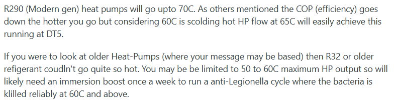

Thanks for the info, is there truth to this though:
Yes - the next gen HP's utilising the R290 refrigerant (propane) can get up to higher temps but as suggested the COP can drop dramatically and there are a min output size requirement to effectively reach those temps and as the output rises the % drop in COP increases , which TBH is the whole point. The new regs are pushing the older high GWP refrigerants to be replaced by these newer 'safer' gases. Current R32 systems are due to be phased out by 2026/27. Grants help of course but they are on a sliding scale depending on what's being fitted and these system are still really quite expensive. They new R290 does target the retrofit arena (they are more of a replacement to gas/oil boilers due to the higher temps) rather than the design of a low temp UFH system coupled with solar to augment the HW (which you already have) which I believe was the whole point of of HP. I have a client that uses a HP Vaillant system using R290, fitted last year. He also has a WB gas boiler and uses that more than he uses the HP, noise is one of the issues.
That being said these new units are exactly that - next gen and new - and as with all new tech it usually takes some time to iron out all the bugs, not sure about comparable costs of the hardware too but if grants are available. The hardware is similar though. Again, another inevitable upscale to the tech and R290 is coming online now and it's the next iteration until newer GW regs drive further change.
