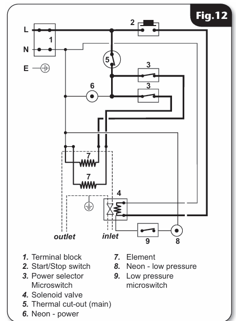

My Triton T80 thermostatic electric shower (1) low water pressure (orange display) light is always on, despite there not being low water pressure when testing. The On/Off button is correctly illuminated orange so the wiring is correct. I installed an identical electric shower (2) in the property and (2) works properly. Not sure why (1) low pressure light is always on. What should I do?

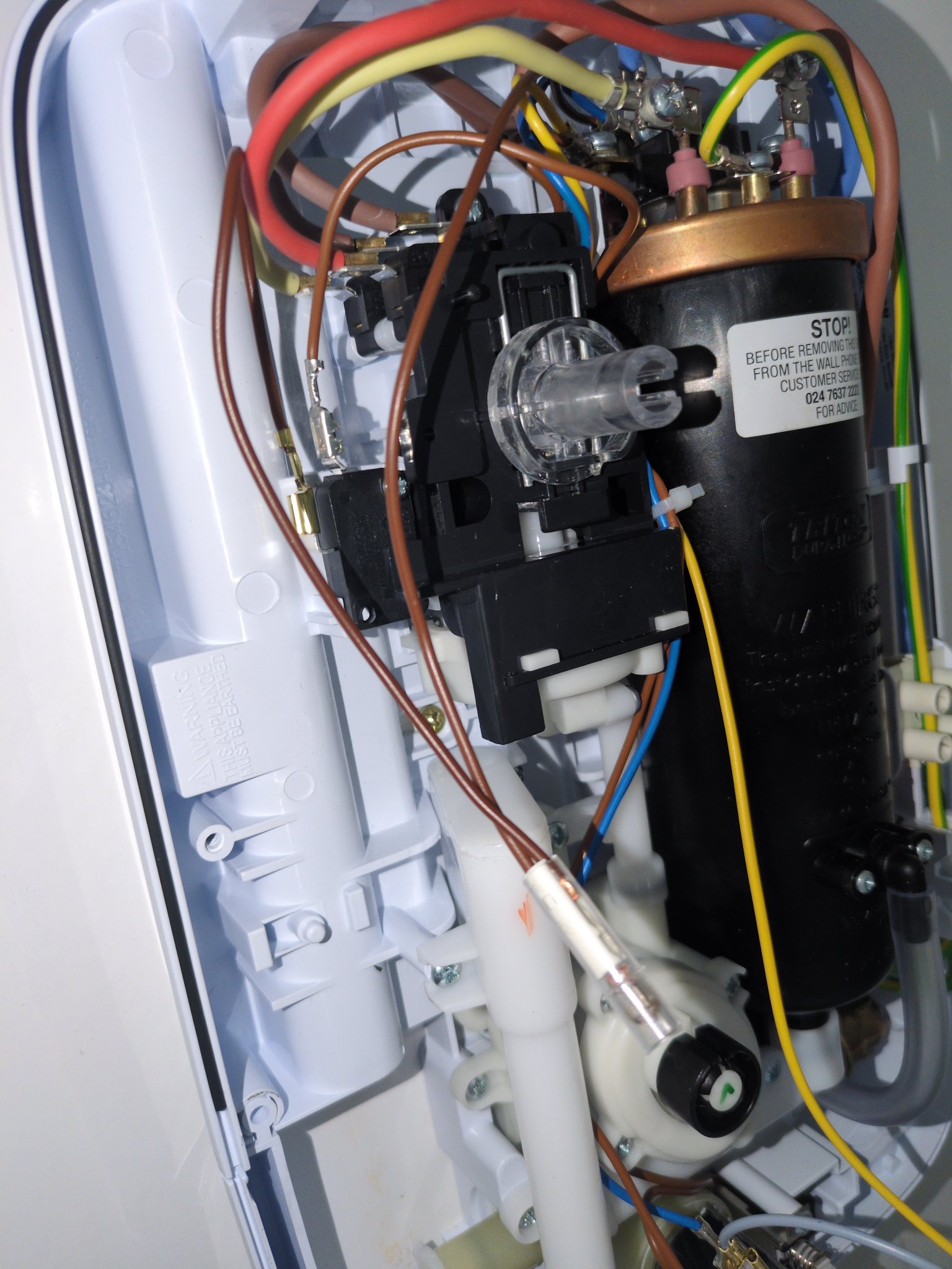

In (at least) some Triton models, water pressure acts on a diaphragm which moves a plunger upwards to actuate a microswitch. If the plunger doesn't quite reach the switch or press it hard enough the switch doesn't operate. The low pressure light then stays on and water heating is disabled.

The power indication ON neon (6) has got nothing to do with the Low Pressure neon (8), just ensure the power indicating neon is clipped into its holder every time you replace the shower cover after removing it, it is (permanently) on as soon as you power up the shower with the pull cord (providing the TCO is satisfied).
The Low Pressure, NC (normally closed) pressure switch (9) is electrically supplied once the start button is pressed and should only stay "made" with the low pressure neon illuminated for a few seconds until the pressure/flow builds up in the shower and the water starts heating. If the shower is operating normally then looks like a faulty pressure switch or the like.
EDIT: It's also possible, as suggested by @Alec_t, that the switch is diaphragm operated with a pushrod like the main microswitches, have a look if possible and post a photo.

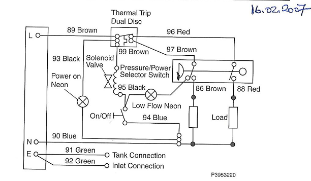

The Mira Sport low pressure neon had a much better set up, the economy microswitch had/has two sets of contacts, one, NO set, close to heat one set of elements when the pressure/flow builds up on pressing the start button, the other, NC set then opens and the low pressure neon extinguishes.

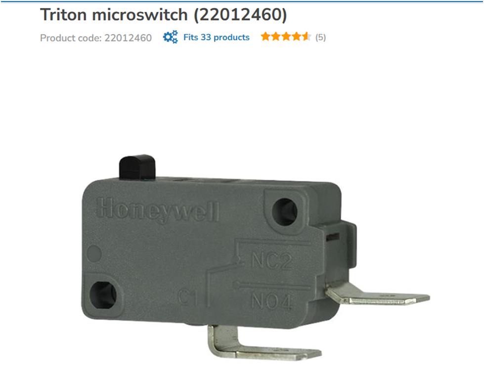

Next time the cover is removed, follow the two neon brown cables back to where they pass by a black microswitch and see how many terminals it's got, I can see two but check for a third one.
Identify the low pressure microswitch, it may be the one in your photo above, remove (with shower isolated) the wires from both terminals and you should get continuity across the terminals with the M.Meter set to resistance, Ohms, because the switch is or should be NC (normally closed), the one shown is a NO one.
You might be able to push the "switch" (shown above Honeywell on this one) in/out with something to see if the M.meter reading changes.
