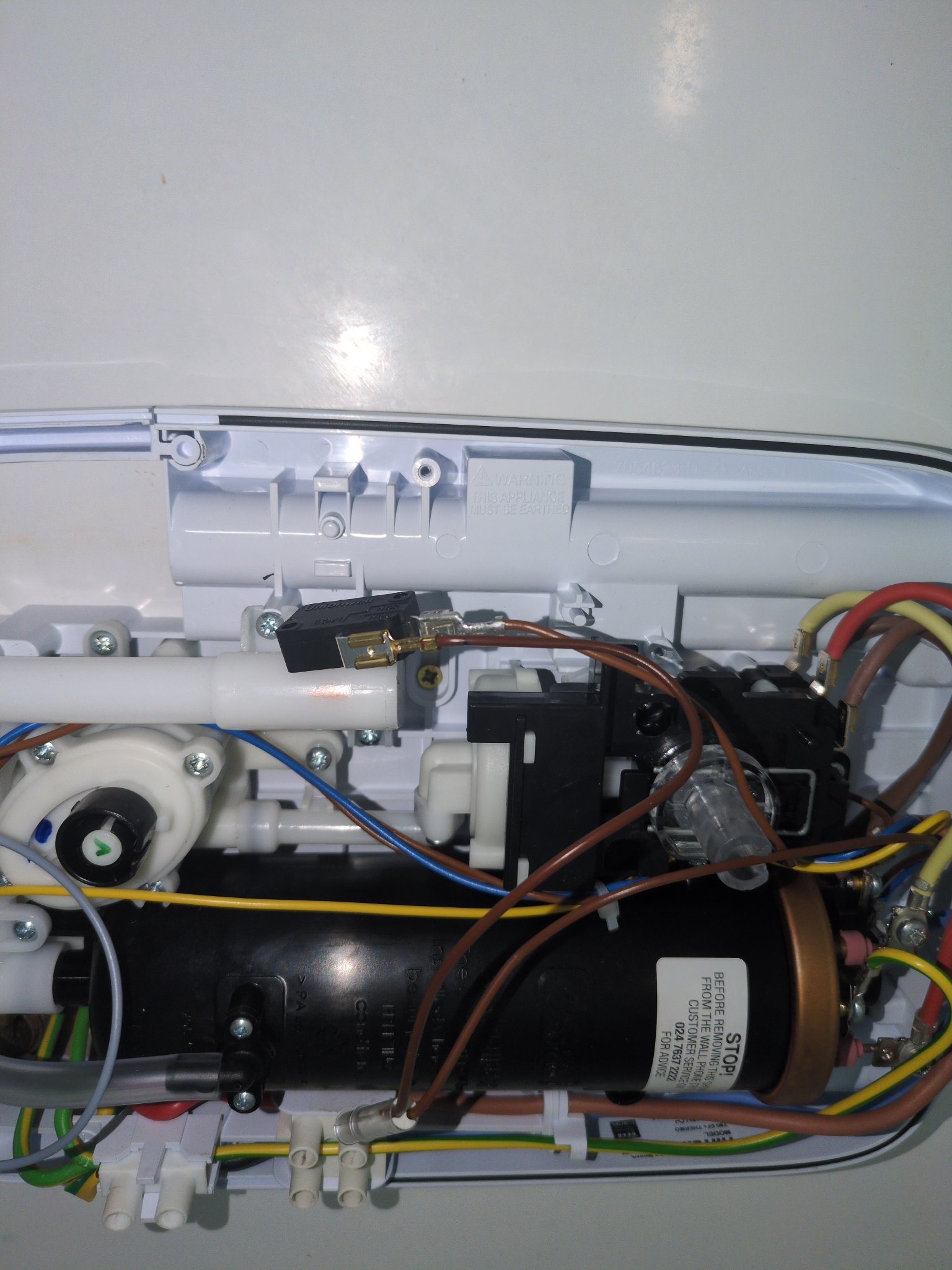

The test is, as of now, to remove the shower's front casing and see if the LP microswitch's button has been unpressed?

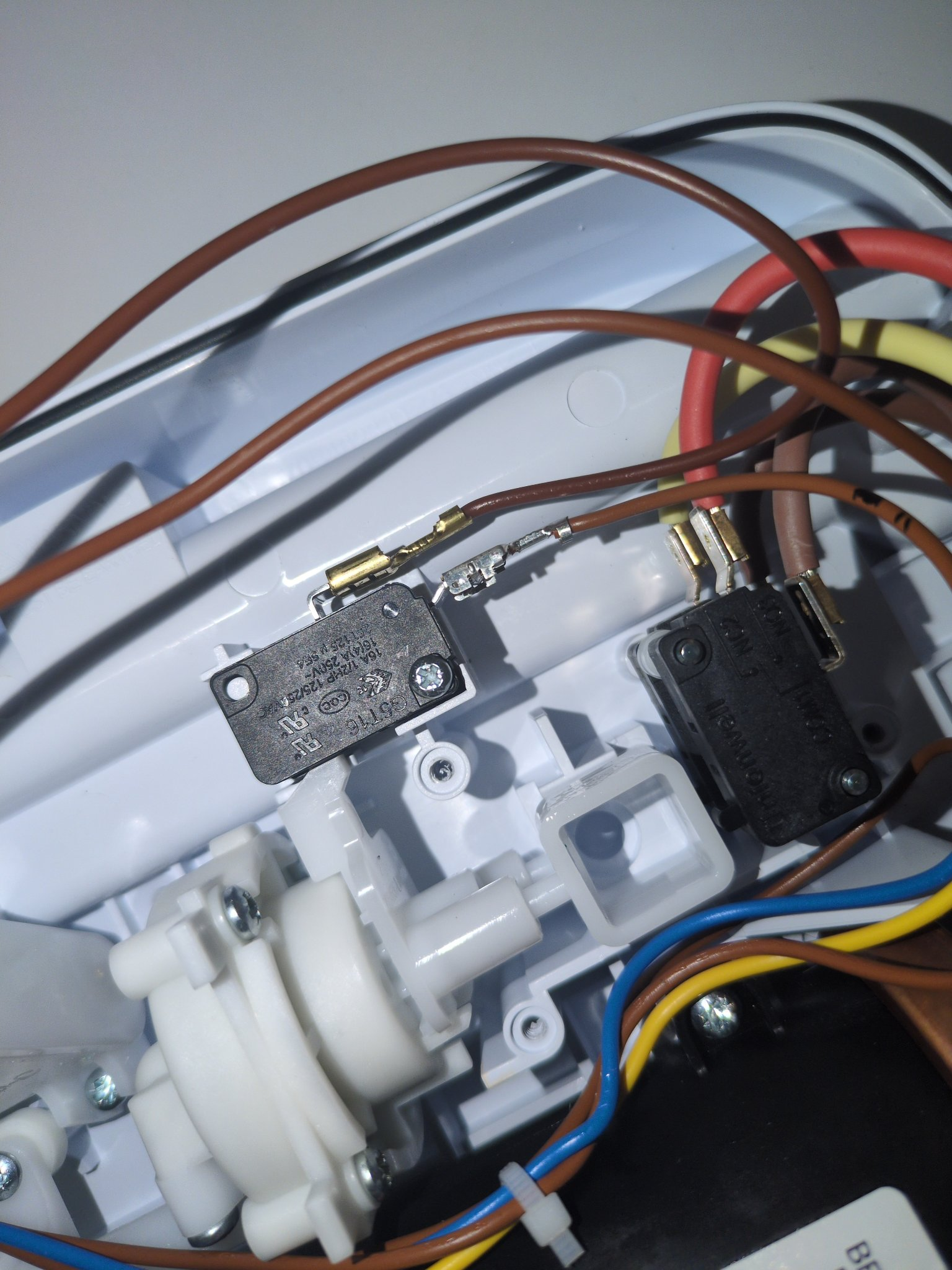

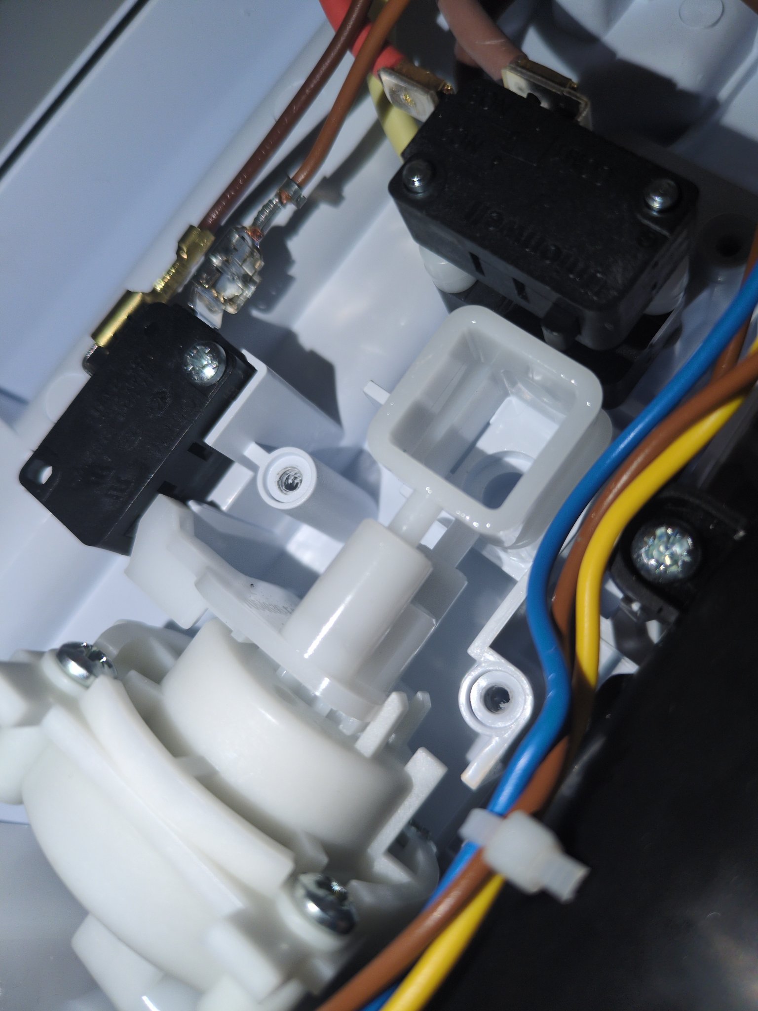

I tightened the microswitch screw very tight. The new microswitch did turn on/off at the right times (on at initial shower turn on then off after 10 seconds) then after 5 mins defaulted to always on. Seems to be a mechanical problem either the switch or the diaphragm.
All the more reason to do test as per post# 61.
Post 61 "presumably movement of the diaphragm under pressure lets the button pop out" I took the front shower cover off and the new microswitch (installed and connected, screwed down tight) did not pop out. But the shower LP light still came on
OK, as per post #57. Wires attached, switch not in its dowelled position and switch on the shower.
Whatever, as long as nothing pressing on the switch button when the shower is switched on, ie, diaphragm not touching the switch button at all.
