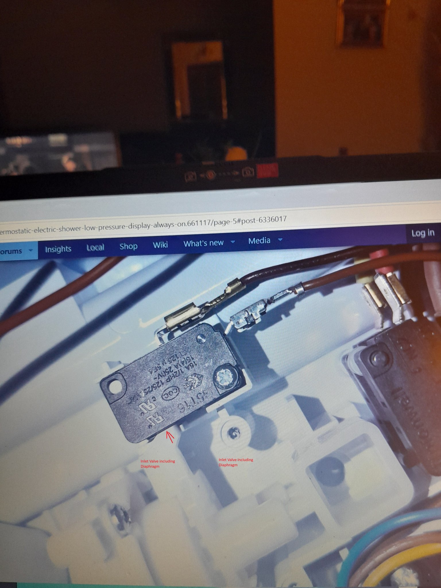

Have a look at your photo below and confirm or otherwise that the switch button is located where I have the arrow and that it (the button) moves in/out in the arrow direction.
I removed both brown wires from the LP microswitch (pried up both spade/terminals) and covered both terminals with electrical tape then turned on the shower to max heat (2 heating elements) the shower got to max temperature. The LP switch did not illuminate at all.
Yes the microswitch button is where your red arrow is
There might be a bit of light at the end of the tunnel with the above info, the diaphragm does not operate that LP switch, there may be a spring loaded plunger inside where the arrow is and when the start button is pressed with the switch hanging then the plunger may extend further and the diaphragm may not push up far enough to close the elements microswitches.
We know from the above that the shower is fine (and LP neon off) with both wires removed from the switch but with the switch in place. Suggest letting the switch in place, remove the two wires and join them together with a bit of wire then switch the shower on again and see if both elements are on and check the LP neon. If test OK, can concentrate on the wiring then.

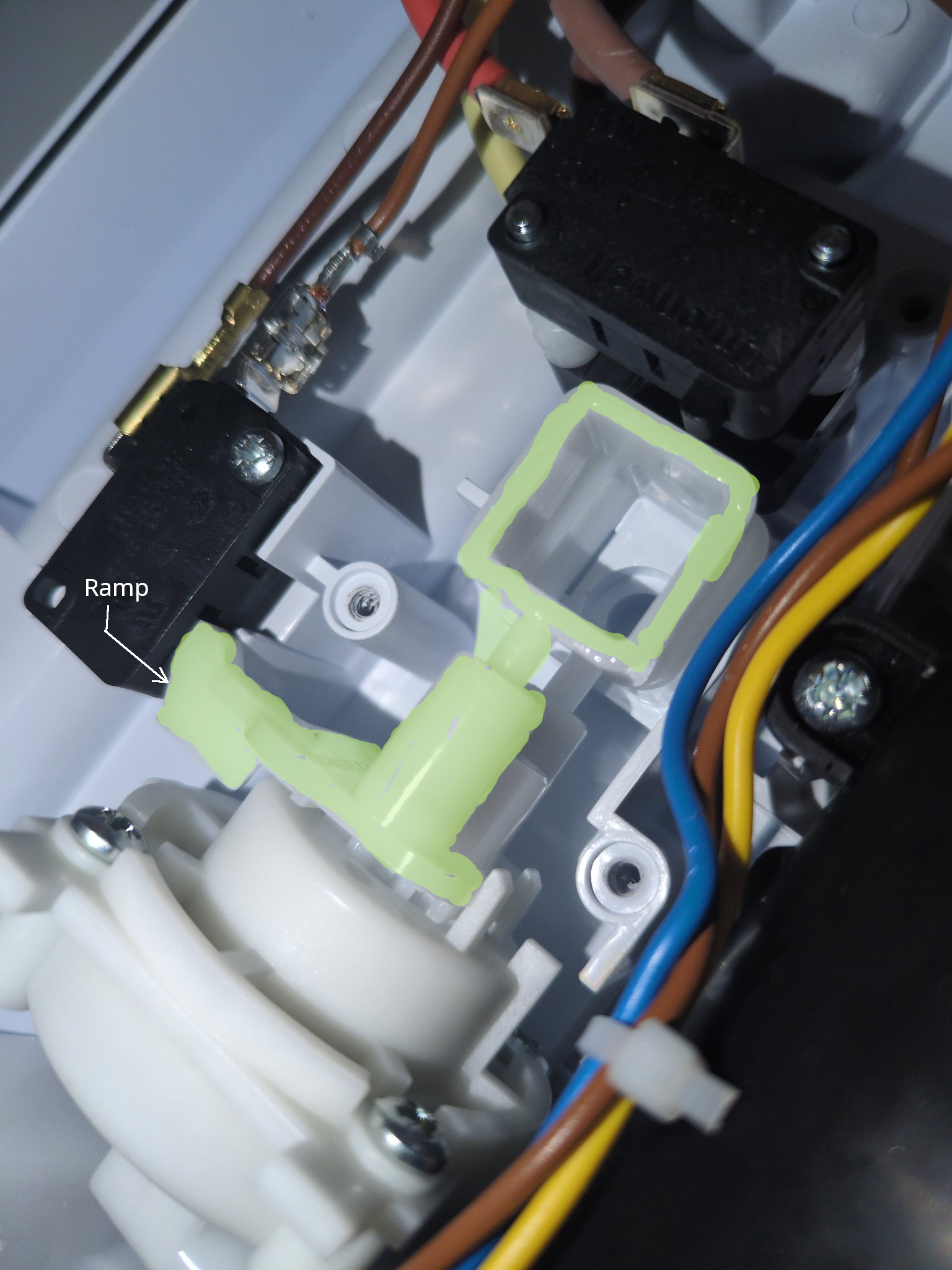

I cant figure out how the neon microswitch is operated,
The plastic moulding which moves up under diaphragm pressure (coloured pale yellow in the pic below) has a ramped part which presses on the button.
Thanks Alec_t, both photos seem to show that the ramp shape releases the button when the diaphragm rises ? so if the LP switch is NO then it opens and should have the same effect as removing the two wires which was done (with the switch in place) and the shower elements continued to heat, maybe the switch body acts as a guide for that plastic moulding and when its removed, the diaphragm doesn't move up sufficiently to close the microswitches, the test might show up something.
Under normal operation, while the element microswitches are closing, the Neon is still on which might indicate some mismatch/alignment.
Do you know/think that LP switch does more than just trigger the LP Neon?
