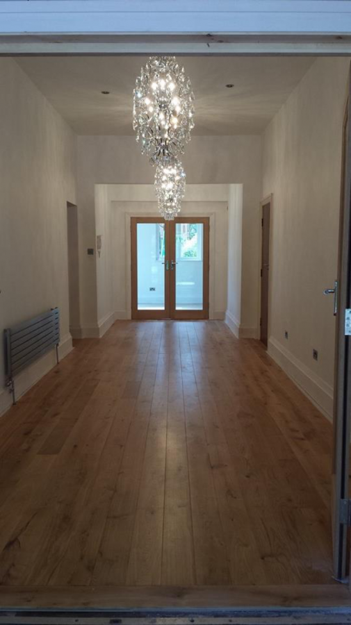

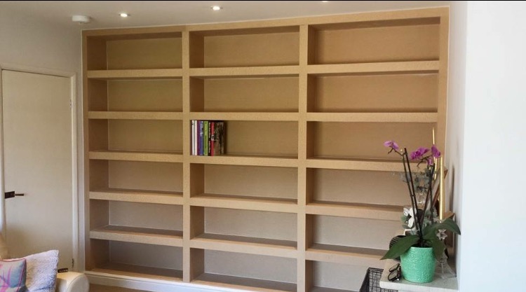

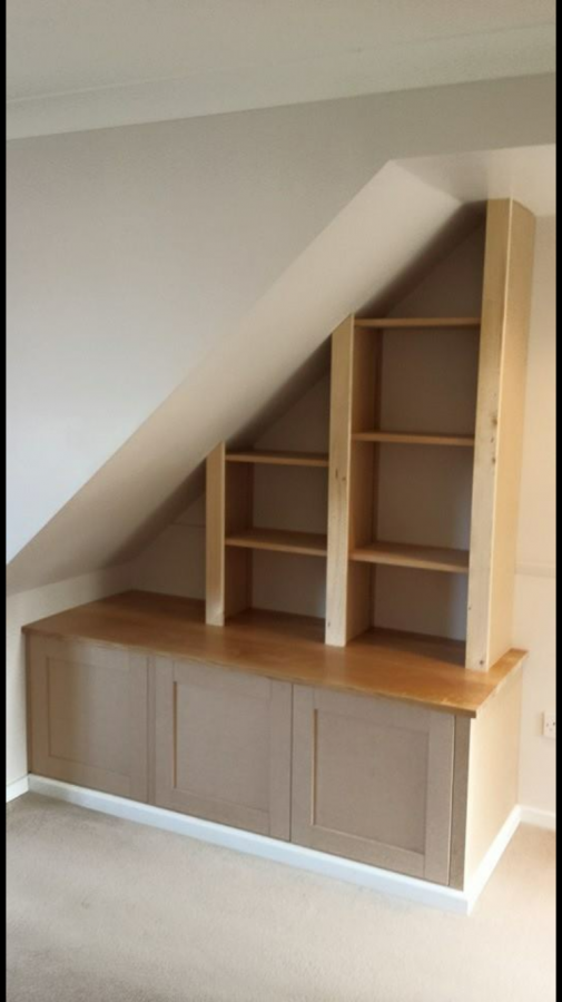

Other examples of his work from his Facebook page above, including one with skirting he replaced (last image).

Very hard to believe that is the same person. IMHO I think it would be easier and cheaper to remove and redo. Sorry it's a dog dinner.
They are all ready built units that have been fitted in place, but the I doubt if he did the work.

I don't believe those pictures are his work
Have you got a link to his facebook page
