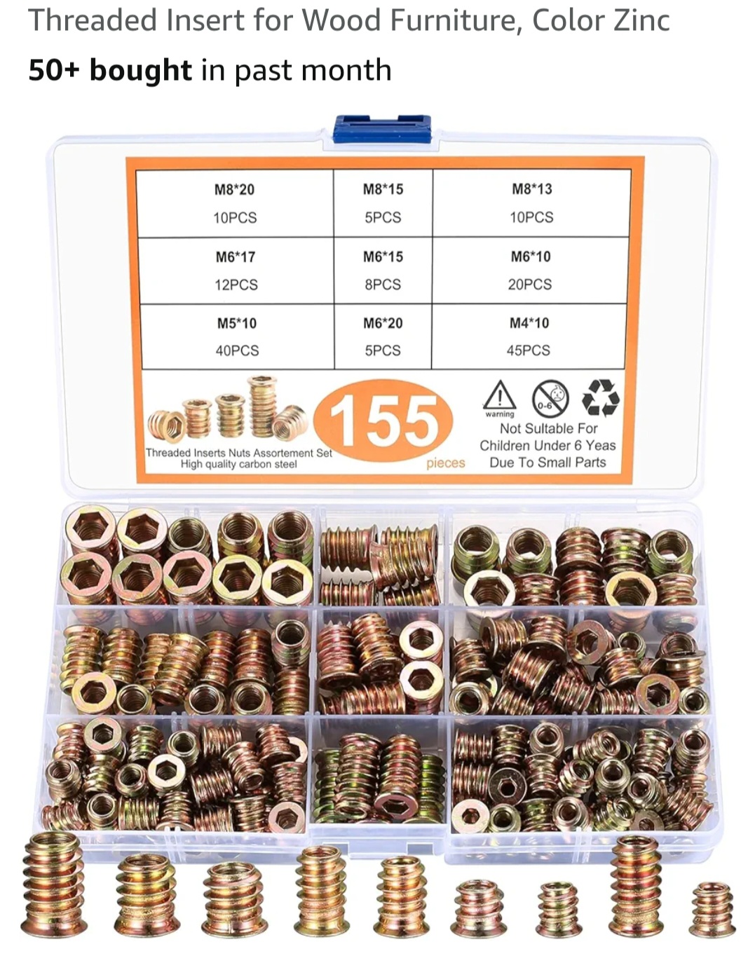

The diameter of a metric bolt is the outer diameter, including the threads. Ideally measure with callipers; if it says e.g. 5.9mm, that’s an M6 bolt. If you don’t have callipers, try to measure across the end with a ruler.

The thread on the pictures of the handle do not look like metric threads, too coarse.
Did you buy the handles online? It should say the thread size on the webpage.
Else you can always have a trip to your local hardware store and have a try at some other nuts etc.
Yes, from a UK based retailer. I suppose that doesn't necessarily mean the items were made in the UK though. The webpage doesn't have that information.
Threads on door knobs and handled are coarse and unlikely to fit any inserts . You could just drill a hole 1-2mm smaller than bolt and screw the handle on using the bolt (remove nut).Spot of adhesive as well to secure .

I thought of this but wasn't sure it would be secure. Which adhesive do you recommend?
