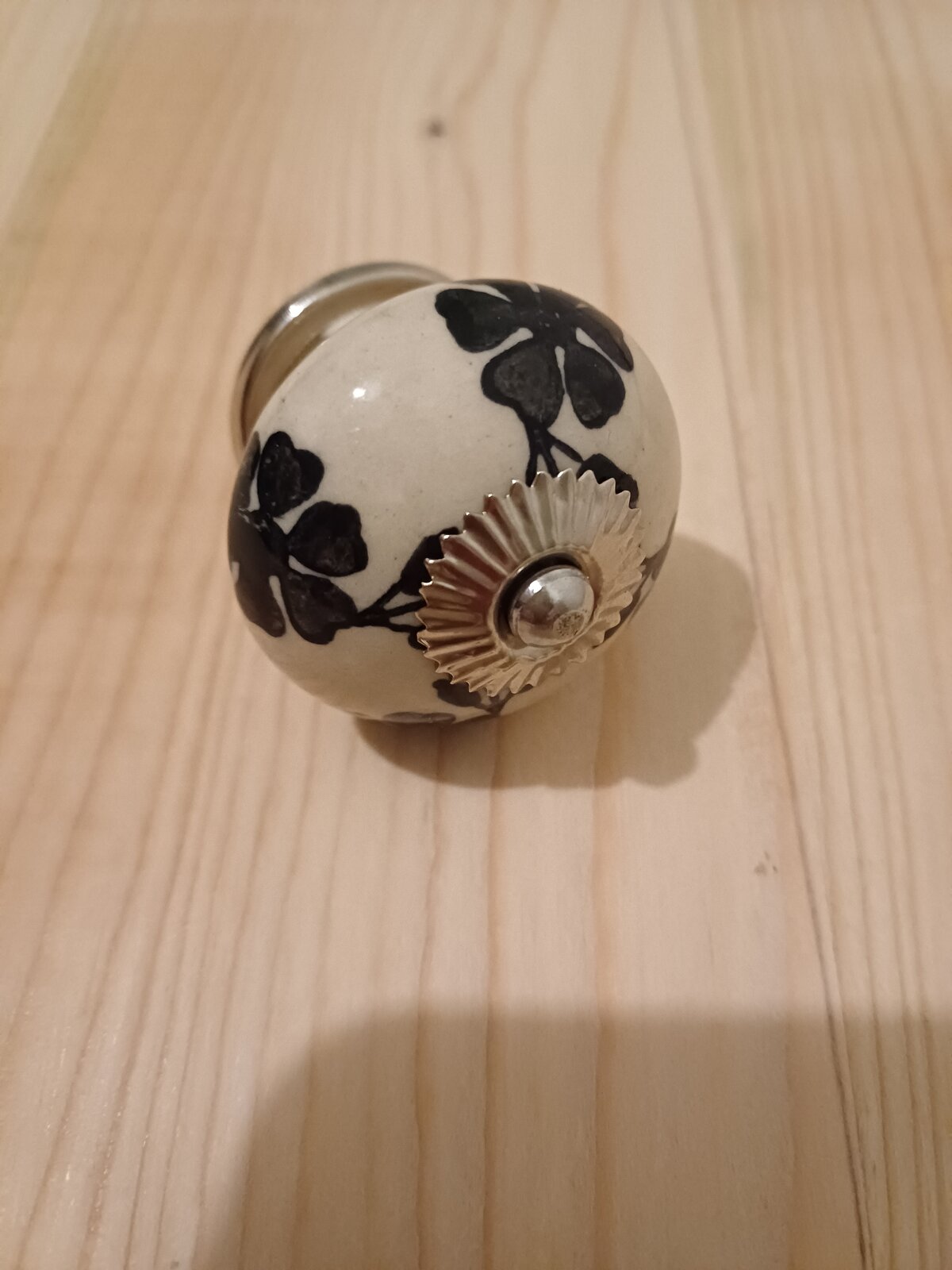

How do I go about finding the correct size inserts for these ceramic knobs? I want to attach them to a door to use as coat hangers.

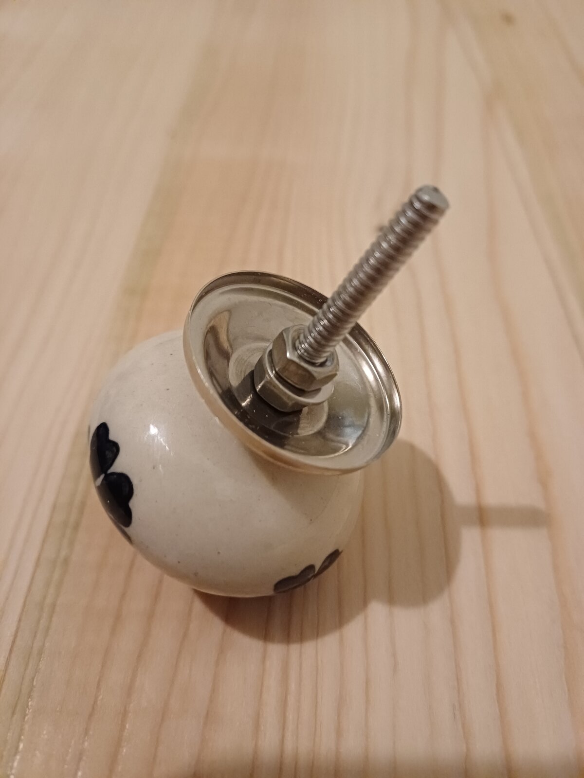

If the threaded bar unscrews from the knobs then you mark it with a pen before you unscrew. The pen reveals how far into the knob it was screwed. You but bolts that length plus the thickness of the material you will attach to. If you can't find exactly that length of bolt buy ~10mm longer, then cut the end off the bolt
If the threaded bars are fixed irremovably into the knobs, you drill a small hole in the surface on which you will mount the knobs, then partly drill from the back, a shallow, wider hole such that there is enough space inside the hole to get a washer and nut in and also the tips of some needle nosed pliers holding the nut while you screw it up, so that you end up with the nut attached to the threaded bar, at the bottom of a shallow, (say) 10mm wide hole.
If the surface on which you will mount these is soft (eg pine) you could also consider drilling this "not all the way though" hole very slightly smaller diameter than the diameter of the widest part of the nut, screw the nut onto the threaded bar about half way, push the whole assembly into the door from the back, then unscrew the knob so that you and up with a nut wedged into the wood, well aligned with the hole, then re-screw the knob in from the front

I can't drill from the other side because I want to attach them to a bedroom door.
OK. So really you’re asking how to measure the diameter of the bolt on the knob, right?
Length should be as long as possible without coming out the other side of the door. *What is the door construction?* This will not be very strong if it’s a typical eggbox door.
It's a Howdens white panelled certified fire door.
