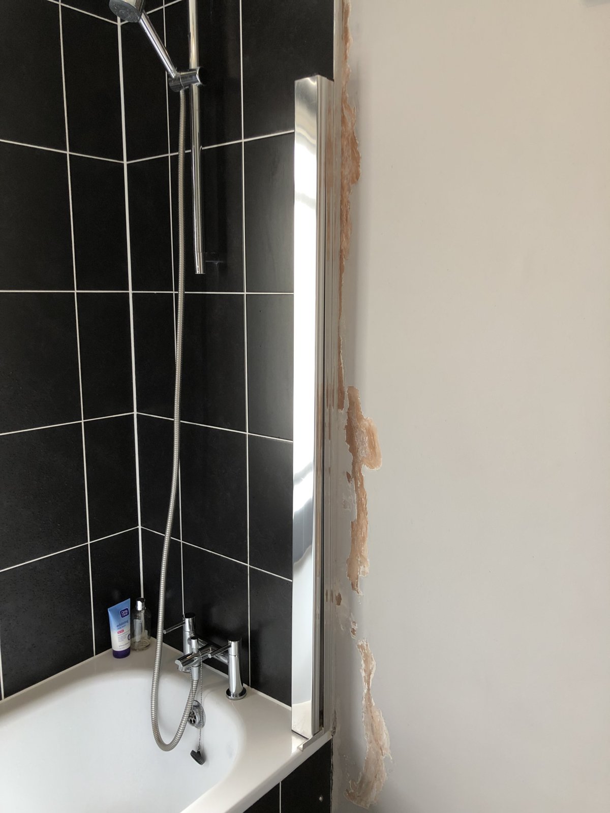

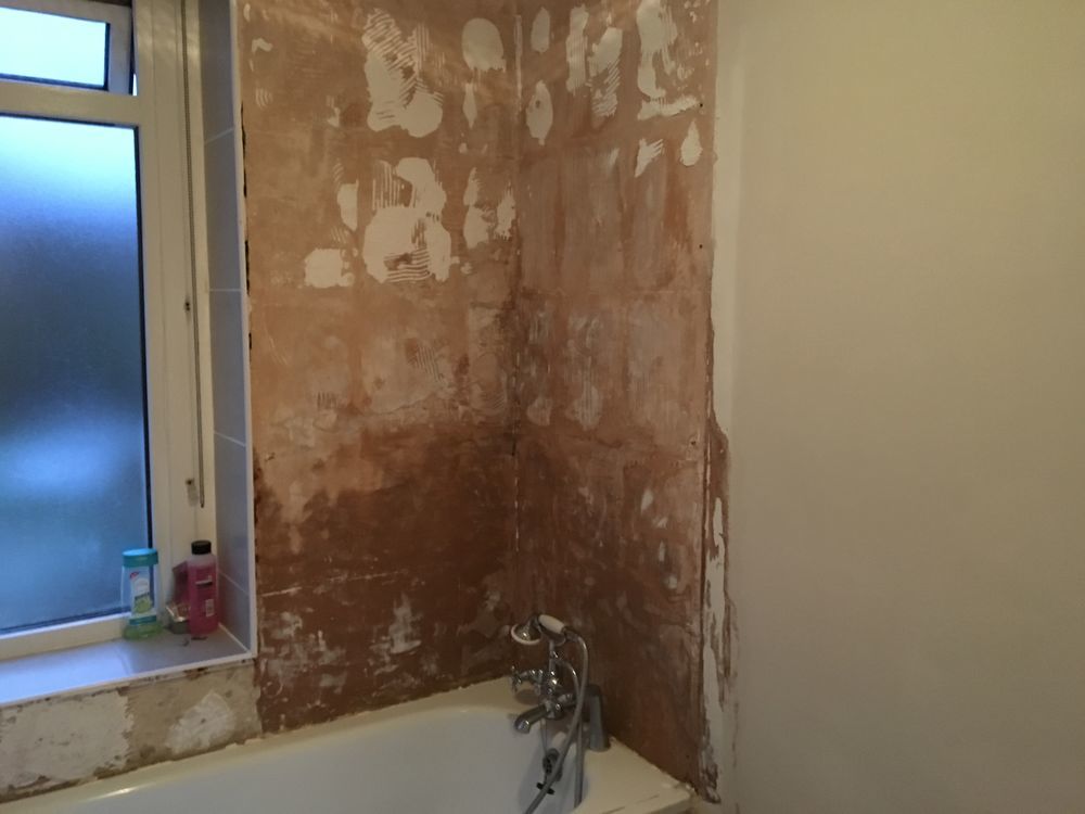

Please see pictures. I’ve included a photo of the original problem before tanking and now.
The original problem:

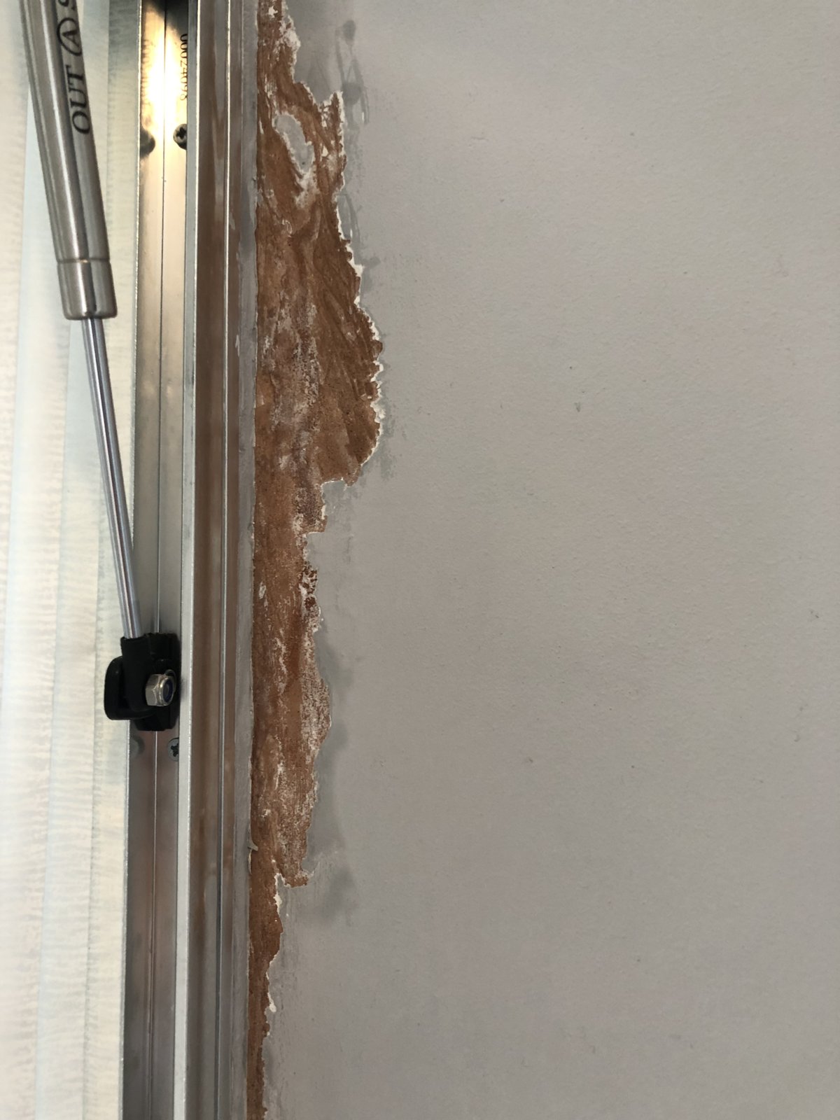

Now, a year later:
Looks like shower screen? (Or whatever that is) may not be correctly sealed at tile edge ?

the first pic may indicate water sitting on the bath edge and soaking into the plaster.
the later damage may be simply water splashing over the shower screen door / metal wall stop and running down.
