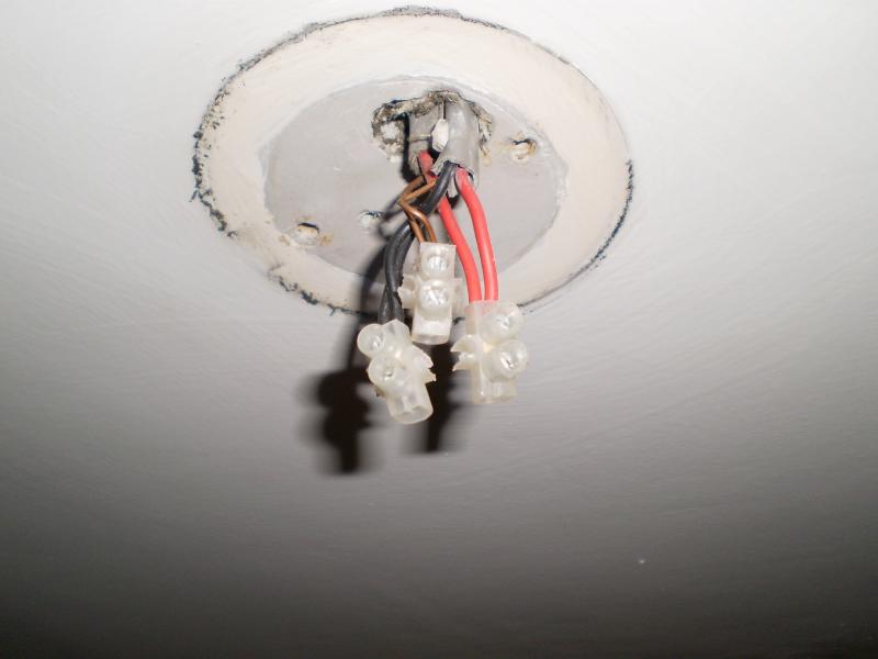

The 13mm ply arrived today so I started laying this in the kitchen. The boss asked me to have a look at a light fitting (very old fashioned) on the first floor landing that was not working and replace with a new one.
It was not working because the live and earth had become detached!!!!
This is what it detached from...
Why is your boss asking you check out light fittings when you are there to tile. Is he picking up further work on site for a few quid and getting you to sort out stuff not within your remit? Take Bas's advice and tell your boss you know ***k all about electrics as you will slowly get sucked into to bigger and bigger issues in the future.

He's paying me by the hour, so don't care what work he has me do/look at. Of course I will never touch gas or infringe Part P. Am fitting an outside tap next week.

I am self employed so don't really have a boss, the boss I referred to is the property owner who hired me. A previous poster seemed to think that I was working on a quote and accepting other work outside of the quote hence my reply that it did not matter how much extra work I was asked to look at or do, as I had negotiated an hourly rate.
I have stated that I am not a spark but I do consider myself competent enough to change a light fitting, a plug or replace a socket etc.
The wiring (photos uploaded) in the kitchen will be sorted next week by a spark hired by the property owner as suggested by me having taken advice from this site.
