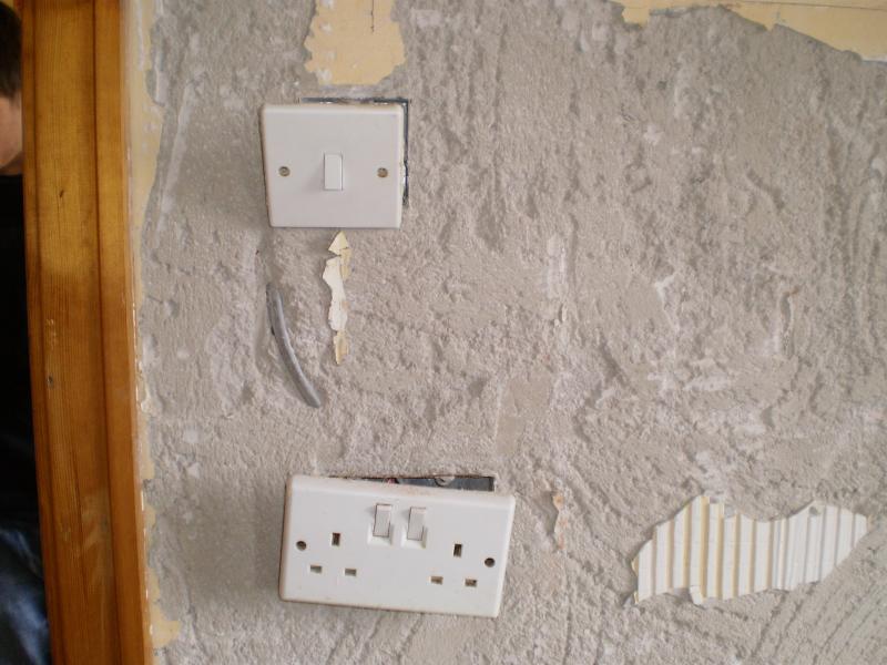

Started a job today that should keep me in work for a couple of weeks. I will be tiling the front entrance hallway through to the kitchen and then tiling the kitchen floor. Will also be fitting new kitchen cabinets and then tiling the walls.
This is a guest house that has just been purchased and the first new guests will be arriving on 19 April so have my work cut out.
When I removed the kitchen cabinets I then removed the tiles and found this.
OK so wires came out when I pulled the plate away, except this happened to four of eight sockets I removed.
I am not a spark but would like to know what the professionals think of what I have found so far and what the owners legal liabilities are.
:eek: Safe zones............
...and sadly, it doesn't look as if it would have been that difficult for someone with half an ounce of electrical knowledge to run that cable within the prescribed zones, even with the accessories in their current positions.

Might mean losing the job but cover your arse by telling the owners they NEED a Periodic Inspection Report doing by a qualified spark before you carry on with this part of the tiling.
If something happens at a later date and it transpires you knew about the wiring being 'dodgy' you may be held partly liable.
Golden rule: Cover your back!
