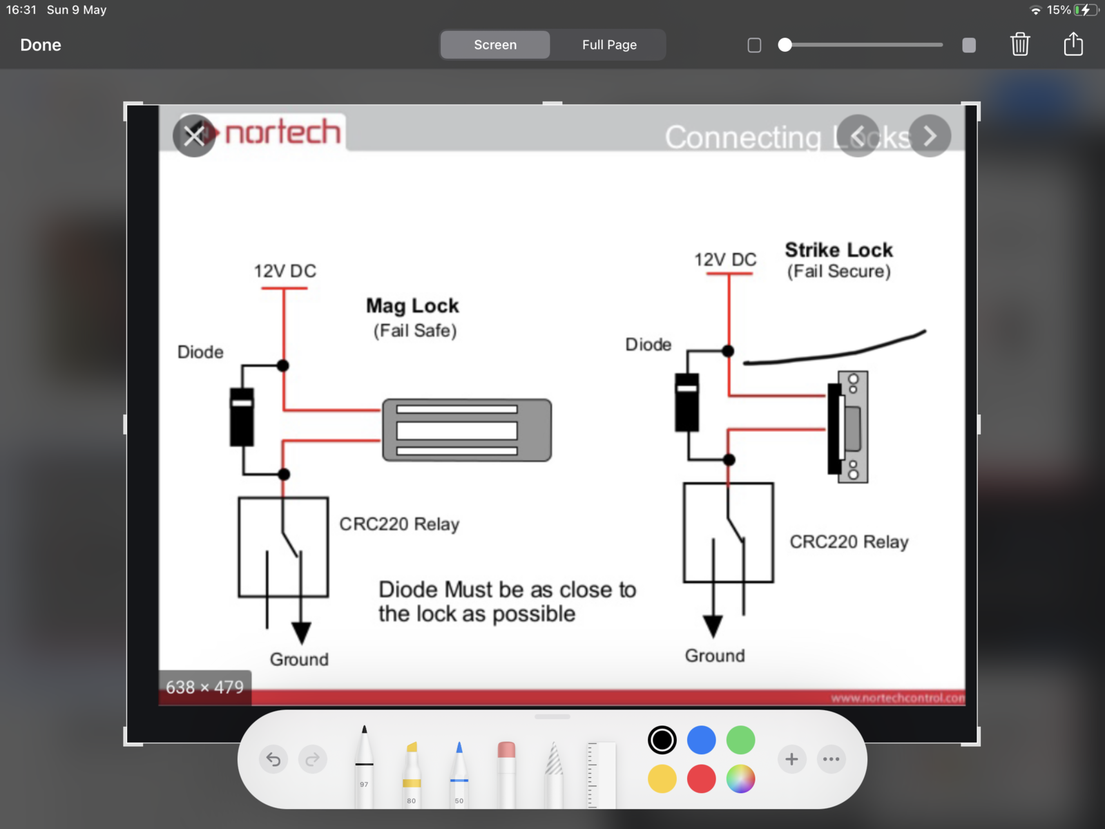

The correct location for a back EMF diode is not across the relays contacts. The correct location is as close as possible to the source of the back EMF which in this case is the coil in the lock mechanism.
Putting the diode across the relay contact will cause the EMF energy to pass through the power supply and this could be detrimental to the components in the power supply unit.
when the contact opens the back EMF from the inductor is of the opposite polarity (Hence the reason the the diode is fitted reverse biased) I've corrected your drawing such that the diode fitted across the contact can pass the back EMF current.
:D
...The drawing is incorrect. In this instance the switch is pointless as the diode is always forward biased. The original diagram was right for back EMF protection...
:unsure:
