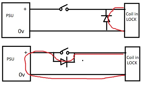

Sorry...yes put the diode across the coil as in the diagram.
When the relay contacts open the solenoid connection to the relay goes several hundred volts positive forward biasing the diode
The voltage only spikes to the extent needed to keep the current flowing.

when the contact opens the back EMF from the inductor is of the opposite polarity (Hence the reason the the diode is fitted reverse biased) I've corrected your drawing such that the diode fitted across the contact can pass the back EMF current.
:D
The drawing is incorrect. In this instance the switch is pointless as the diode is always forward biased. The original diagram was right for back EMF protection.
Indeed, so with the diode in place, the back EMF will not exceed much over one volt.

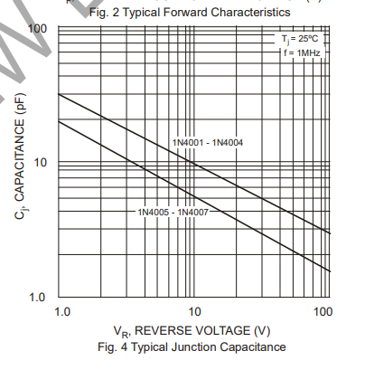

Can you give examples where a 1N4007 could not be used in place of a 1N4001, or 1N4004?
I must say that I was wondering that, too. As I said before, the operating characteristics for the entire range appear to be identical other than for the PIVs.
Where you care about the parasitic capacitance. The capacitance is usually quite different for a 1N4001 than a 1N4007, so you'll find a it starts to pass more and more high frequency content with no rectifying action.
First datasheet on google shows only with a test frequency of 1 MHz, but you get the idea.
That seems to be showing the capacitance for the 1N4007 to be lower than for the 1N4001.
