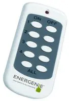

Yes in a way. I wanted the same, and I used Energenie, the remote Remote control.jpgwill work the socket without the internet, but to set the timer you need a hub and internet, but once set it does not need the internet. What I found was the down side it only has 3 timers, and I wanted 4, only way to get 4th was using IFTTT and internet.

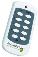

Yes in a way. I wanted the same, and I used Energenie, the remote View attachment 296469will work the socket without the internet, but to set the timer you need a hub and internet, but once set it does not need the internet. What I found was the down side it only has 3 timers, and I wanted 4, only way to get 4th was using IFTTT and internet.

The Energenie remote control with work with the wall sockets, light switches, socket strips, but not with the power monitor, the remote will switch them on/off, but to set timers you need the hub.

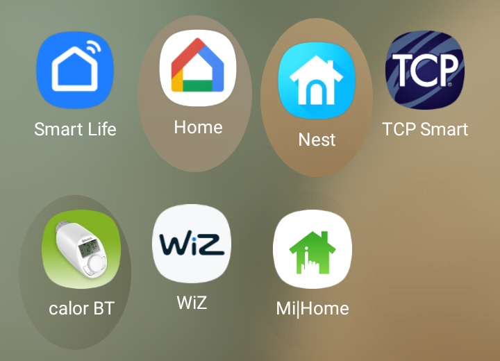

The phone is much slower than a remote control, but does work, also most will once set up migrate to Google Home, so what ever make you can have one app for all, but the extra features are only with the app you set it up with. Dust until dawn etc. So I have a selection House-Apps.jpg which is getting a pain. Getting google Nest Mini's to turn on/off with voice commands is easy enough, you need to be careful with names you assign to items, but getting it to turn items on/off as set times, or dim lights etc, not quite so easy to set up. We have no radio reception in the house and they were bought to listen to radio with, which they do well, however for other tasks they can be like mischievous little boys, however it has just done well spelling mischievous for me.
