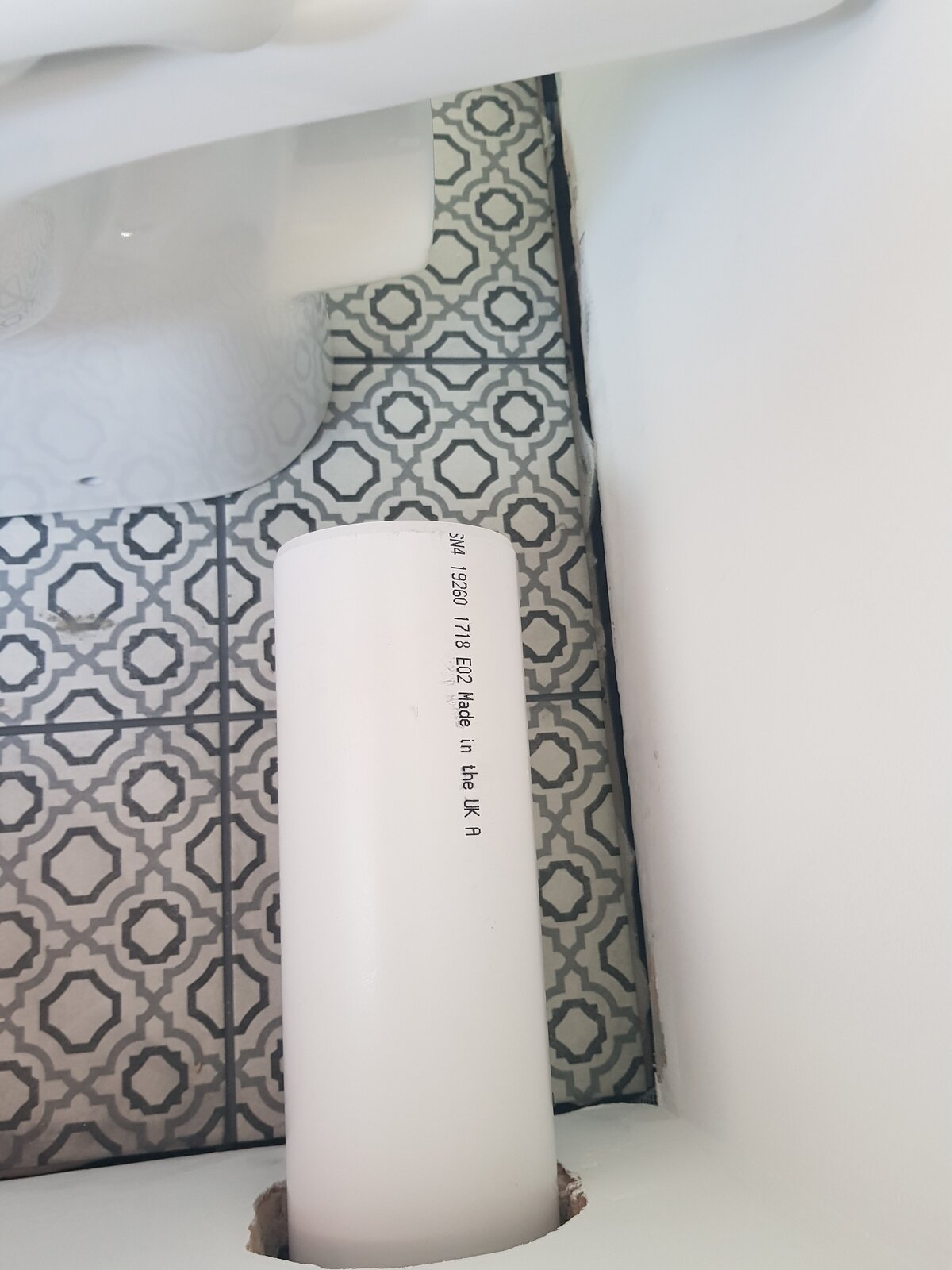

Toilet and soil pipe confusion...
As an alternative to the swan neck pan connector you could try a long 90° Flexi. that would give you a bit of wiggle room and be less restrictive than the swan neck one.
When I bought this pan connector I'm certain it said it could be used horizontally, but I just called Mcalpine and they said in the catalogue it says vertical only! Frustrating, although I guess with that bend it makes sense.
Do you think a Flexi will work here? As you can see from the photo it needs to bend around and come back on itself to meet the hole in the wall, which is why the one I liked to above seemed perfect. Ok and I just called Mcalpine again and they say their 90 degree Flexi needs to be used vertically as well!
I had such toilet issues before I want to make sure I don't have them again!
Any help appreciated
Hmm. The term 'sh#t out of luck' could sum up your current situation. Is there room back there for a standard pan connector ((you'd have to fit it then slide the bog onto it), then from pan connector to pipe one of those swivelling adjustable bends (i've used one in a similar problem, you can get about 30mm offset with them iirc). Failing that you're into a flexi from std pan connector to soil or a pair of 135s to give you as much offset as you need.
Whichever, you'll end up assembling the waste first & ramming the bog onto it. Have fun :)

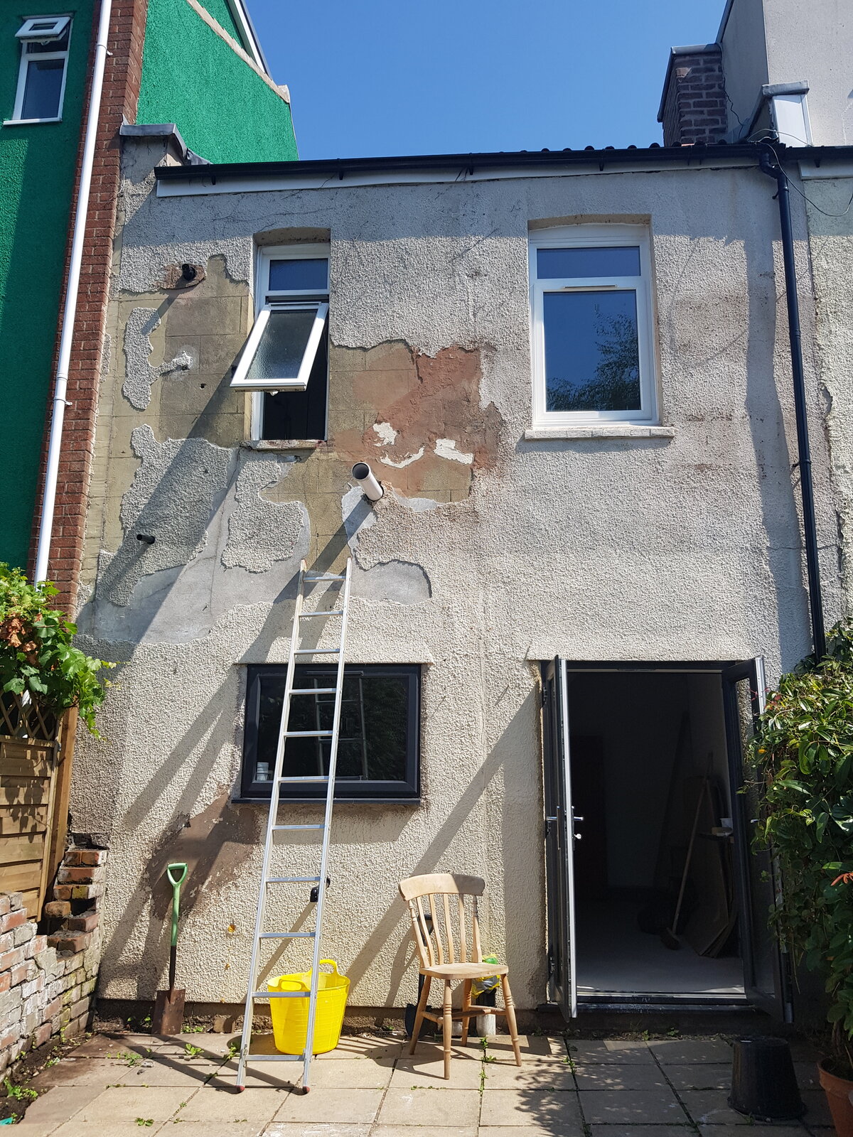

Yeah there's that, if the stack isn't going to be in the way (no sign of it in the pics)
Isn't that the base of the stack sealed with tape just off to the side. May be the angle of the photo but it doesn't look to be in line with the hole through the wall.
I spoke to Mcalpine technical staff, he confirmed the space saving pan connector can't be used horizontally because of the 'question mark' shape.
But he said it should be ok to use this or this
They are Flexis, but it may be my easiest option? He said the jubilee clip one can be cut in various places to make it shorter where it connects to the pan
I am not at the house now, but need to check what will actually fit behind the toilet and allow the cistern to be flush up against the wall
Yeah the soil pipe from the toilet will have to go sideways and down to reach the stack. That's how it was before. Otherwise it would go directly over my kitchen window!

That space saver looks like an invitation for a blockage. There will almost certainly be room behind the loo for std connector, move the hole in the wall & you'vegot a nice easy smooth run, v unlikely to block
Yes I just went to my local shop who are very helpful. They said just use this one
I dont know why I didnt buy that in the first place, its less than half the price of the space saving one. It might fit without having to widen the hole in the wall, but we'll see. At least its less likely to block!
