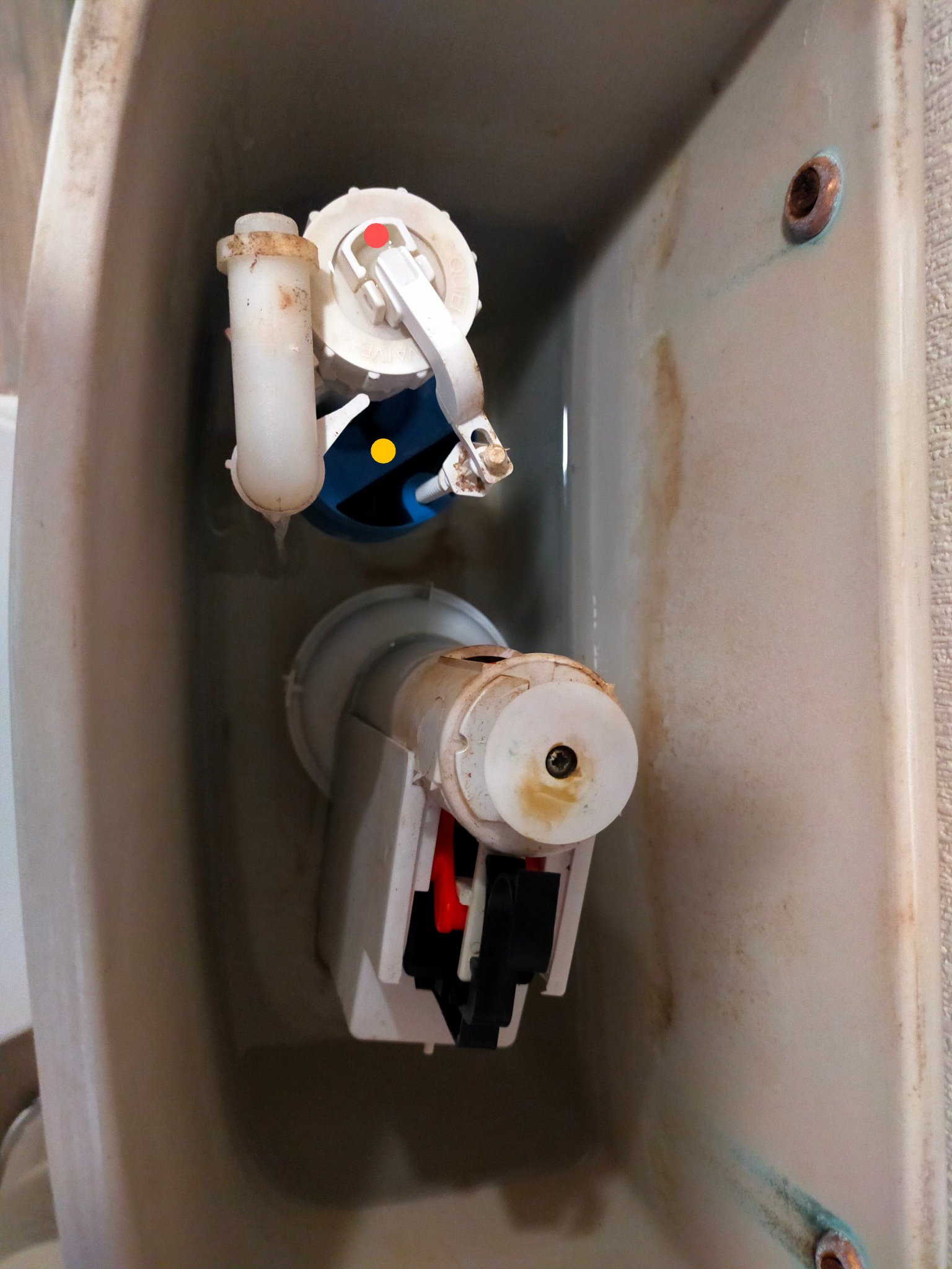

My toilet is constantly having water run from the cistern to the bowl, what could be causing that please, I've tried to add a video but the site wouldn't let me. Thanks
The water level is not high
If the water isn't overflowing then presumably the flush valve is leaking. Post a well-focussed pic of the inside of the cistern and someone here will likely recognise the flush valve brand and advise on its treatment/replacement.
The water is coming through where the orange dot is if I lift the float (yellow dot) it stops but within a minute or so it starts again, any advice appreciated.
Then it looks as though the fill valve is at fault and the water level rises until it reaches the overflow 'window' in the flush valve.
Thanks, is that easy to do, it do I have to take the close coupled bit of the toilet off to do it,
To replace the fill valve you would need access to the underside of the cistern, unless the valve is a type which enables the in-cistern part to be removed by some twist-and-lift mechanism (which I doubt; but I'm no plumber and I'm not familiar with the fill valve type shown).

Not usually, but it depends on the design of the pan. A photo of the bottom of the fill valve on the underside of the cistern would reveal all.
