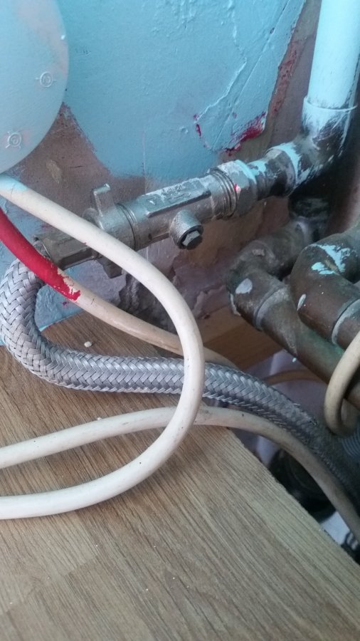

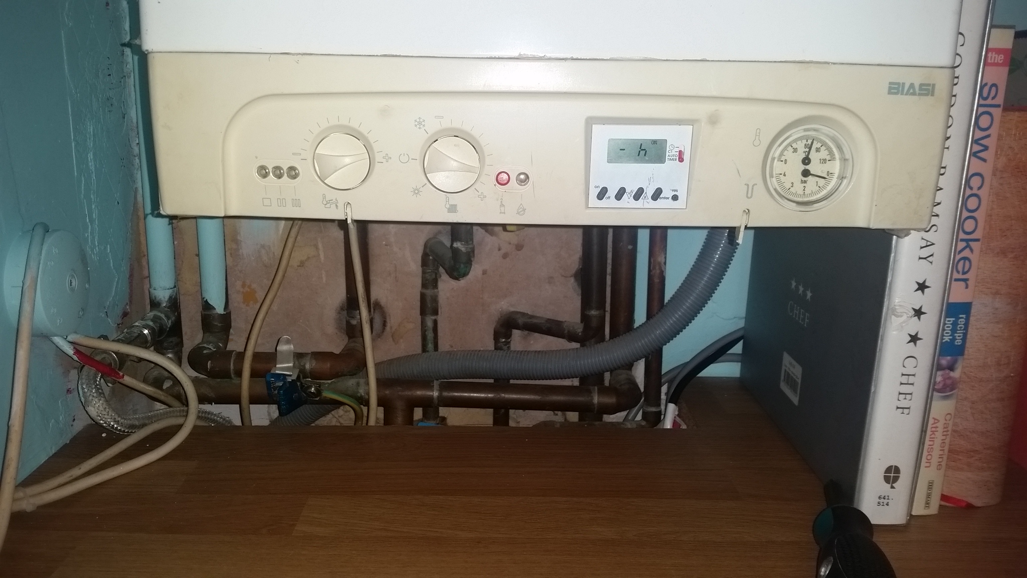

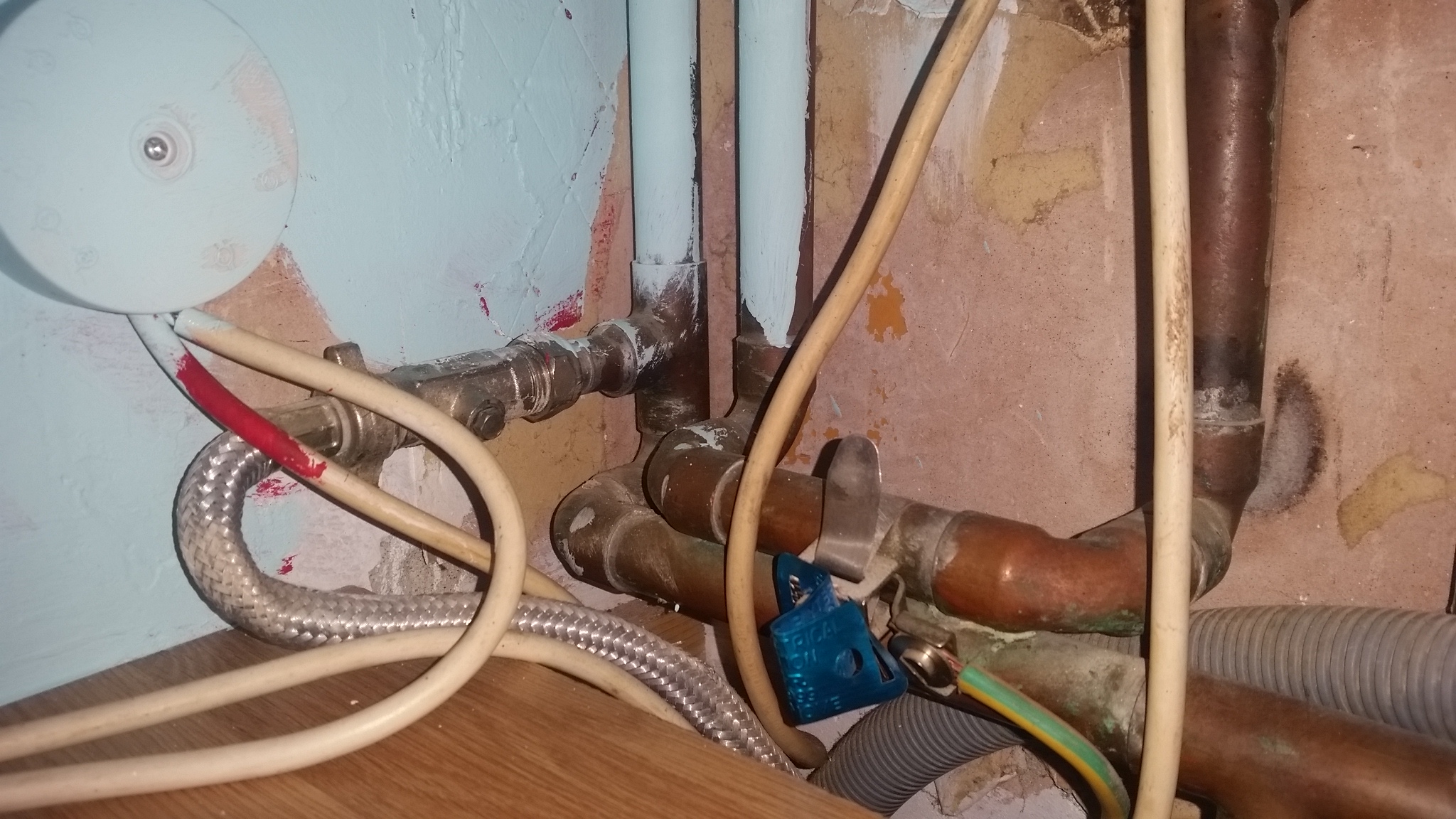

Hi guys, wondering if you could help. Our boiler pressure is at about 0.5/0.4 and is in need off topping up. Problem is I can't figure out how to top it up. Now about 3 years ago when we moved in the system was fully drained and I refilled then but for the life of me now I can't remember how I filled it. There's a filling loop which isn't in your typical location it's on some pipework much further down. So the the cold feed goes up and has an isolation valve from this the filling loop is connected. This travels up to a pipe on the left and looks like it feeds into a one way check valve (think this is correct name). So I opened up the isolation valve and nothing. So I think is it either a blocked isolation valve or is the check valve faulty. Or am I missing something really simple. Cheers for any help
Open the isolation valve and give the check valve a tap (gently) they can stick if not used in a while.
You are correct in thinking the braided hose is the filling loop the lower valve is the isolation one screwdriver slot across the pipe off and quarter turn leaving the screwdriver slot along the pipe is on.

Thanks for reply. Will try the tapping method in the morning. I guess I can just unscrew from check valve to check the iso valve is working...over a bucket of course. Yeah not exactly the most sound of installs is it. Thin will end up boxing this mess in till we can afford a new one
Sadly tapping didn't work. I tapped a few times then opened iso valve hear a rush of water then after a few seconds just went quiet and pressure never went up. So either it's the check valve or I guess I could have a faulty pressure gauge?
Is there a pipe dripping outside? You may have a blocked gauge and the boiler is over pressurised.

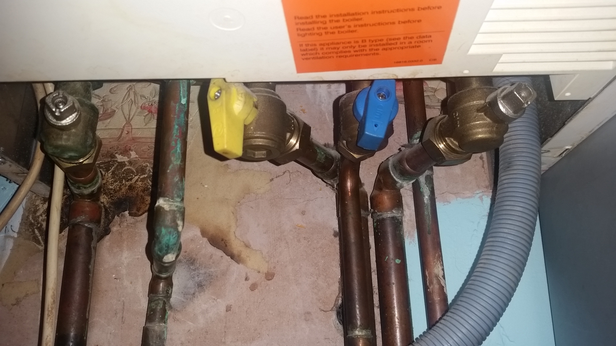

Had a quick look and the prv release pipe is dry, took me a sec to find it though as it wasn't at the back of the boiler but was at floor level on the left of boiler outside. So I think this is the faulty valve, what's the screw for? Guess it's a case of fully draining system changing valve and adding inhibitor again? Could I just drain from below boiler then I don't have to empty the whole system.

are you sure that both valves at each end of the filling loop are open
Both valves? I only have on iso valve the other is a one way check valve
Yep, drop the pressure out of the boiler and get a few rags round it. If you hear it start to gurgle then speed up.
don't be tempted to drop the pressure through the PRV though it will almost certainly leak for ever after that.
