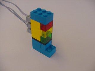

View media item 5046
If you dont want to go down the Mains voltage route then id suggest removing the lampholders and replacing with Leds and associated circuitry
