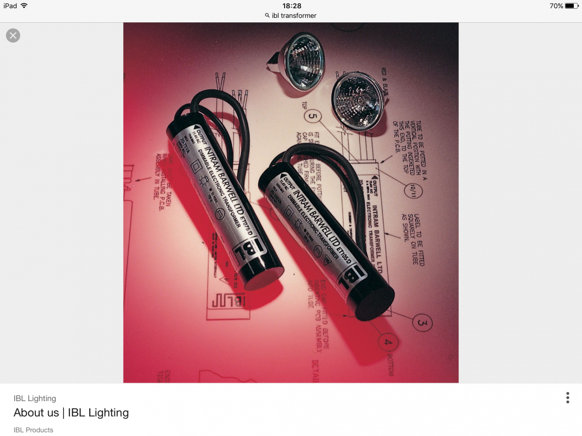

In the early 90's I fitted recessed lighting in my Ma's kitchen.
The transformers were grey and tubular, with both primary and secondary leads at one end. Newlec sold similar units under their name.
I thought it was IBL or IPL and London rings a bell.
Both those companies manufacture transformers but I cannot find these tubular transformers anywhere.
I was at Ma's place today, but cannot get up ladders so could not pull one down to look.
She wants to convert to LED's so I wanted to ask the mfr if their trannies were able to run them.
Can anybody help identify these please?
IBL are still going ....google them and view images

Some electronic transformers do run LEDs, but by no means all.
Wf were still selling them recently, but branded alto, they look the same and are likely made by IBL, though grey in colour.
I have only ever seen black IBL originals
Ibl were proberly the first makers of electronic trans with thermal and resettable protection, up to then most trans had replaceable fuses fitted, which were a pain to replace.
The type you have were known as cigar shape trans originally designed for 35mm downlight holes as opposed to Barrel trans which were fat and stumpy for the 50mm downlight holes
Theres a 50va and a 105 va version.
Ibl were all the rage in the early days and as you say were very reliable.
Though now they have changed to newlec and dropped Alto, not sure if wf still do them, but if neweys done them, then quite possible they still do.
The new ones have thicker output leads.
They may struggle with leds its a case of trying them
The 5ova has 20w min load and the 105va has a 35w min load.
