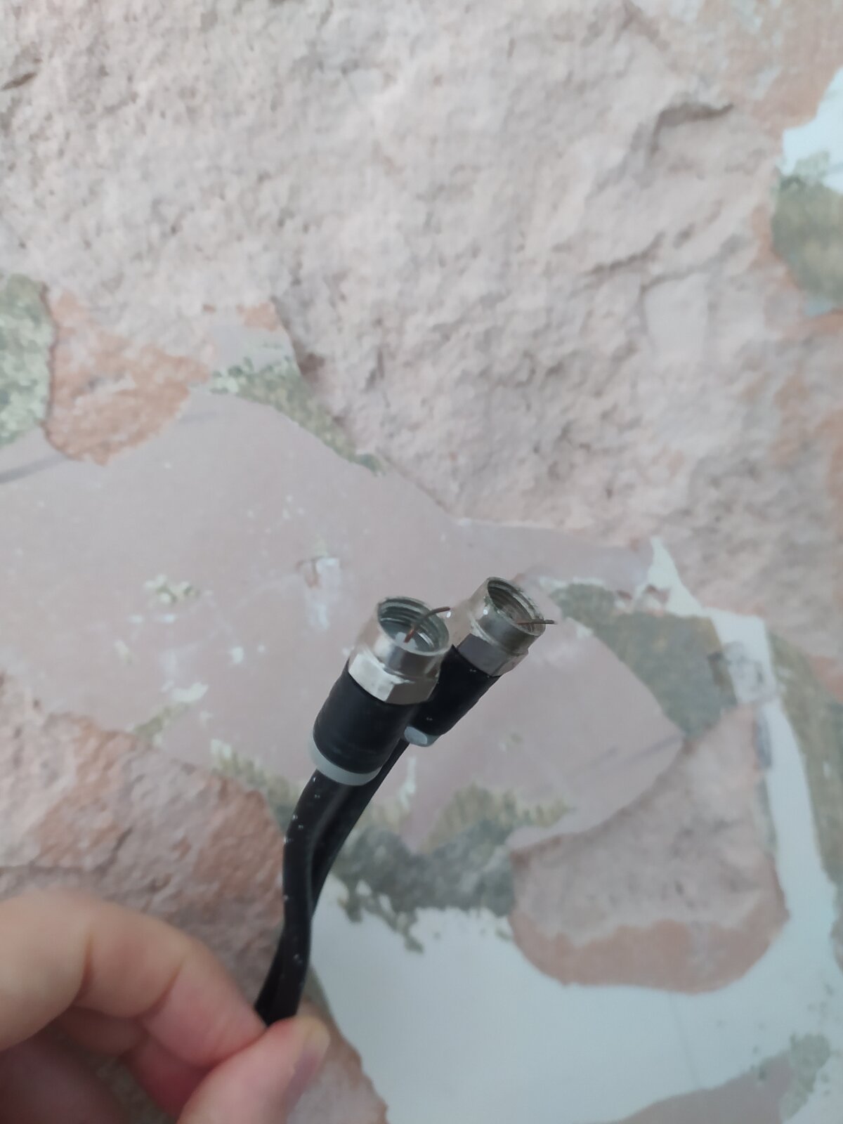

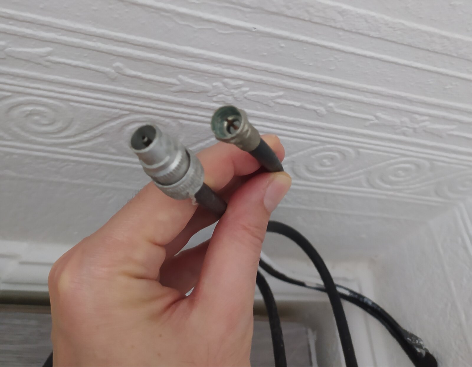

Hi guys, I am planning to have a wall mounted structure in the living room and there are two sets of TV cables coming through the wall...my plan is to extend them to the centre of the wall...but I am not sure if I need both...any help to understand better what these cables are for and if I need both???...thanks
See some photos below

The f plug (screw type) is cable tv or satellite.
The push sort is standard aerial on roof.

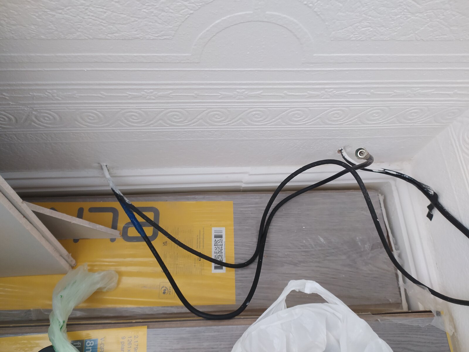

Hi Wayners, thanks for your reply.I just moved in a new house so there are ongoing works...so since I am planning to have the TV structure installed in the middle of the wall...I was wondering if I need any of those cables or not in the future ...in the first photo both cables I am holding come from the same hole...plus there is another hole where the other two cables coming out which you can see from the second photo
Moreover why there are so many cables coming through the wall ???do you have any idea???
Freeview is one
Cable another
Might have old satellite not used.
Then you might have one going out and to another room.

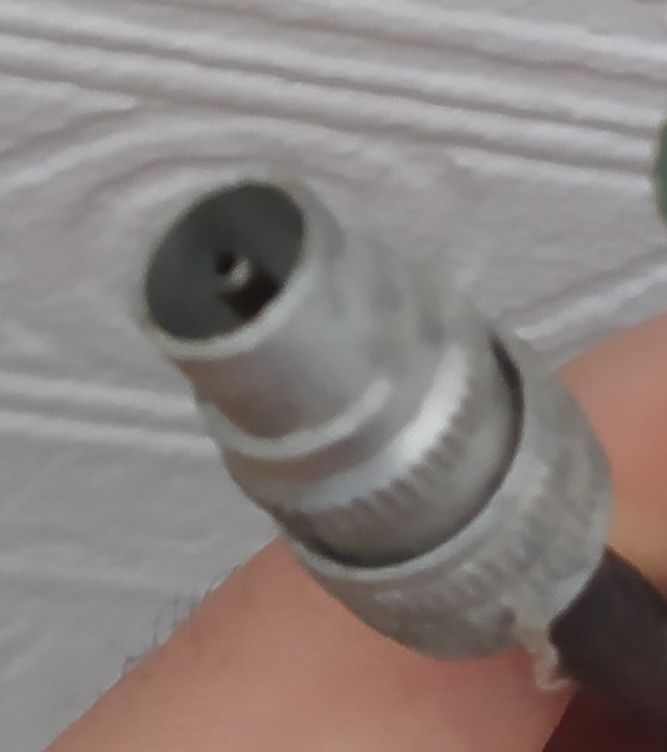

These two instead should be an old satellite

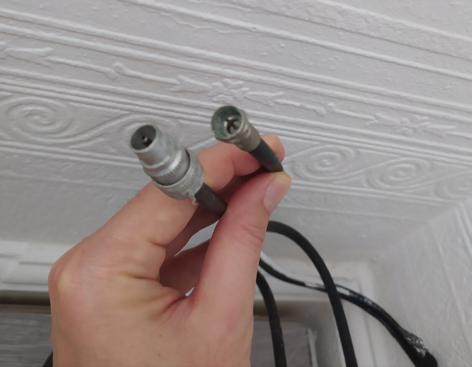

For Sky, Virgin or BT...do I need any of these cables eventually?

Your cables in image ending 702 are most likely professionally installed cables for a satellite dish feed.
The plug in image ending 809 is a standard TV coax plug, but that doesn't mean to say it's attached to a roof/loft aerial. With a back-to-back adapter, this could have connected to a socket on a Sky+/Sky+HD box to feed Sky over RF to another TV in a different part of the house.
The screw on (F-type) plug in image ending 825 is used for satellite or cable connections, but it's unlikely to be for Virgin cable. This is a screw-on fitting to the cable. Virgin's installers use compression plugs that are a permanent attachment like the Sky plug ends. This could be the connection for a masthead power supply for the TV aerial. It's common for homeowners to mistake this for a setback booster, so they take it with them when they move out.
The simplest thing to do is to go look see if you have a TV aerial on the property or in the loft. If there's a box attached to the mast or nearby in the loft then this could be a powered splitter. If so, it's possible that the single coax with the screw-on F plug is the TV aerial feed. You won't get a signal without replacing the 12V power supply and fitting a new coax lead from it to a TV.
Alternatively, your coax plug could be the TV aerial signal. Just get a telly in the room and plug it in. You won't break anything. Try tuning and see if you get reception.
If there's another room in the house with a TV coax appearing out of the wall, try the TV connection and tuning thing first. If you get a signal, great, you'll know that works. If there's nothing, then you could try shorting the centre pin to the outer ring, then take a small meter set to continuity and test whether either the coax or single F plug give you tone.
