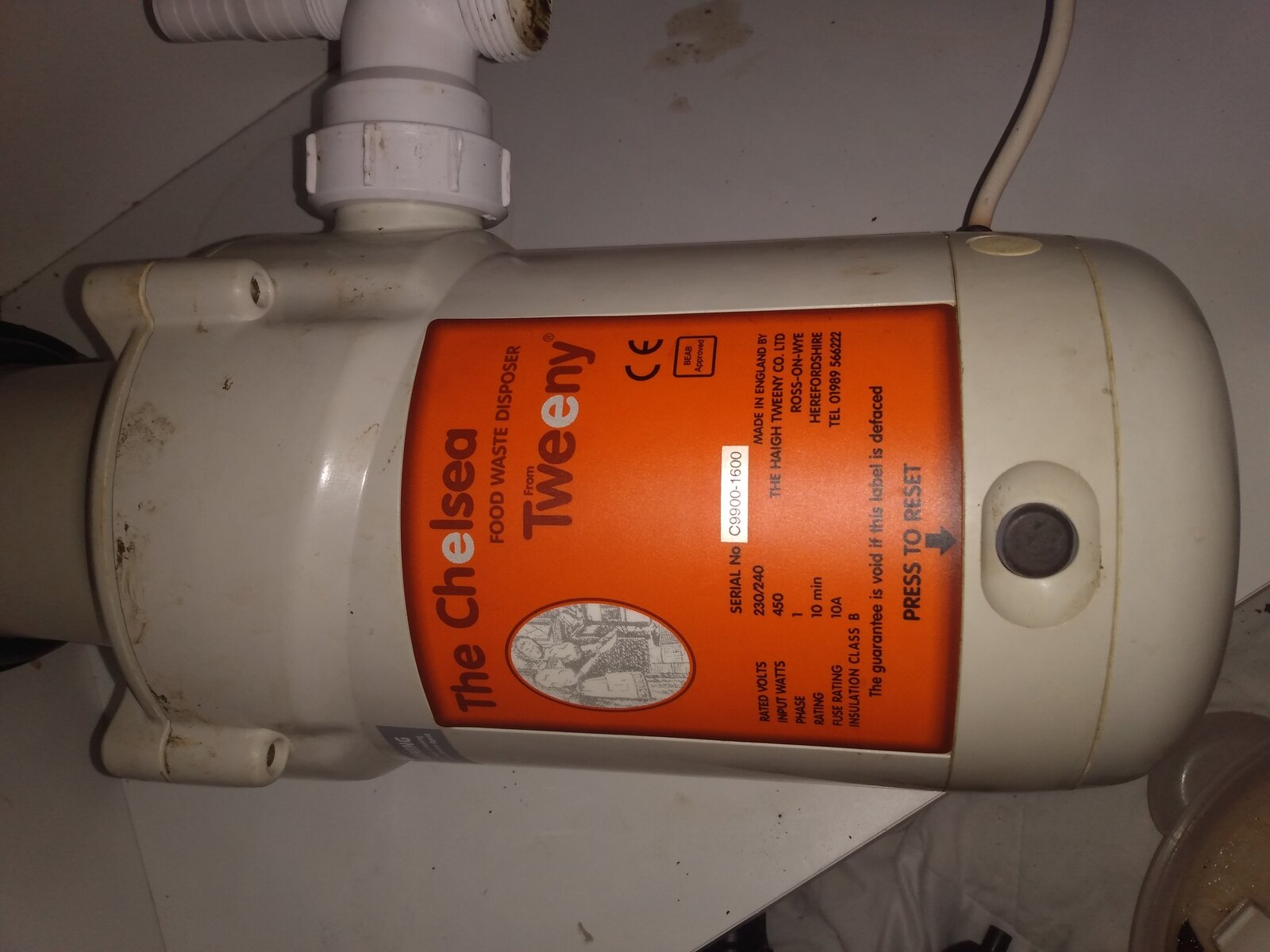

tweeny food disposers-reset button not working (Pic attached)
3 Jan 2010
51
hi
ive got the Tweeny Chelsea disposer and after removing some glass from the unit have turned it back on.nothing but a humming sound.
pressed the reset button,but no obvious click from the button,and unit wont come on again.
is there some trick to get the reset button to engage?
A
It’s probably jammed, turn off the electricity to it and use “something “ to turn the insides.
thanks . i was able to move the fins forwards and backwards to free them up.
