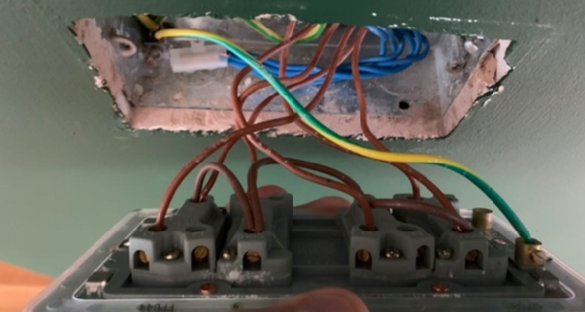

Take this picture from a recent thread:
How did we know which wire was what when we can see no switch markings.
How did we distinguish between the Loop in/out and the switched Lines - which is not required to be distinguished?
Was it only because they were Brown or Blue that we knew what was going on?
Had all the wires been White, would it have made any difference?
Obviously the installer has to know which is Neutral, Loop and Switched Lives, but once installed, I am saying that the conductors are then 'identified'.
As I told the poster of that picture, mark the wires before disconnection but that was only to distinguish between the Lines which is not required nor necessary for compliance with the regulations.
Take this picture from a recent thread: ... How did we know which wire was what when we can see no switch markings. How did we distinguish between the Loop in/out and the switched Lines - which is not required to be distinguished? Was it only because they were Brown or Blue that we knew what was going on?
Obviously not, but that picture presumably depicts a regs-compliant situation.
I remind you that we are talking about the regs (which require only that 'identification' distinguishes L and N), not about identifying the function of each conductor. If some of those browns were blue (with no other identification), your argument would presumably be much the same, but then it would not be regs-compliant.
