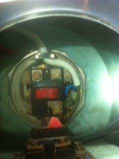

But,. if the cylinder is cold at the start of heating, either with the short or long element does it really matter how long, I mean short, the stat is since (IMO) the water is heated unifirmly from top to bottom, I'm pretty sure that my ancient immersion doesn't have a rod type stat in a dry pocket, its just a contact type on the top of the immersion, very like the hi limit stat on the modern immersions, marked item 6 in the attachment.
As I've said, although the water will be heated fairly "uniformly from top to bottom", the heated water will certainly not remain uniformly distributed "from top to bottom".
I realise it's only my personal observation/anecdote' but, as I've also said, if you start heating, 'from cold' a cylinder of water with a 'long' element, then, after, say, 30 minutes,there will be a very marked temp difference between top and bottom.
It must be at least 50 years since I first saw an immersion with a thermostat but I have to say that I don't recall having ever seen one in which the stat was not "a rod in a dry pocket" - but perhaps that's due to age-related memory failure :)

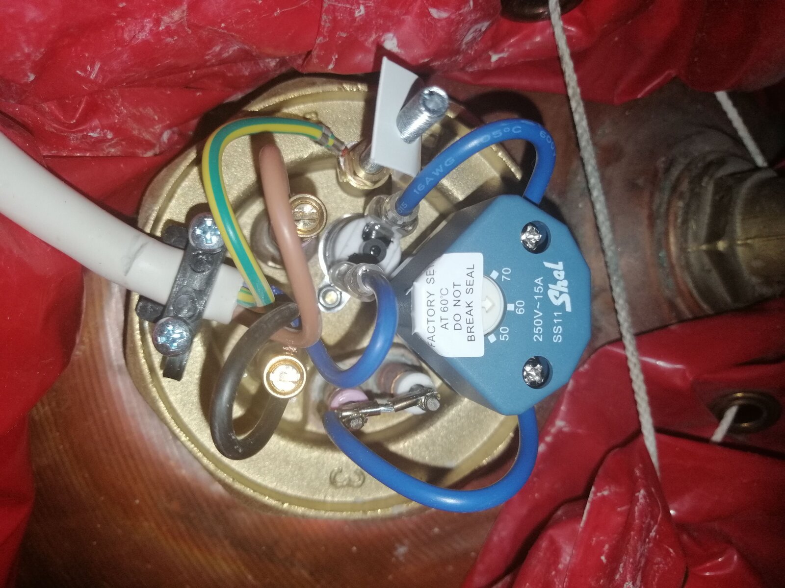

Here is a photo of mine, taken 11 years ago, with cover removed.
