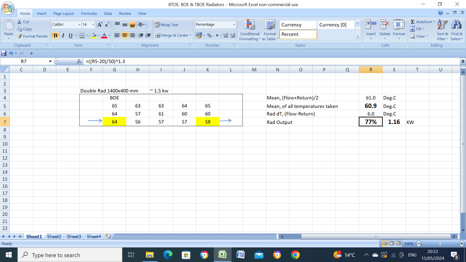

What do you have to say about my radiator analogy? There is no doubt that the hot water 'appears' at the bottom, but is it not your experience (as it is mine) the top very quickly gets hot whilst the bottom initially remains cold?
The radiator analogy is interesting, if you were to leave one valve shut on any rad until the boiler reaches full operating temperature and then open it, its uncanny, the hot water will rise up in the first say 4/6ins of the rad, it will then move along the top and reduce in temperature as it "falls" down through the rad.
Radiators have quite narrow passages, water enters at the base, then rises up to the top, via the nearest passage to the entry. From the top, the hot water then spreads/pushes its way down.
An HW cylinder is much, wider, more space for the heated water to mix with the cold, as it rises.
