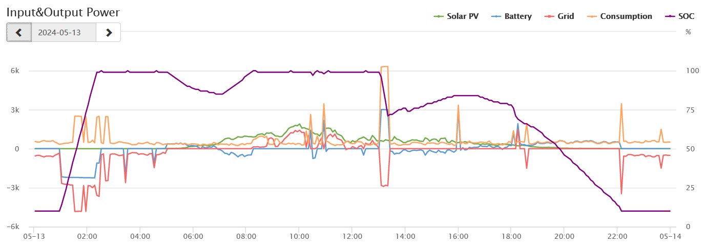

I look at my energy use 1715719975427.png and it changes every day, but my tariff is so much cheaper midnight to 5 am to 5 am to midnight even with the solar, it is better to run dish washer, tumble drier, washing machine etc in that cheap rate. As I don't know what solar I will get from day to day.
So I just use the delay timers built into the machines, in the days of hot and cold fill it may have been worth heating water over night, but now I am not sure worth the effort?

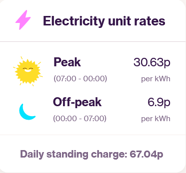

My off peak is an EV tariff, there is also Economy 7 and Economy 10 and even a variable tariff depending on demand, we hear Octopus prices being quoted many times, each results in a different off peak charge. Plus it changes area to area and supplier to supplier a quick hunt for this address got 1715755534164.pngbut for me to change I have an exit charge, and they fail to say what the solar rate is, and one in the main gets a higher payment for solar if you sell to same company you buy from. Also times vary even for same tariff, so for me in mid Wales to say what is the cheapest way to heat water, may not be valid in where @Ch_152 lives.

Calculated, crudely, on running the element for an extra hour a day, at daytime E7 rates (~30p) comes out at around £300 a year. So sounds like a significant saving.
