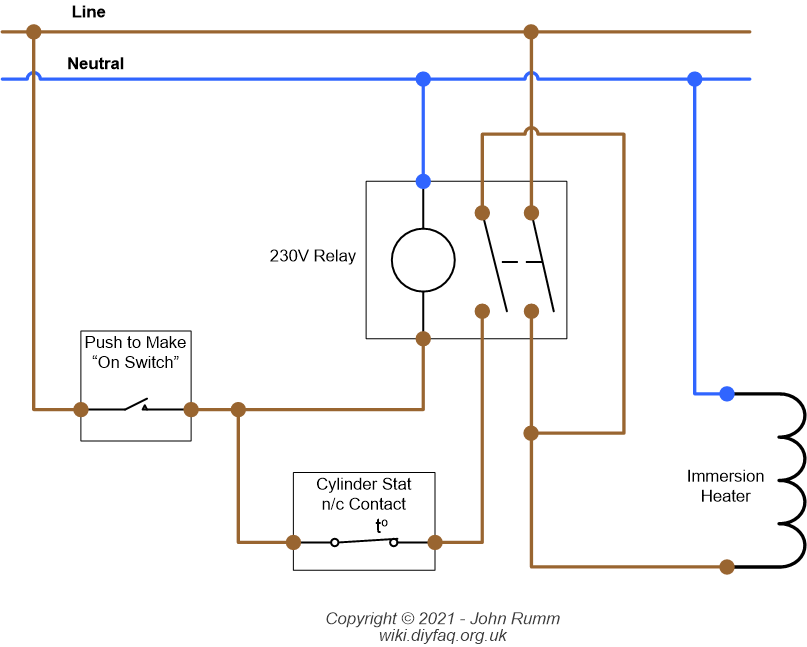

Just as an aside , if you are still going with two elements of some kind, plumbers merchants around here quite a few years back, use to stock a "one shot switch", such an item switch the supply for the heater L on dependant upon whether the stat was calling and you pressed the button, once the stat was satisfied then it switched off and stayed off until the button was pressed again, otherwise it stayed off.
With a bog standard immersion heater that meant disconnecting the stat terminals from the heater and wiring thru this one shot switch, if I remember correctly it created an extra terminal to monitor the stat output and the relay would latch via the button and remain latched until stat drops out. Basically it interrupted the stat and used to to energise the relay coil via the push button, once the stat was happy it threw the latch open. I remember there was a capacitor in the circuit to assist in the initial button push. I have not seen them for years, it might have been one manufacturer made them or even independently manufacturer locally. I just remember they were popular amongst plumbers.
If you have the knowledge to make one safely then you might also have the knowledge to make it apply in your own situation with only one of two elements .
It had no electronics, about as simple as this :- (from Wikipedia)
Very interesting, I can see the use for that. Definitely above my pay grade to build and implement though!

.... plumbers merchants around here quite a few years back, use to stock a "one shot switch", such an item switch the supply for the heater L on dependant upon whether the stat was calling and you pressed the button, once the stat was satisfied then it switched off and stayed off until the button was pressed again, otherwise it stayed off.
Interesting. That functionality might suit some users, but only if they only required the amount of hot water heated by the top element (until it's 'stat switched it off) and were happy for the water reverting to being cold thereafter.
