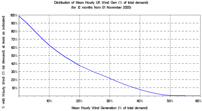

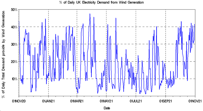

... I wonder what a graph of "wind output as a % of total demand" would look like ?
That should be fairly straightforward - and, as you imply, could potentially be quite interesting. Watch this space!
I hope you've been paying attention and 'watching the space' :-) Done in haste, between other tasks, but I think it's roughly right and adequate for starters - see 4 more graphs below (plus a fifth one, for good measure :-) ) ...
As before, everything relates to the last 12 months up to today. The first graph is analogous to those I showed before, in that it is based on daily averages (without any smoothing), and shows the 'wind output' as a percentage of total demand for each day. There are thus about 365 data points (days) plotted on that graph.

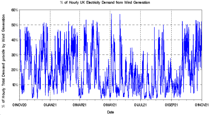

To partially satisfy your concerns about the way in which daily data (particularly if 'smoothed') obscures short-term effects, the second graph is similar to the first, but based on hourly averages. There are thus about 8760 (365 x 24) data points on the graph (not that one would know it!). Going down to intervals shorter than one hour doesn't really add anything (apart from mess!).
Contrary to what you may have been expecting the second graph is not conceptually much different from the first, which indicates that the predominant variation is day-to-day or slower, rather than more rapidly (e.g. hour-to-hour) - which is what I really expected to see.
Over the entire year, total demand was about 258 TWh (258,000 GWh). At about 47 TWh, wind output satisfied just over 18% of that total demand - which, as I just wrote to SUNRAY, I don't think can be sneezed at, and undoubtedly will increase before long.

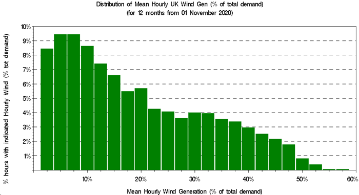

The third and fourth graphs are of the distribution of hourly wind output as % of total demand, and are analogous to the ones I posted yesterday for actual (absolute) daily wind output. The hourly wind output varied from 0.2% to 57.3% of total demand during the hour, with a median of 15.7%. In other words, wind provided more than 15.7% of total demand during half of the 1-hour periods during the year.

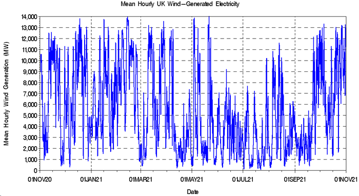

For completeness, the fifth graph below is like yesterday's first one (actual absolute wind output) but for each hour during the year, rather than each day on yesterday's graph. As with the "% of demand" graphs discussed above, the graph of hourly data is not conceptually different from the graph of daily data - again imply that the predominant variability is day-to-day or slower, rather than shorty-term changes 'within days'.
