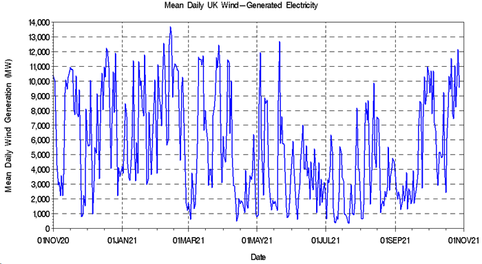

See the four graphs below - which are based on gridwatch data (data every 5 minutes) for the 12 month period starting on 1st November 2020.
The first graph shows the mean amount of wind generation (mean of all 288 5-min data for the day) each day.

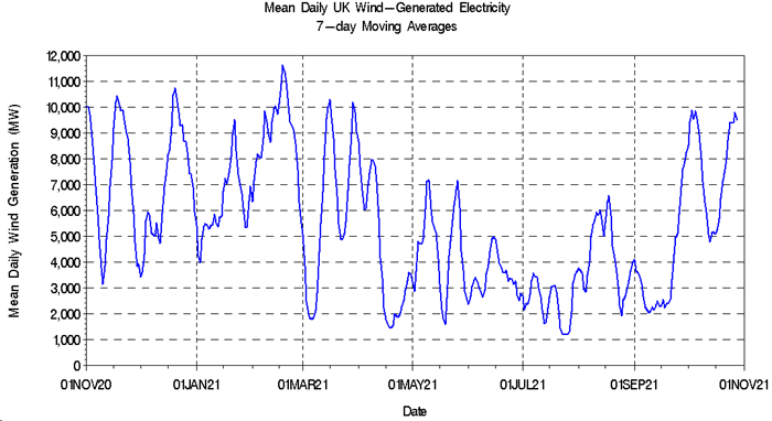

The second graph is the same as the first, but smoothed (by means of a 7-day moving average) to get rid of some of the day-to-day variation and hence make it a little easier to 'read'. Note, however, that 'smoothing out the day-to-day variation' is potentially misleading because it will tend, for example, to 'conceal' short (e.g. a day or two) periods of little (or no!) wind generation. However, it can be seen from the first graph (and the two which follow) that there were no days on which there was no wind generation, very few on which the average was <1 GW and not many on which it was <2 GW (about 7% of average total daily demand).
One bit of my intuition which seems to have been correct is that wind generation has been considerably (and 'obviously') greater during the cooler months (November-April), when electricity demand is likely to be greater, than during the warmer months (May - October).

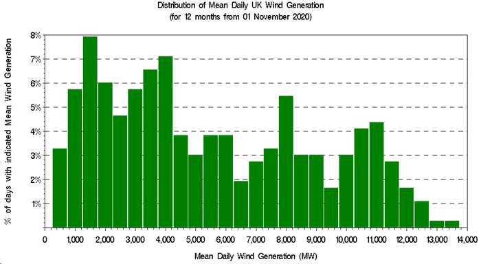

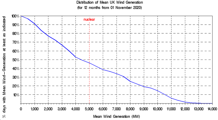

The third and fourth graphs show the distribution of the 'average wind-generated GW during a day' during the 12-month period considered - i.e. the percentage of days on which the mean wind generation was a certain figure (third graph) or above a certain figure (fourth graph).
These graphs show that on nearly half (about 45%) of the days, wind generation was greater than nuclear (essentially fixed at ~5 GW), in some cases considerably greater - more than double nuclear on about 15% of days.
Even the first graph is hiding detail. It would be interesting to see a distribution of "rate of change of output", or perhaps "change of X GW in less than Y hours" with un-smoothed data - when I've looked at the short term graphs (before BMReports did it's facelift and made things a lot harder to see), there were some massive swings in output which would be significantly reduced once averaging out data to fit days or weeks onto a graph.

The first things I note on that are :
The number of massive power changes over short times - there are several times when output changes between something like 100% of maximum "real" output, and 10%, over only a day or two. Just take a moment to think about that, that's a change from 10% to 100%, or from 100% to 10%, over only a day or two. So "something else" has to ramp down or up to cover 90% of your capacity, or in the order of 10GW, over a short time scale. And that's with the data averaged so in detail there will probably be even more significant swings.
I also note that there are a lot of days with low output. Yes, it's easy to say there were no days with zero output, but from a users' PoV, if the industry told users "you can only use 5% of your normal load today" then that wouldn't be very useful :rolleyes: I can see quite a few days where output, in terms of mean or max, is "quite low" - low enough that in the absence of "something else" to fill the gap would mean lights going out across the UK.
And again, I can pick out some interesting stats from these :
Some 10% of the time, UK windmills produced less than 1GW. And about 15% of the time, they produced over 10GW. That's a massive variation in output which "something else" has to cover. And we need to consider what else is going on. In summer it represent a much greater change (as a % of supply/demand) than in winter. I wonder what a graph of "wind output as a % of total demand" would look like ?

And looking at teh first graph, early Dec 20, and late Jan 21 appear to show periods of "several days" with significantly reduced output - and I'm guessing significantly increased demand due to heating loads.

Even the first graph is hiding detail....
I think we are looking at this in different ways.
Most of your comments relate to the variability in wind, hence wind generation, hence the fact that one cannot rely upon it, and therefore has to have enough 'other generation capacity' ("something else") to entirely replace wind generation (even at times of high demand) should it fall to, or close to zero for periods of time. I have acknowledged that.
